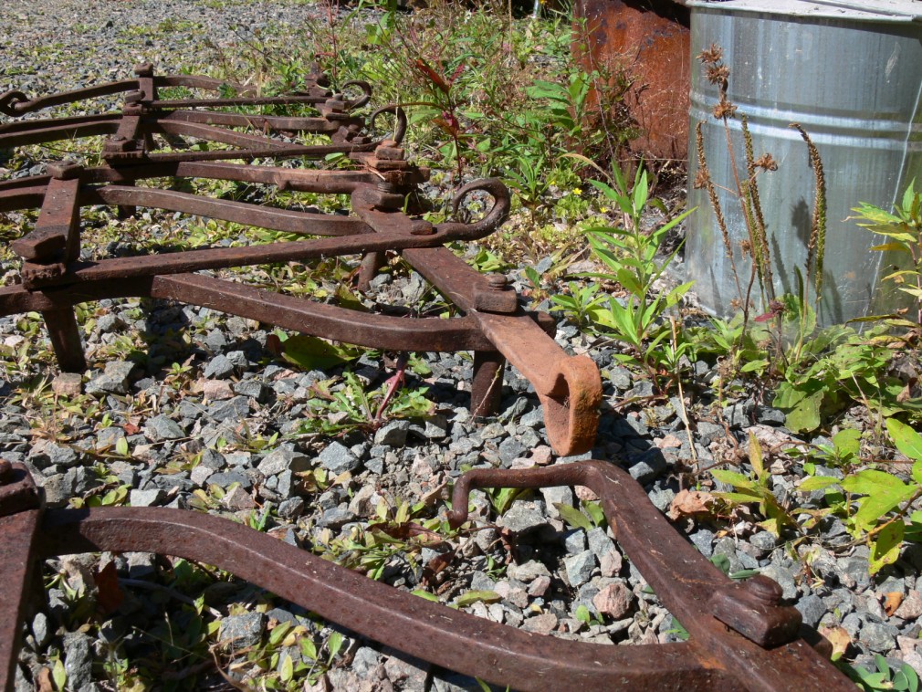

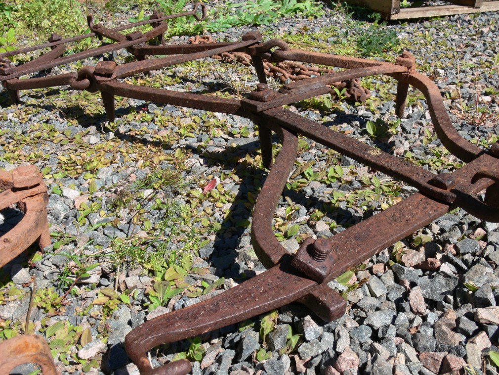

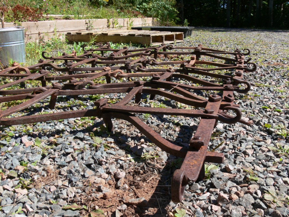

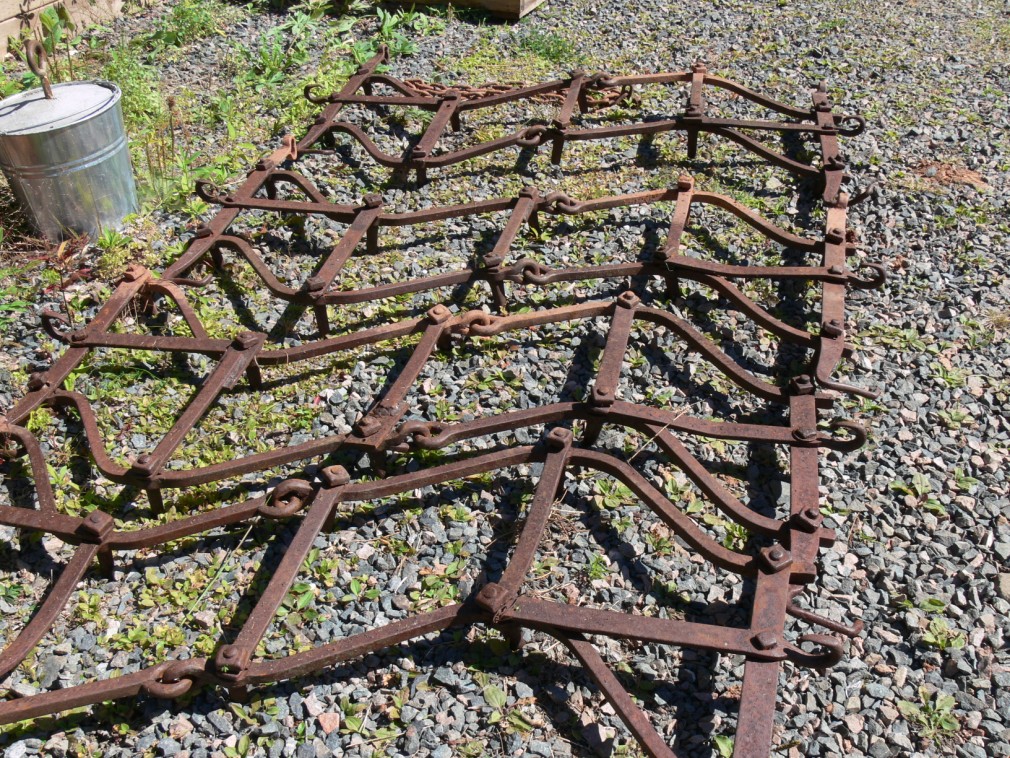

I'm working on landscaping my yard, and am nearing the point where I'll be doing the finishing touches before seeding the lawn and creating the flower beds. So I dragged the box blade around a bit for the first time today - actually I enjoyed that and it was very effective, and I can see it'll be useful in the long run. But I also asked my tractor dealer if he knew of anyone who might have an old drag or chain harrow they aren't using any more that might want to sell. He said "I might have something out behind an old barn on my other lot - - - ". So we drove over and he dug out from the long grass 4 pieces of what I am guessing is an old drag harrow. He said "It's all yours if you want it - no charge!!". "DEAL" said I, and loaded it in my car and brought it home. Now all I have to do is figure out how to connect it all together and drag it around and see what happens! Doesn't look too complicated :D:D.

That’s an old spike tooth harrow. Typically more useful dragging behind a disk to help break up clumps. It may not help you much for what you’re doing, but the price was right. It’s worth giving it a shot.

Worth $50 section at auction here. Line up the pieces, chain them to a pipe then the pipe to your drawbar. It's called a spike tooth drag with leveler. Drag it around in all directions & watch the magic.

Do you see those curly things, that look a bit like a short pig tail on one edge of the harrow section? On the opposing side of the section you will see a circle. Those hook together, the "pig tail" slips inside the circle. Then hook the big section to a pipe or a good long 4x4 wood pole or something like that. Hook to your drawbar or three point hitch....and proceed dragging it over your ground.

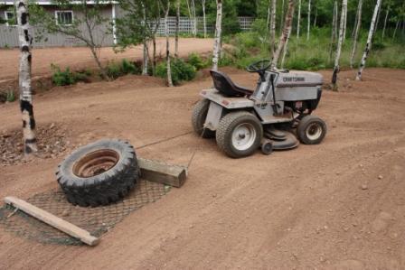

I wish i had one of those on my last lawn project. I made one similar, but much lighter out of a 6x6 and some chain. Wish i had a more aggressive one such as yours.
Youll be impressed at how well it smooths and levels your lawn. You can use either side depending on how aggressive you want it to be.

Scooby, that was going to be my first option until this dropped in my lap!:D
