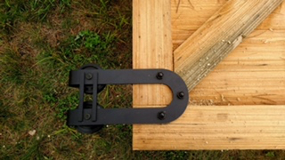

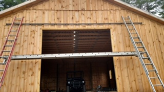

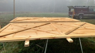

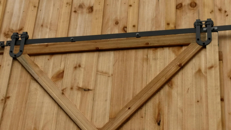

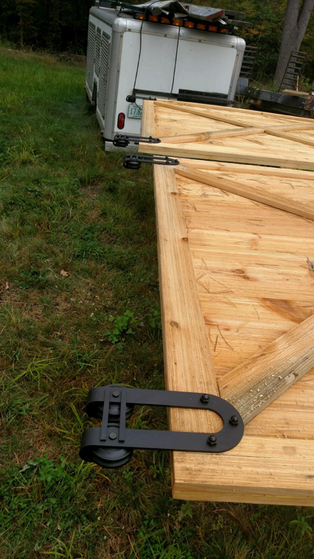

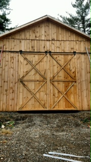

I built these myself for my barn last year. I bought all the hardware online and it went together really easy. Here are some pics that might help ya out. Good luck The bottoms are held in with hardware that for a lack of a better term is a U channel that bolts to the barn and keeps the door at a desired distance while opening. Rustic a Hardware was the vendor I ordered from. Hope this helps. image-3655059519.jpg image-3441699962.jpg image-528961509.jpg image-333748697.jpg image-3880176754.jpg image-1322954346.jpg
