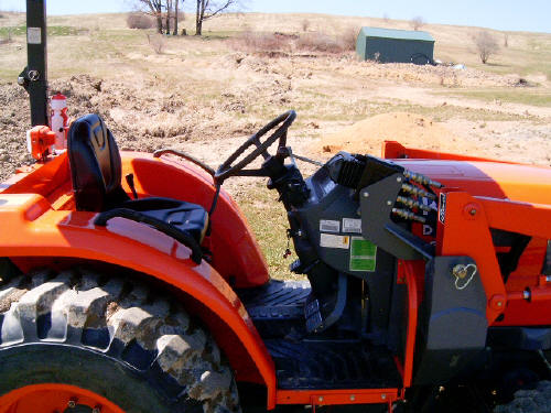

  • Rear wheels have about 1/8 inch space between kleat and fender. Sometimes dirt flies out at high speed due to it being compressed between the narrowing opening between tire and fender, as the wheel turns. Should I inadvertedly grab the fender, my fingers will be mauled off. Perhaps the wheels are too large?

A few thoughts. You probably know all this stuff. Those tires do not seem to belong on your tractor. Look like the wrong size. Perhaps in your local those tires are the norm but the tread design looks unusual to me (here in Connecticut, USA). The tires are too big or the fenders are too low. If you do not have one get a Workshop Manual for your tractor from Kioti - handy for reference. Might even give you standard tire sizes to check the tire sizes on your unit. The Workshop Manual for my CK20 HST TLB is good but not great but still better than the owner's manuals for the tractor, fel and backhoe, becasue it gives more detail and tips. (Every time I read the owner's manual(s) seems like I find something new I should have known but that did not register in my brain.) Put your tractor in bright light some day and spend some time looking for all those grease fittings and get a decent grease gun and give all the fittings a shot of proper grease. If you care to draw pictures or take photos of those hard to find grease fittings so you can find them again quickly. The pictures in the various manuals are hard to follow. Do you have a front end loader and if you do do you have a device to tell from the seat that the bucket is level - it is darn handy mounts on the loader mine cost me about $85 from my Kioti dealer. Check the "lugs" on all your wheels to make sure each one is properly torqued - some say the lugs can loosen up over time with a new tractor. Loader "bolts" can lossen up too over time. If rust is a problem, or potentially a problem, you might consider coating the lower part of the tractor, and even your wheel rims with Fluid Film to stop rust. Fluid film has a little odor but works real good. Some dealers miss some pretty important stuff I guess - with a new tractor nothing should be missed by the dealer IMHO. Above all have fun using that tractor!

Tires.. Are those the correct tires? Those are very close to the fenders. I have a lot of room between the tires and fenders on my DK 35 w/R-4's.

I have edited my posting and included a picture of the whole tractor. The wheel of vince's DK35 do look quite different. Yes, since recently I check bolts and wheels before use. Do intend to get a workshop manual (always got one for my cars).

I think I will politely be demanding other wheels. Otherwise I do enjoy the machine.

All the Kioti's I've seen have orange wheels.
If those are the wrong size, you may have trouble with the 4wd.

Not sure if the orange wheels are only on Kioti or only for North America. All the Daedongs I've seen pictures of have white wheels. I like the original green color and white wheels the best myself.

From the size on the tire that is probable they right size tire at least for the american version but I think those are the tires designed for rice patties.

The Kioti web page for a DK35 is below. The tires are smaller and the wheels are Orange. Click on specifications and it lists the correct tires for the unit. I think I would be discussing this issue with the area rep, or contacting Kioti directly.
