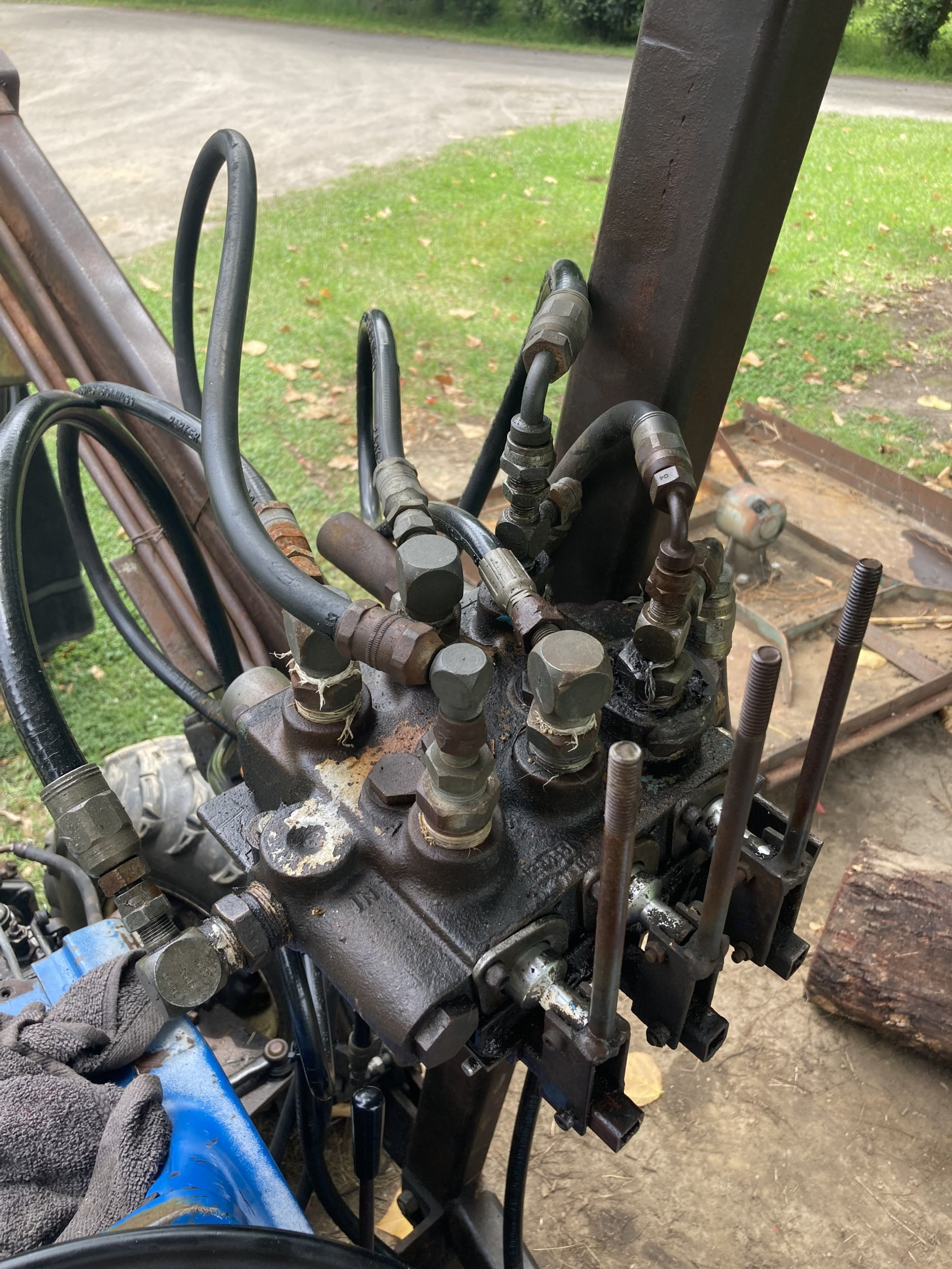

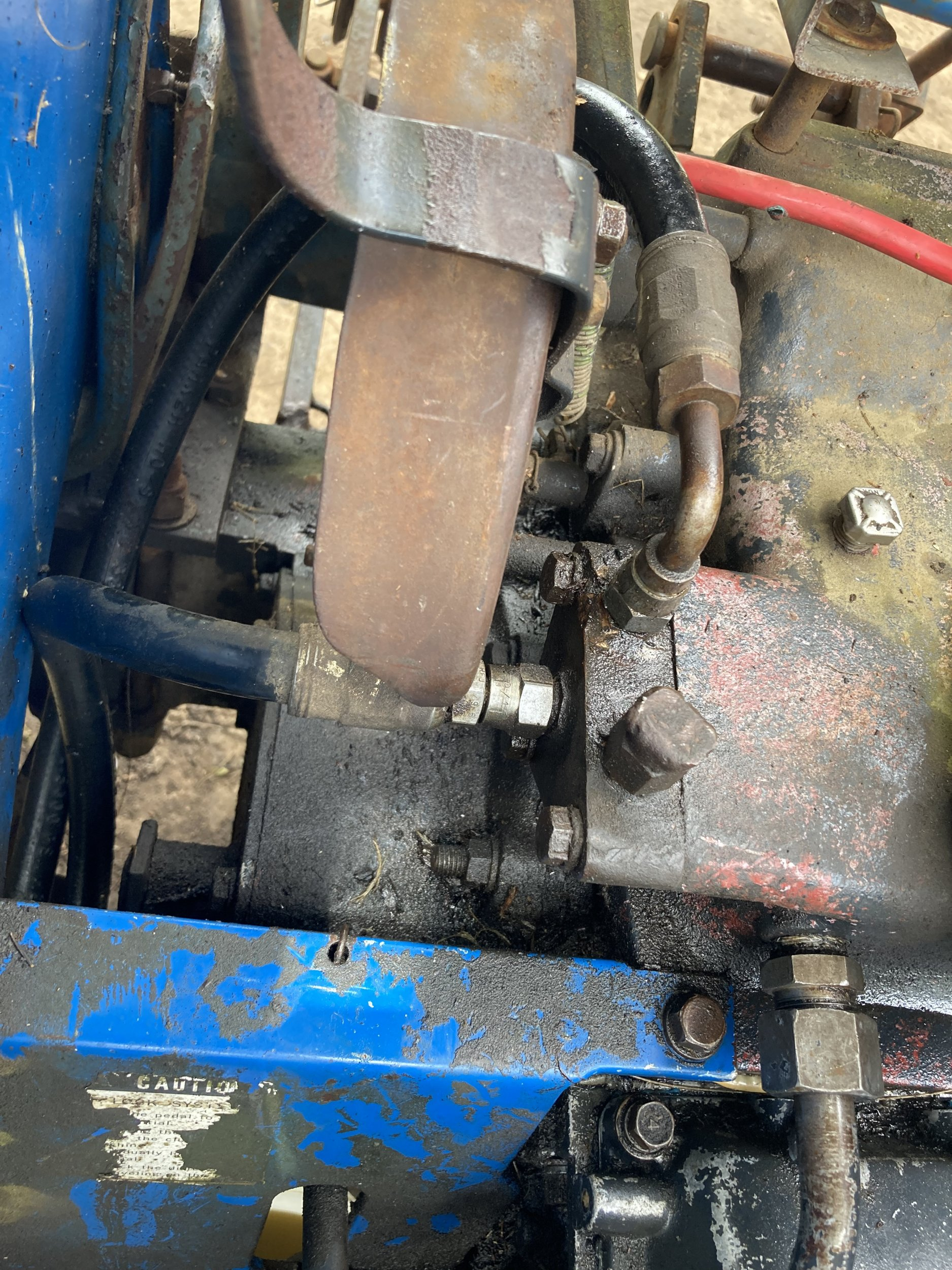

it is a gear drive machine it also doesn’t have power steering or quick disconnects on the loader. The loader is a dodgy home made contraption there is just a line going Straight in from the valve block on the tranny and a line going out back into the valve block. See attached photos
the hose on the top right is the return and the one going straight out to the left is the main hose going into the valve block for the loader the one on the bottom right is from the hyd pump

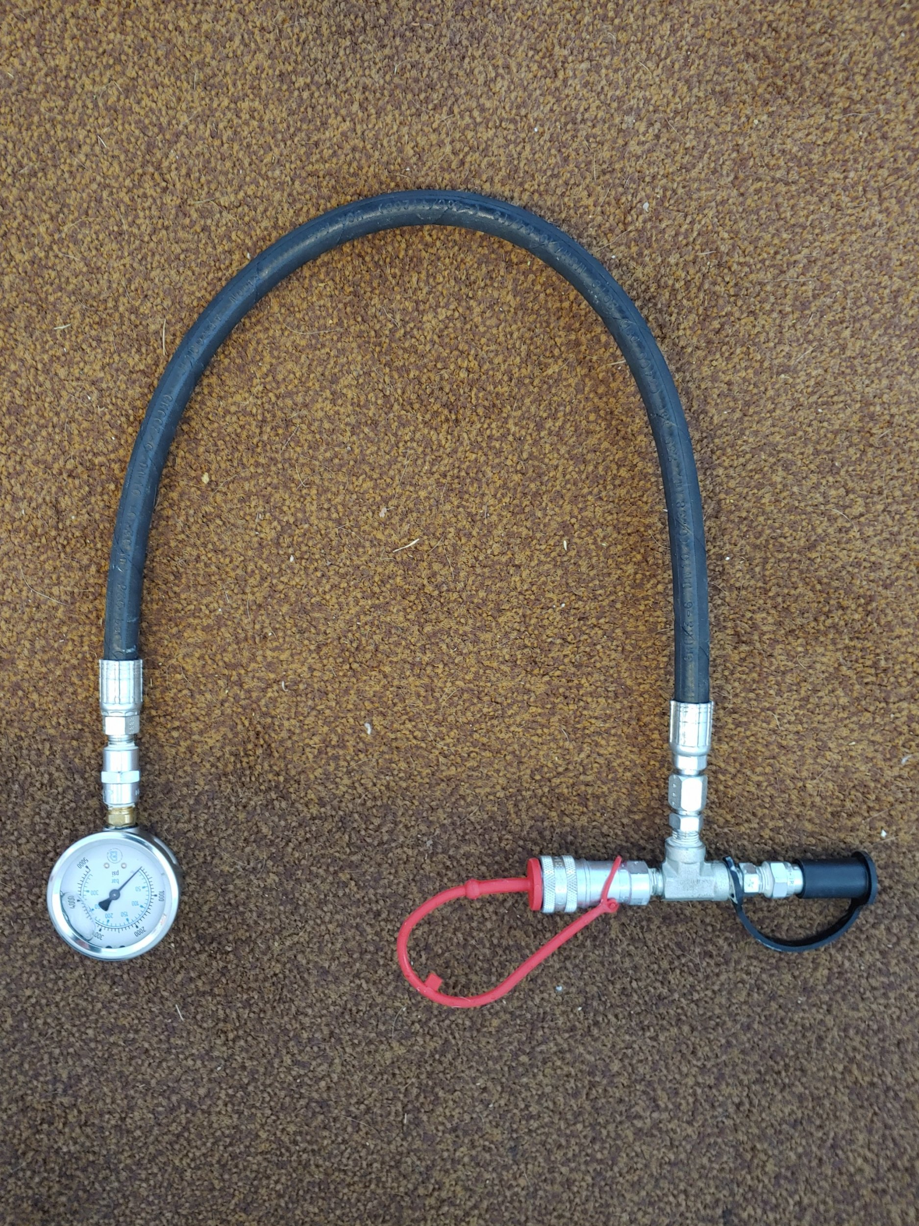

I'm thinking you need to get a pressure guage with the right fittings on it so you can T it into the system somewhere. Given the way it's plumbed, it's probably easiest to tap into the high pressure line coming into the loader valve body. Does the pump seem to make more noise than it used to? Here's the pressure tester I made, you probably want something similar. Hopefully there's a hydraulic shop where you can get fittings, otherwise you'll have to order online.

I ended up disassembling the hydraulic pump to find an o ring had come apart clogging some small channels in the pump. after blowing everything thing out and replacing the o rings shes back up and running now, thanks again everyone
