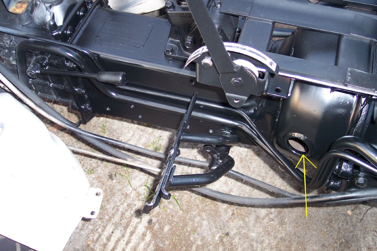

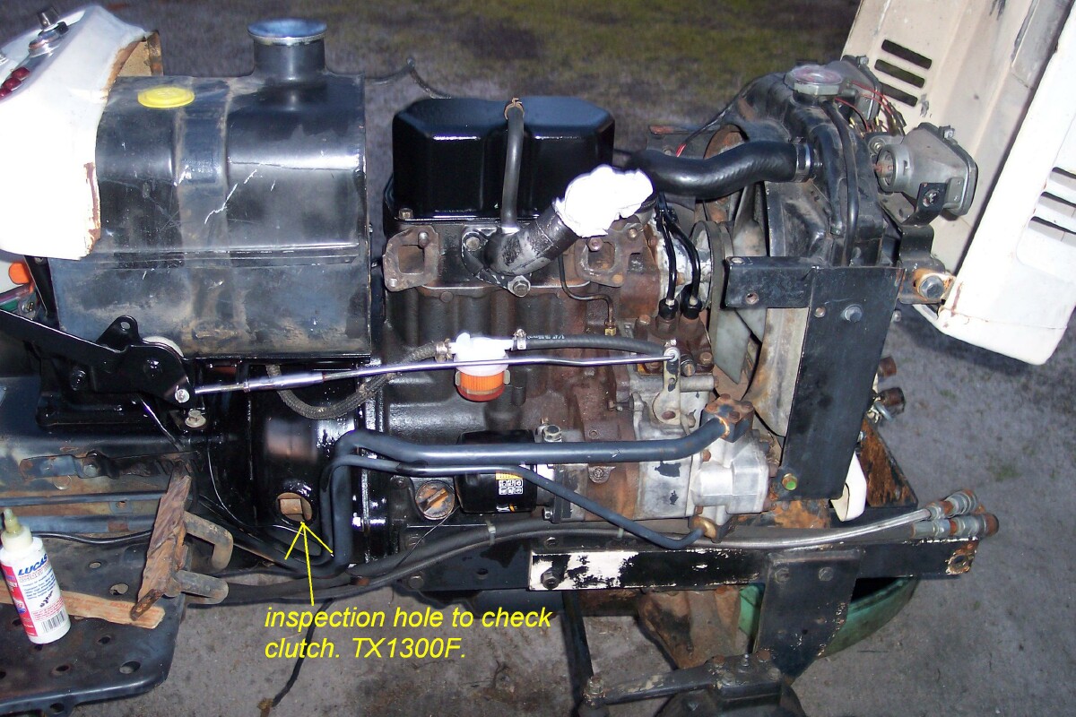

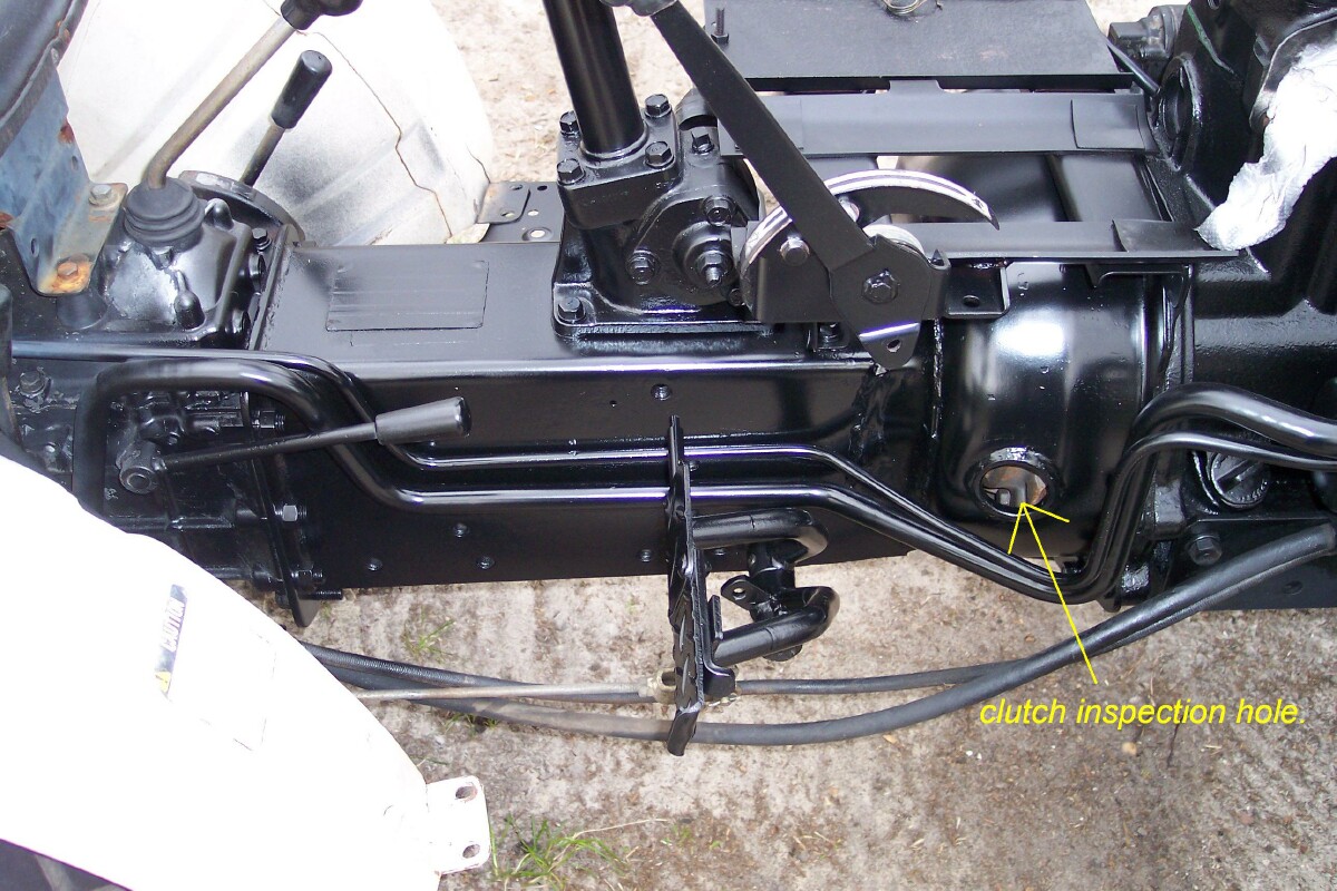

Does your tractor have an inspection hole in the bell housing to inspect
the clutch. I have been told that other iseki owners were able to
slide a putty knife in through the hole and with a little effort
they were able to free stuck clutch. Here are a few pictures
of the inspection hole in my TX1300F.
   / Iseki TX1510 Sticking Clutch #9
Also as an FYI on the inspection hole, it allows the clutch to be unbolted from the flywheel if the tractor doesn't "play nicely" when being split. It's slow going as there isn't a lot of room to swing the 12 and 14 mm wrenches (IIRC) required to do the unbolt but it can be done. When the clutch in my G172 was frozen to the shaft I couldn't separate the clutch housing from the engine and I thought I was going to break the bell housing or engine casting with the wedges I was using to separate it before I stumbled on the "unbolting from flywheel" option - normally the clutch assembly remains on the flywheel during a split. Some tractors don't have an access port and I have no idea how the tractor could be split in this case without cutting a hole in the side to do the unbolting. It took a lot of heat and hammering in addtion to a torqued-up puller to get the clutch to break free (and break it did) from the shaft. If things aren't siezed up, the engine and clutch should separate very easily from the clutch housing.

Hi thank you for your post. Yes it has exactly the same inspection hole - can I ask does this unscrew or just pop in/out. also it appears to be 'sealed' round the edges with some material is that correct or is it just paint?
