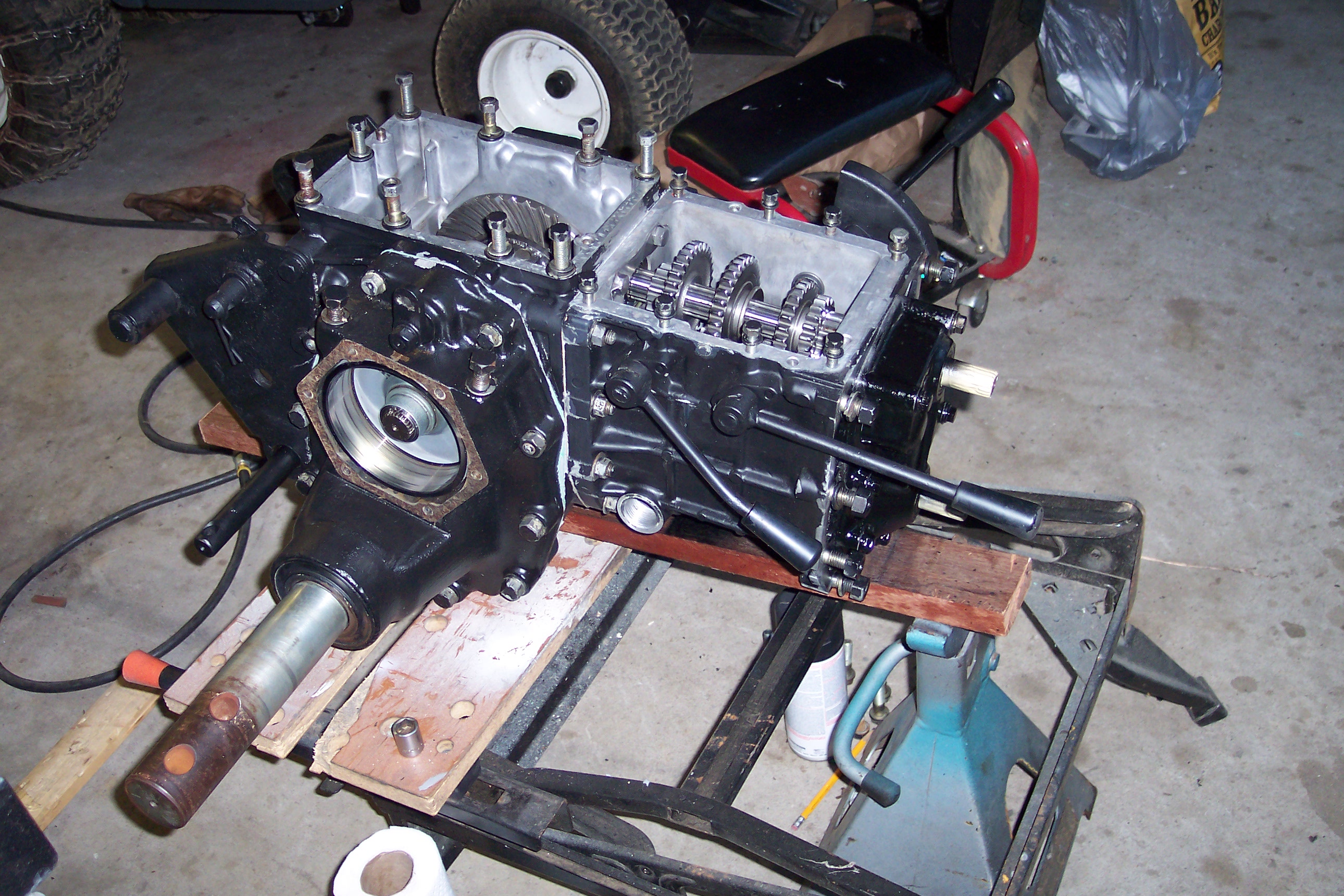

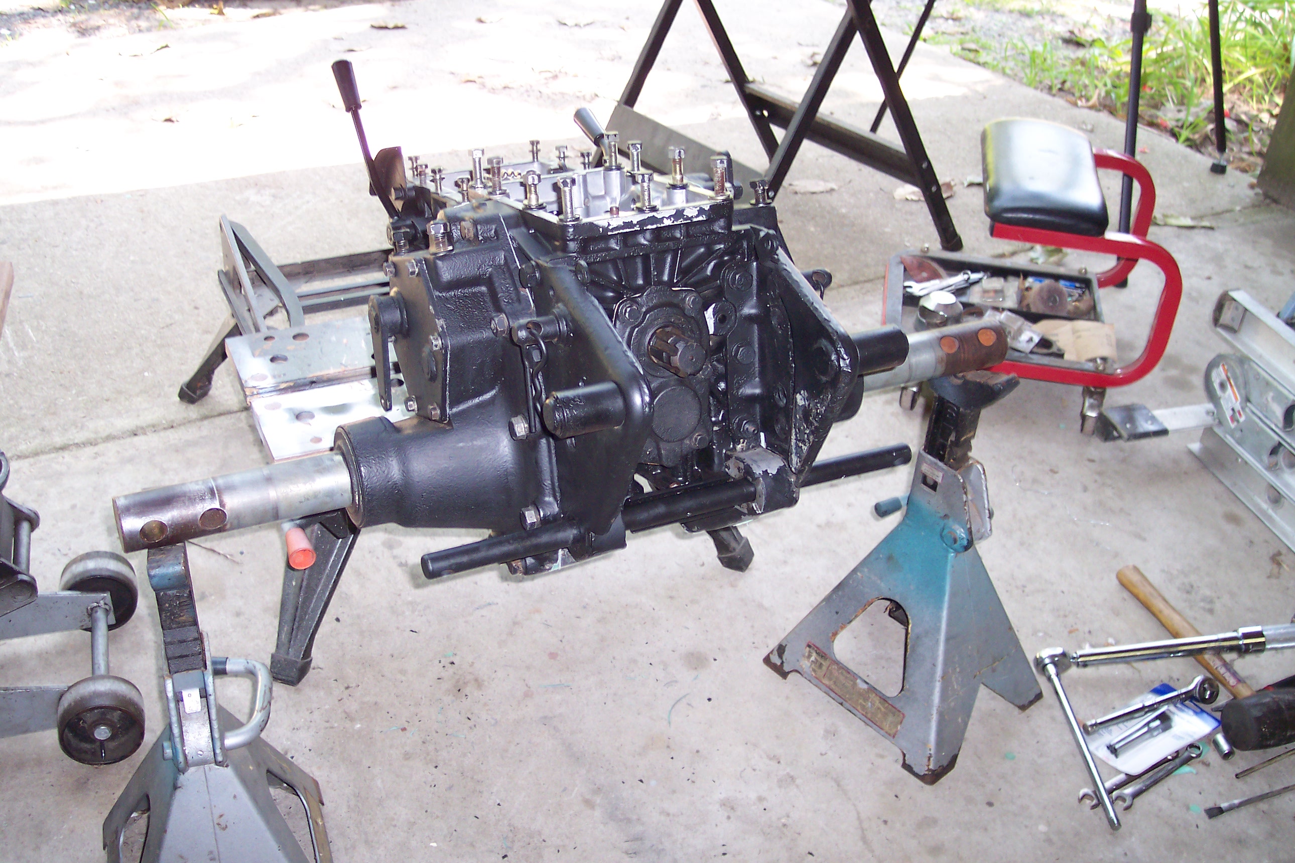

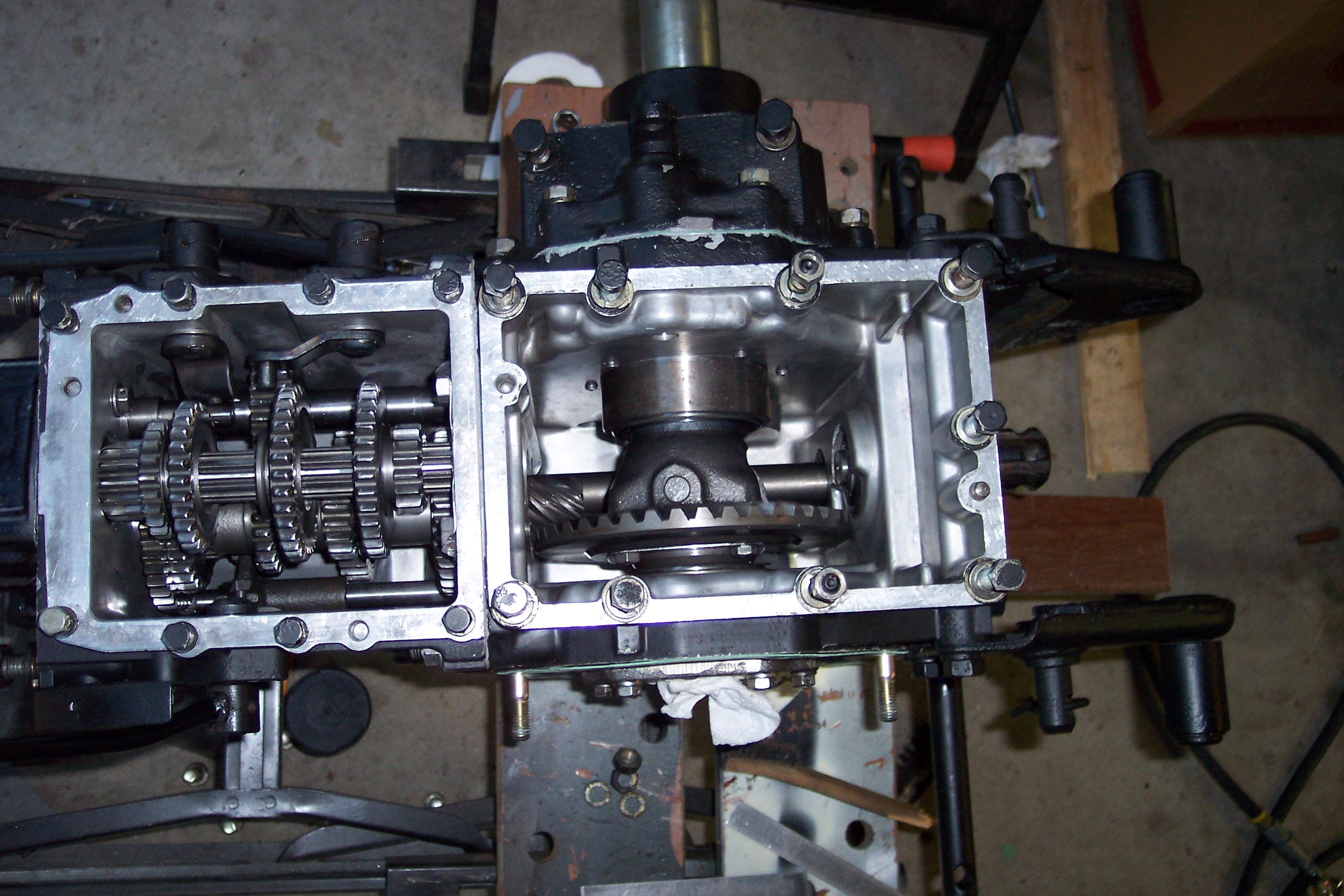

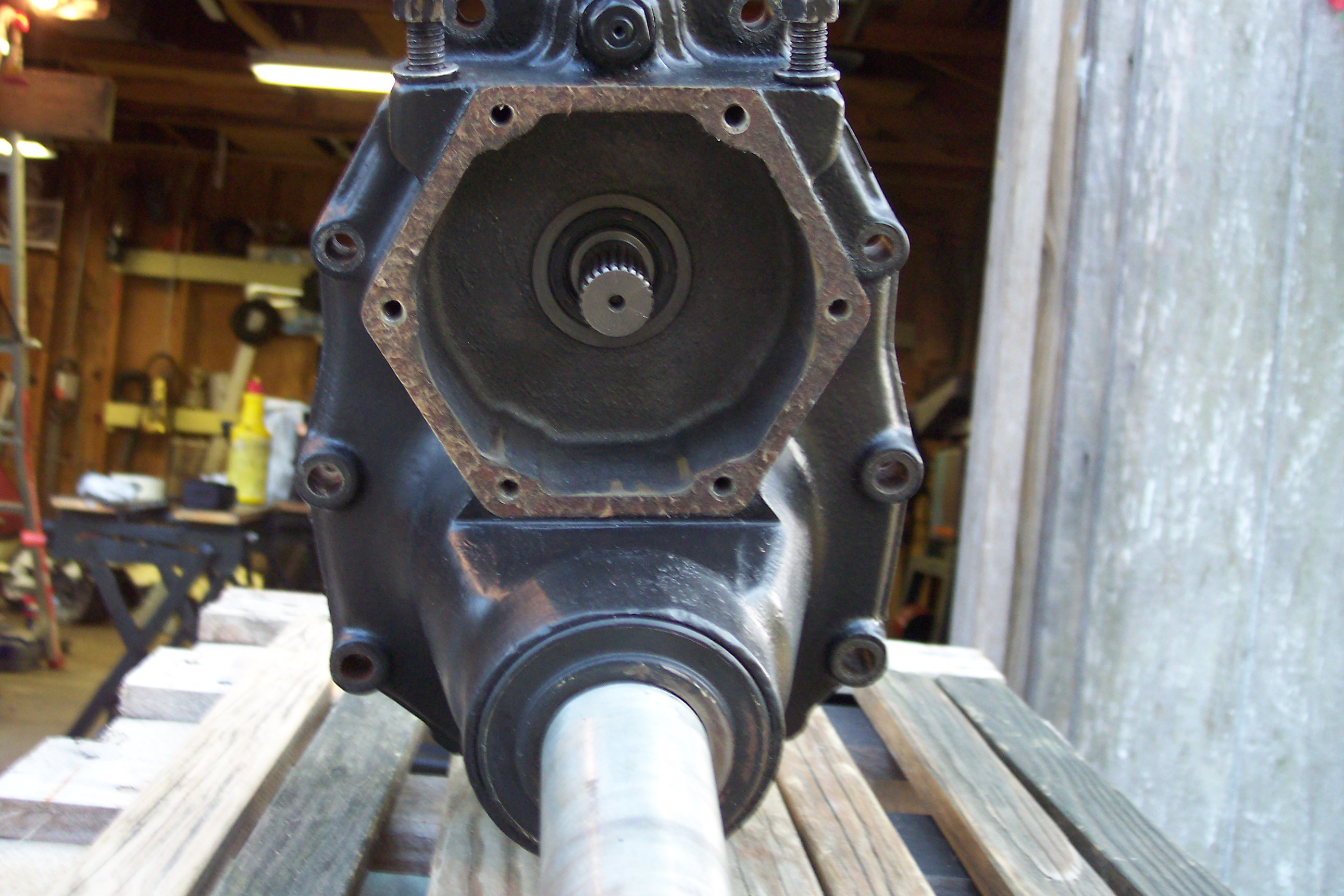

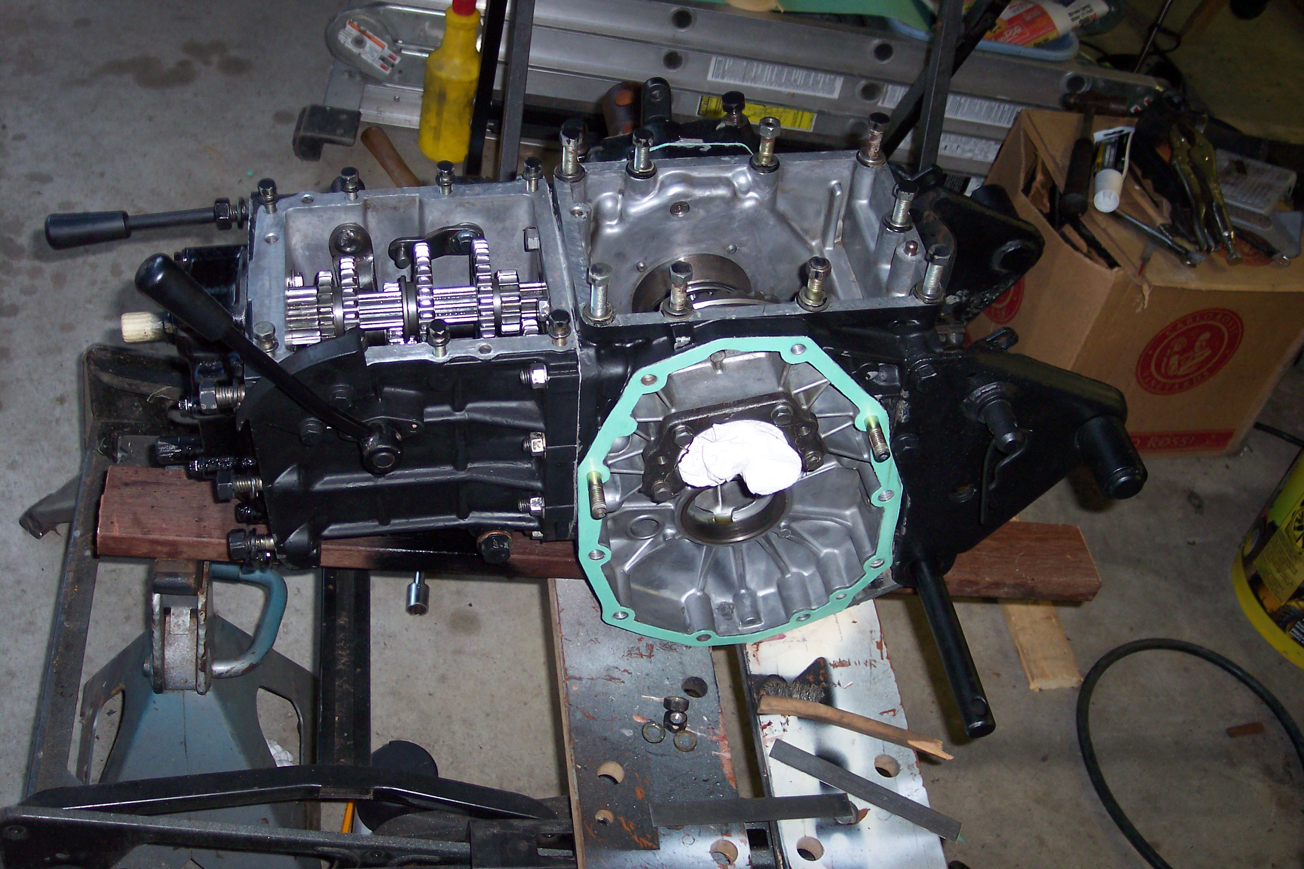

I wasn't implying you were stupid, just some friendly advise.
Do you still the old transmission? you may be able to
unbolt the axle housings from the tx1510 and bolt
the whole axle assembly onto the 2160 transmission.
Here a few pictures from when I had my TX1300f
apart for many repairs.

Hi sorry my English/Grammar was unforgivably poor I didn't think for a moment you were implying I was stupid I was just stating the fact LOL!!! Much appreciate as ever your kind help. Sadly few and far between in the UK it seems. Really excellent photographs by the way which are very helpful will probably look at the possibility of doing this shortly thank you so much again
