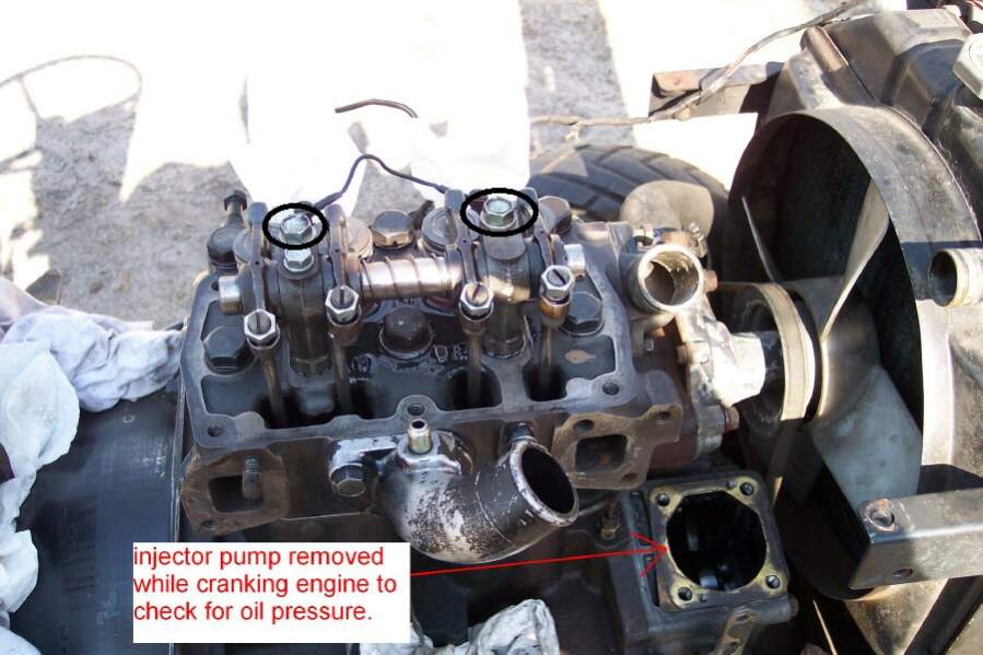

I got a iseki TX1300 and i needed to replace the head gasket because it was leaking but upon disassembly i noticed the pistons were bad too so i'm going to replace them also.
Buying secondhand is always a risk i suppose?
But what i wanted to ask was the bolts for the head need to be torqued at 68nM, is that correct?
And at how many nM do i need to torque the rocker shaft?
or does anybody have a service manual of this tractor?

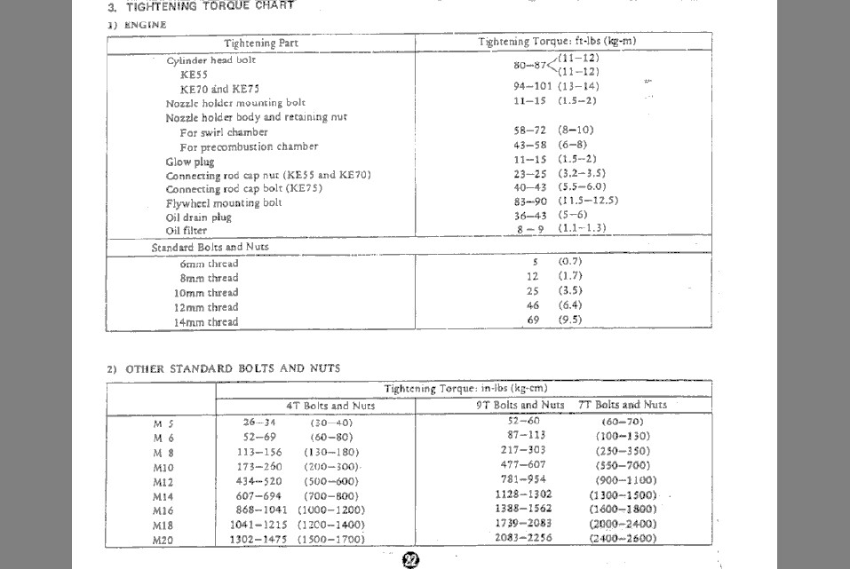

Here are the torque specs.

thanks for the chart!
So the rocker bolts don't need to be at a specific torque? as i can't find them on there.
(i took one of your pictures to show you which bolts i meant:))

Look at that chart again. Check the section for standard nuts and bolts.
the bolts that hold the rocker arm assembly to the head are 12mm.
12mm bolts have a torque of 25 foot lbs.
