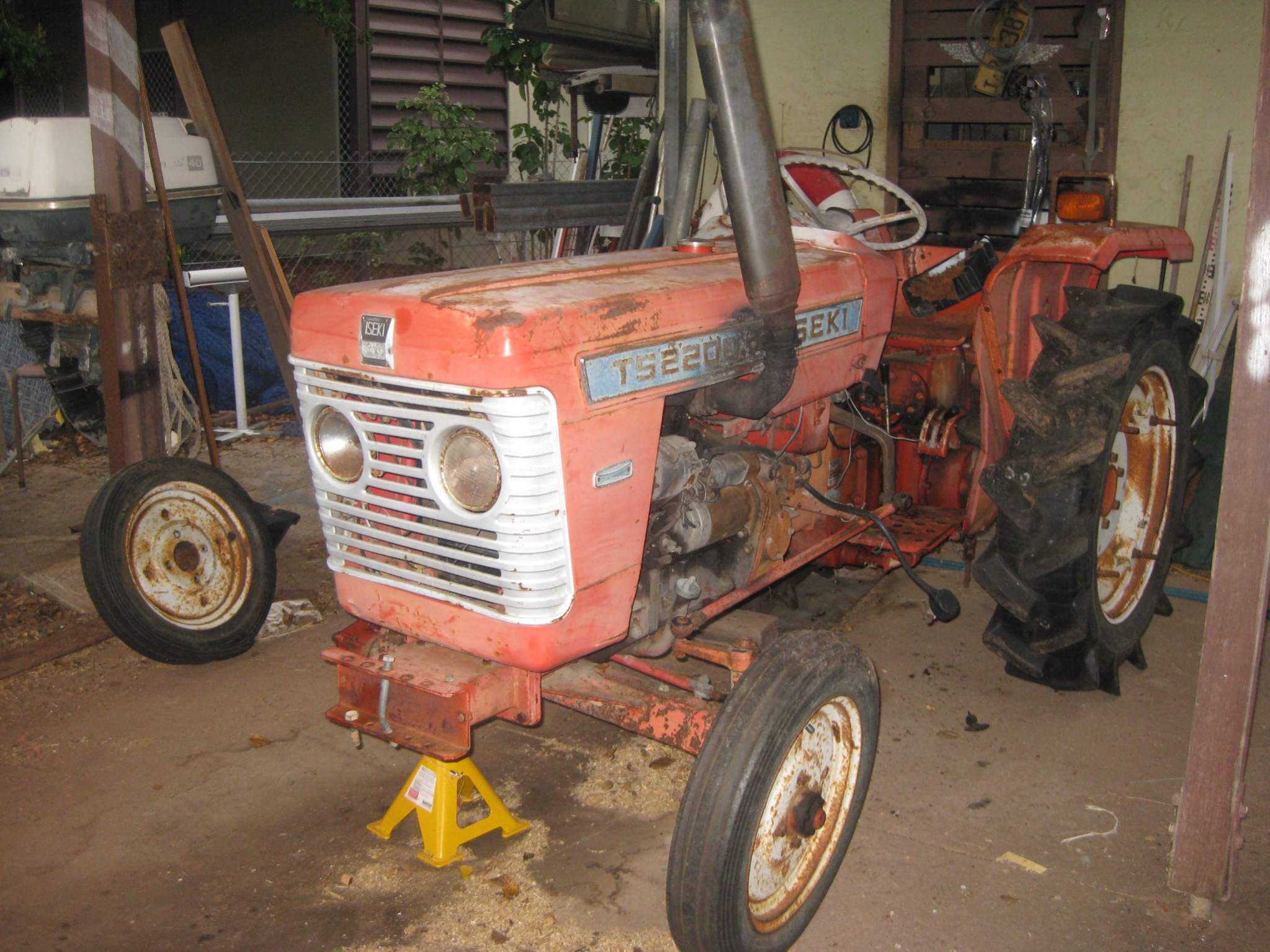

Hi I have a TS2200 and have found it very hard to get any info on it. apparently it is not a very common model in Darwin as I am told it was imported direct from Japan.
what I am after are manuals for it as it is blowing a bit of smoke and it had been sitting out in the rain for a couple of months with the seal around the gear leaver missing so some water has got in.
The motor is a ISUZU 2 cyl. 2AB1. I am intending to pull the head off and put a set of rings in later on.
It appears to have a separate transmission and hydraulic system as there is a dip stick (for want of a better word) under the seat. the type and amount of oil would be helpful as the local dealer had no idea.

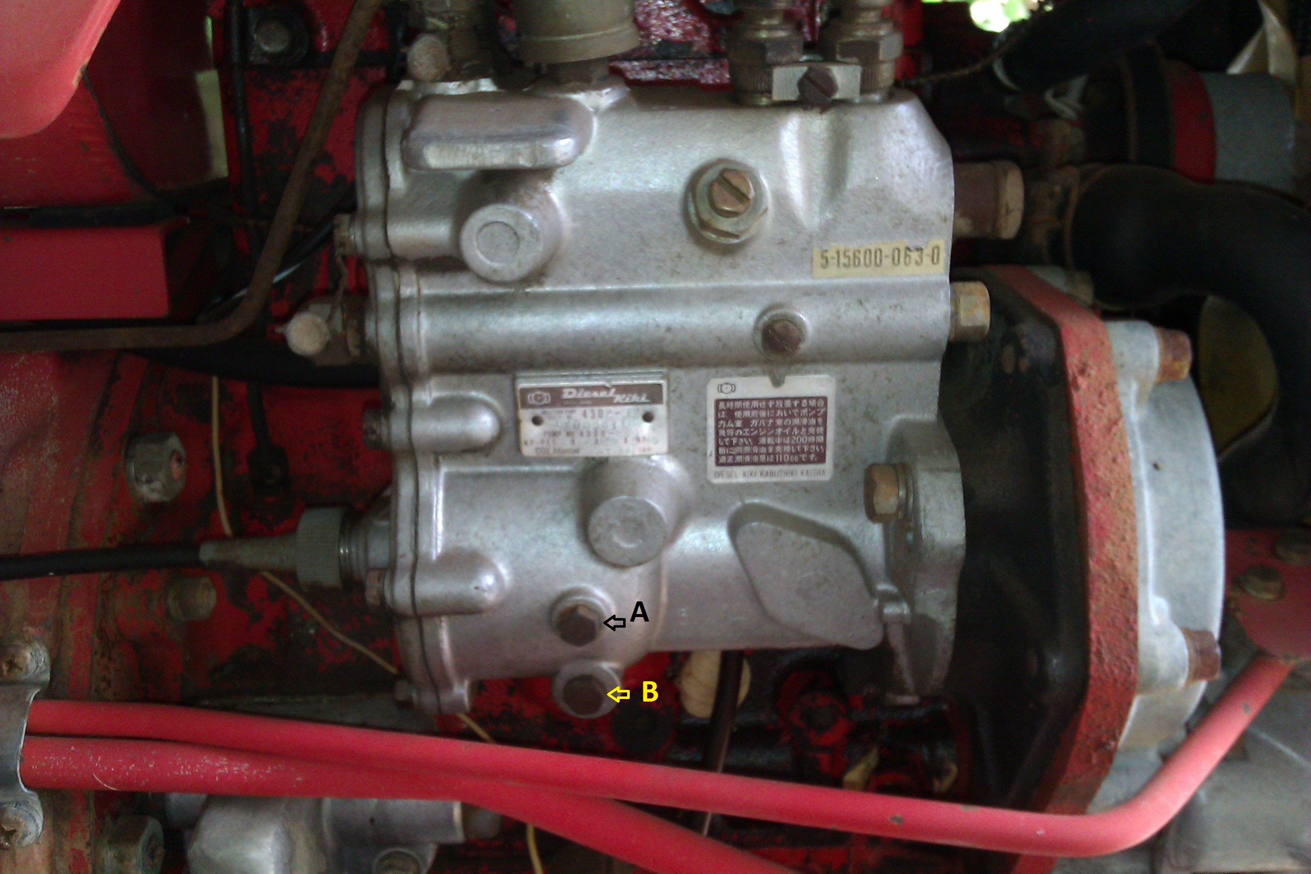

Thanks for that IMAG0158.jpg in the attached picture (hopefully) I have labelled two plugs, would "A" be the level indicator and "B" be a drain.
also with the breather how does that come off as I have turned it and it appears to just turn, or do you get a spanner on it?
   / Iseki TS2200 information #6
Yes A is the level B is the drain. Yes get a spanner on the breather if you need to add oil.
