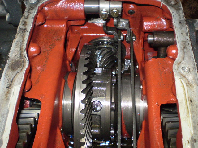

i have recently bought a TS 1919, it has a selector for a 4 speed PTO but I can only select 2 of the speeds, (marked 2 and -4) the other 2 positions are totally solid, impossible to move the lever into either position, any ideas
   / Iseki TS1910 or TS1610 owners? #46
You might check your linkage it could be as simple as giving it a good soaking with PB blaster or posible adjustment or something could be jamming them like a rock or wasp nest . You will probablly need to remove the left rear wheel & a metal cover to gain access if its like my TA 250 .
First pic is the location of the linkage arms , last two are of the inside of the gearbox where you can see the arms & forks if its more serious . Hope that helps .Good luck ;)
