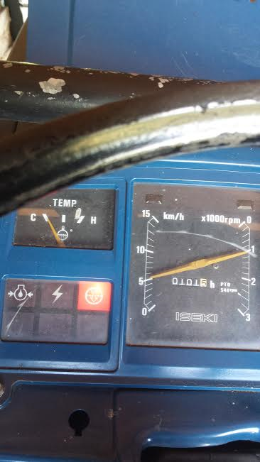

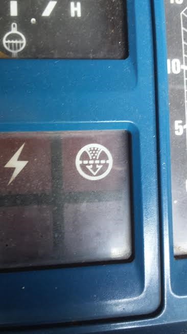

I bought 15 acres to build a homestead on and the purchase included an Iseki TL2300 tractor with a front end loader and a 5' cutter. The tractor initially worked fine but two days ago a warning light came on and I don't know what it refers to. The tractor also started running hot at that point. I've included two pictures for reference.

Air filter is full. Replace or clean

Any ideas on where I can find a replacement filter? I have been all over the place and everywhere can get one either too long or too short (not to mention the fact that the TL2300 doesn't pop up on anyone's system).
/ Iseki TL2300 Warning Light Interpretation #4
I have a TL2300 and found it to be a great, reliable tractor. For the air filter, a WIX46270 is a good replacement.
If your tractor is overheating, there is a screen in front of the radiator that can be pulled up to clean. Clean the intake to the radiator too. I found that I had a bunch of material that had made it past this screen and was on the intake side of the radiator. While you have the front grille of the tractor off, check your power steering fluid. The tank sits below your battery and the fill tube is to the lower left of your battery as you are facing it. It is kind of hard to see.
Check your fuel injector pump oil level. I find that I need to top this off a couple times each season with 30W oil.
A few other filters that I have used:
Fuel filter: WIX 33264. Make sure you push the filter into the housing all the way so it isn't crushed when you reinstall the bowl.
Oil filter: WIX 51034
Enjoy your tractor.
