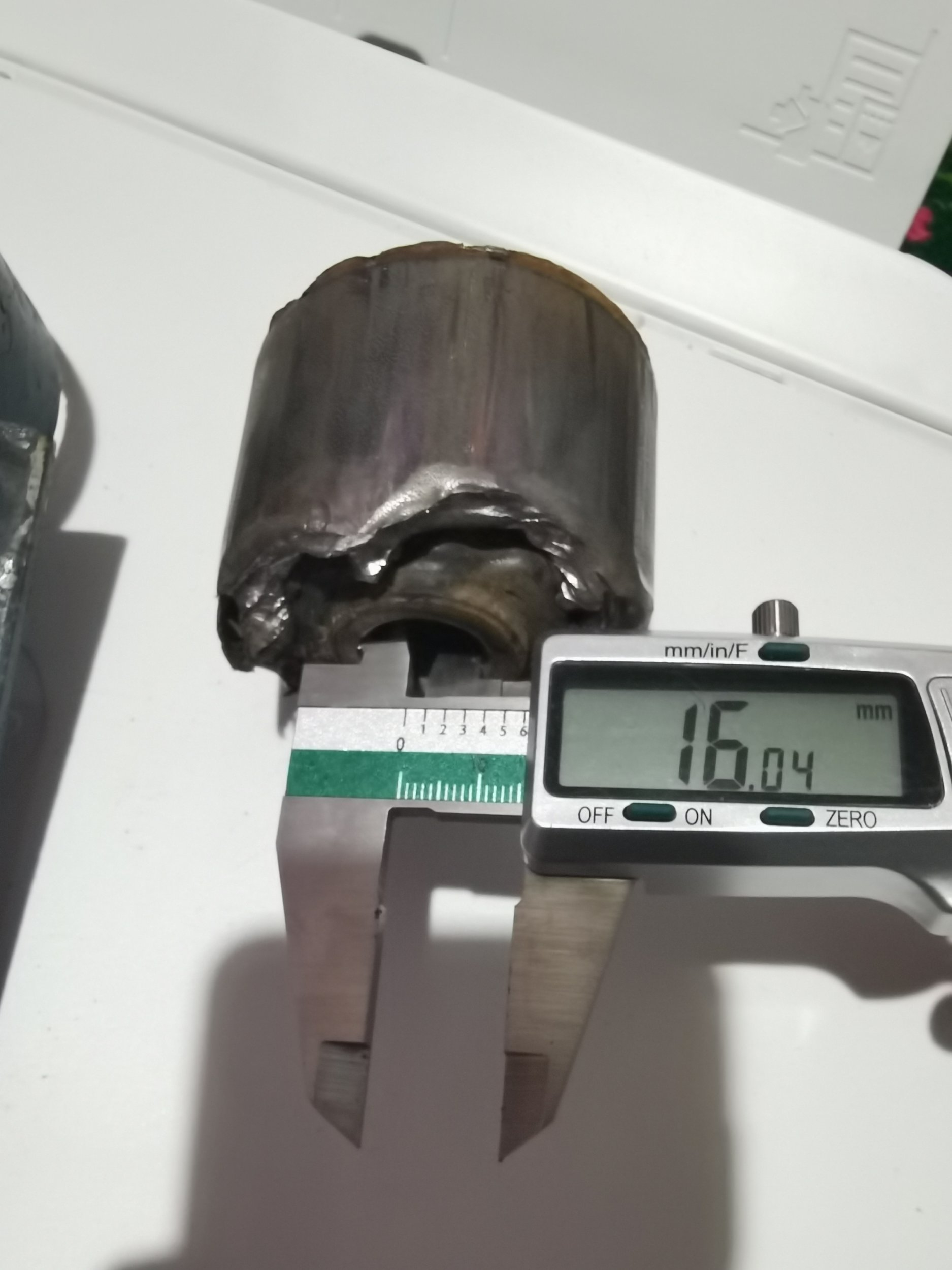

Hi, I have an Iseki TA230, and I can't find the cab support rubber bushings.
I've attached some pictures below with approximate dimensions, but I'm curious if you changed these bushings and where you bought them.
An approximate size would be: ∅16x∅60x50 mm.
Thank you in advance and I wish you all the best.

Try Energy Suspension -they list their products by size & may have one that will work.
Also, the bushings can be made using the inner and outer sleeves and pour-in urethane. Looks like one of your outer sleeves is chewed & may need to be made from appropriate size tubing or on a lathe.
Try McMaster Carr for urethane of different durometer ratings and Google the process.
