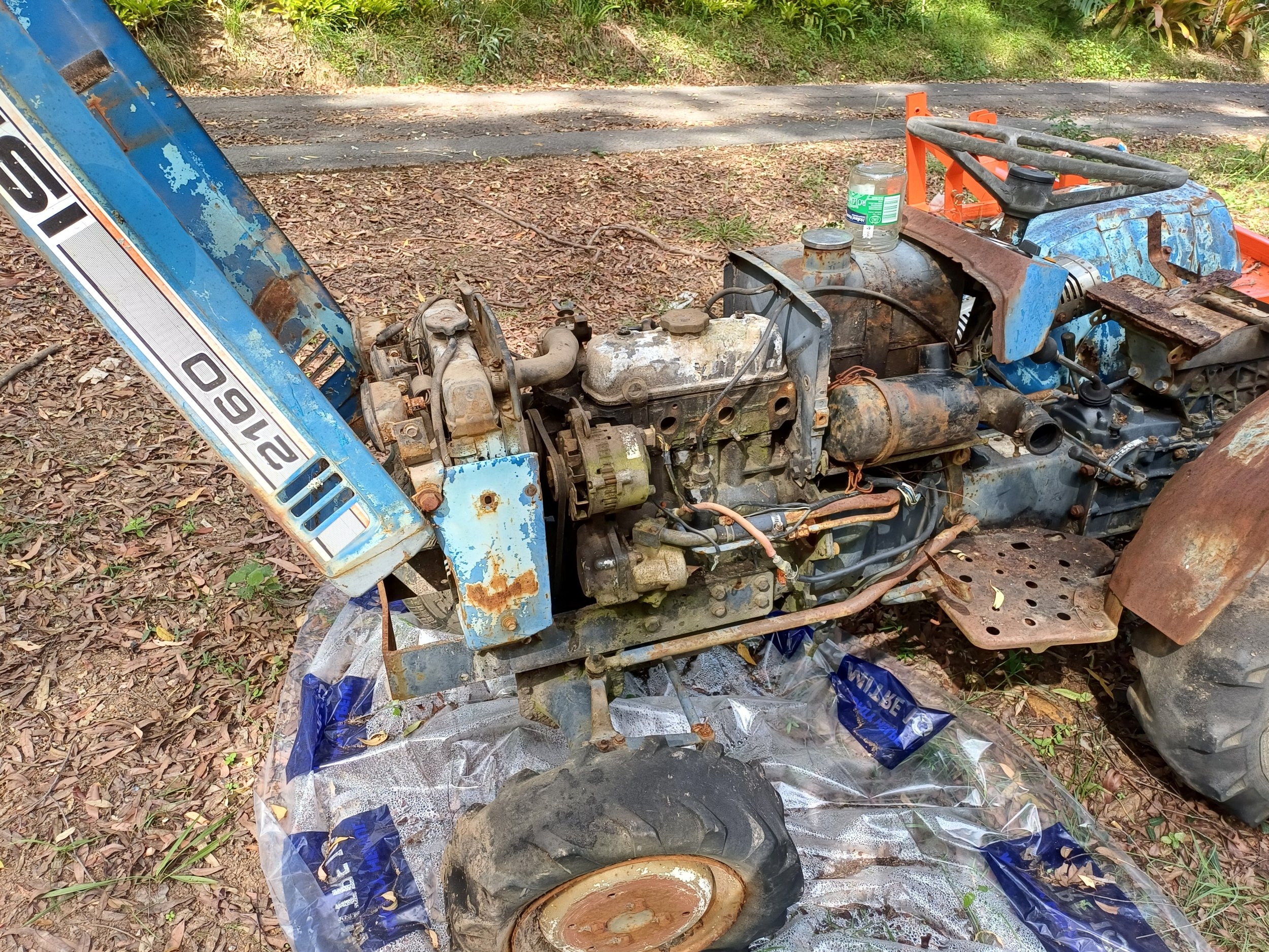

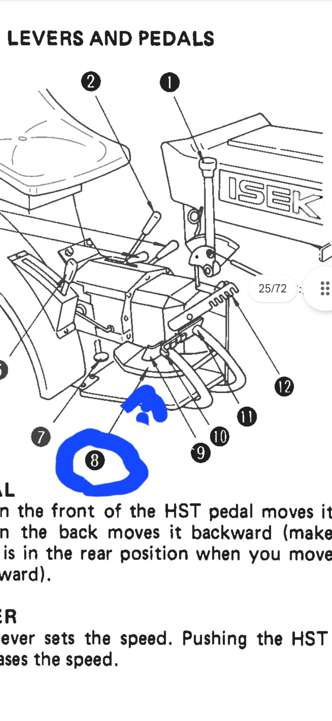

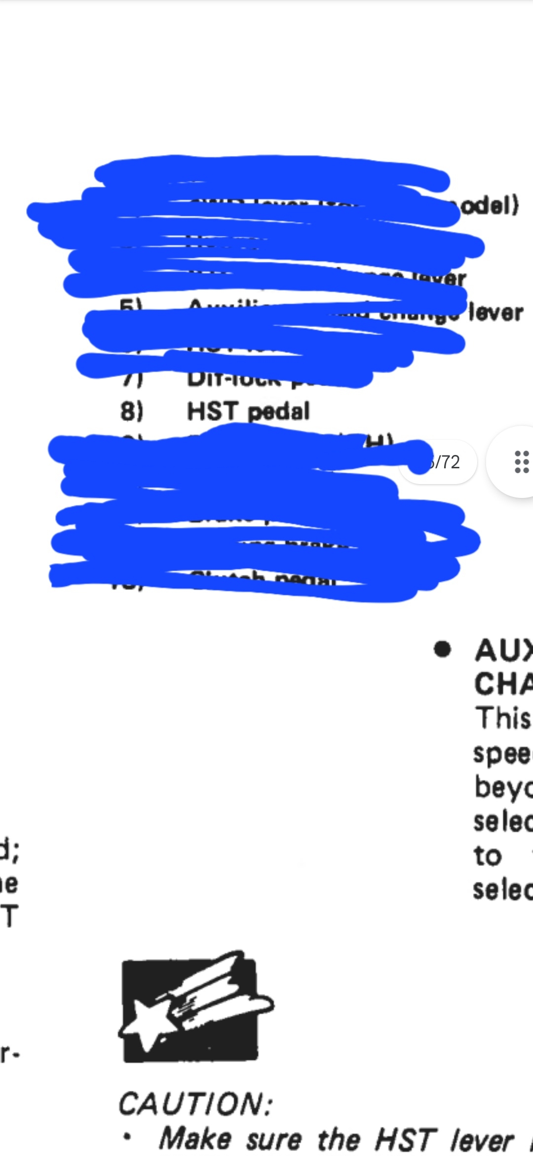

The TD site mentions the TX2160 is an HST. And the OPS manual I found mentioned HST. So by deduction, I assumed your machine is an HST. Could Iseki make both a gear driven and HST type, it's very possible.
My TX2160 is manual gearbox from about 2004

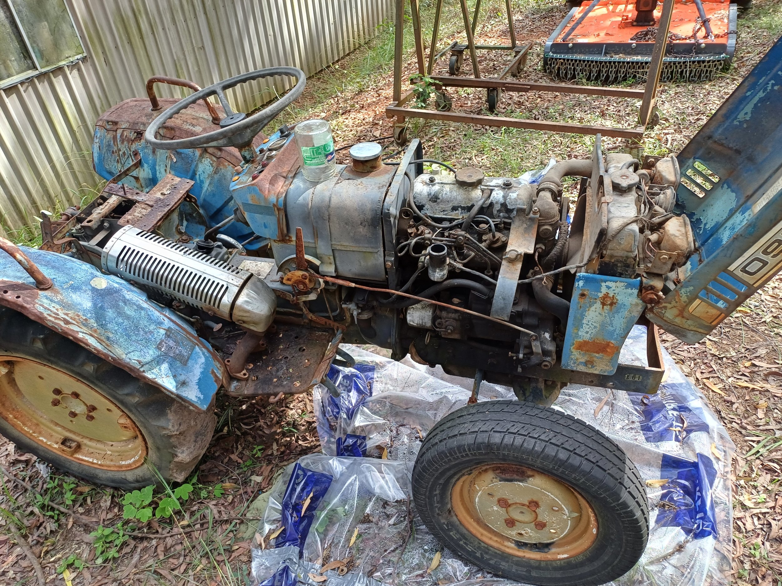

you have the same engine as my 1983 international 234 except mine is 18hp. if you want the full data on your tractor, just google Iseki 2160,Data and click on the tractor data link
Mitsubishi K3B
diesel
3-cylinder
liquid-cooled
Displacement51.8 ci
0.8 L
Bore/Stroke2.677x3.071 inches
68 x 78 mm
Power16 hp
11.9 kW
Rated RPM2600
Starter typeelectric
Oil capacity3.2 qts
3.0 L
Intake valve clearance0.014 inches
0.356 mm
Exhaust valve clearance0.014 inches
0.356 mm
