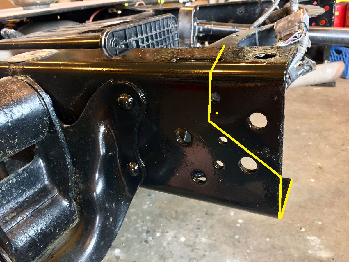

Yep, you want something like this for your frame cuts:
Then weld it and weld a gusset over it that has rounded corners.

That type of splice is how I plan to join the front and rear halfs of the truck I'm building, a crew cab with an extended cab rear section added on, using the rear 2/3 of one frame, and front half of the other, with the splice going under the cab, just behind the trans cross member. Fish plates inside the rails, and likely an additional cross member, to add another 'rung' to the 'ladder'.

Truck frames are lengthened and shortened everyday. Make the cuts at 45 deg's. and use the correct filler metal and procedure. Not a job for someone inexperienced.

Whenever we had to extend wheel base on non straight frame vehicles we cut the frame at an angle welded, then either added liner or support on outside bolted.
