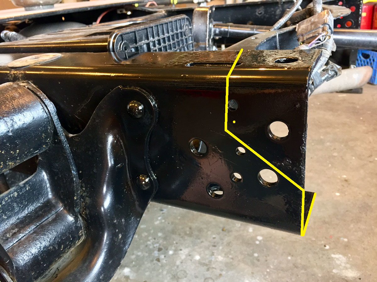

Just a box truck!?!? U will be fine.....just keep it under 60mph. That, of course is sarcasm. In all seriousness frames are cut every day- RVs, ambulances etc. What little I’ve done with 4x4s on the frame I know you don’t want square corners if it can be avoided. Use ovals instead of rectangles for gussets and probably a Z or angle cut instead of a straight cut on the rails. But like I said before, do the research and take your time.
   / Is welding two truck frames together an awful idea? #6
Yep, you want something like this for your frame cuts:
Then weld it and weld a gusset over it that has rounded corners.

What others have said. Cut it at an angle weld it together. If you have enough space on the inside frame rail, consider having a liner bent up that fits inside the frame rail, then bolt it. Not a real fan of fish plating, seen it done, on a box truck fish plating should work, but much rather see double frame. If you plan where you cut it don't see an issue. The problem you might run into is on some of the medium duty trucks the frame rails are not straight so it becomes more difficult. Good luck its do able.
   / Is welding two truck frames together an awful idea? #8
I've been to a shop that did frame modification on heavy trucks, had at least 2 in the shop when I was there... they cut the frame as shown above then "fish plated" over the joint, I was only there for 2 days working on a street sweeper so don't know everything about it but the trucks they were working on were getting vacuum outfits like a Vactor truck...
   / Is welding two truck frames together an awful idea? #9
Back in the old days we welded class 8 truck frames to lengthen them. Just fish plated them inside and outside the rail where they were joined. These were on dump trucks that pulled pony trailers at grossing 140,000 pounds. I never had any issues with them after being welded.
But we normally tried to do it an an area of least load and stress.
