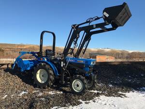

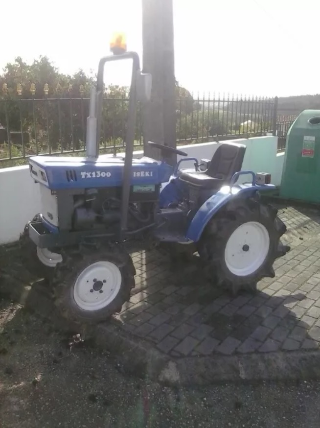

Based on recent events i started looking for a ROPS .
I came across this link on the local ebay:
ISEKI TX GA pałąk rama części ORYGINAŁ NOWA 76142(n)2 - Allegro.pl
As i have no clue what they should look like:
Can anybody confirm this is a ROPS?
Also: any clue how this has to be fitted to iseki tx1300?
Any comments are welcome. The price is surprisingly low: about 180 dollar...?

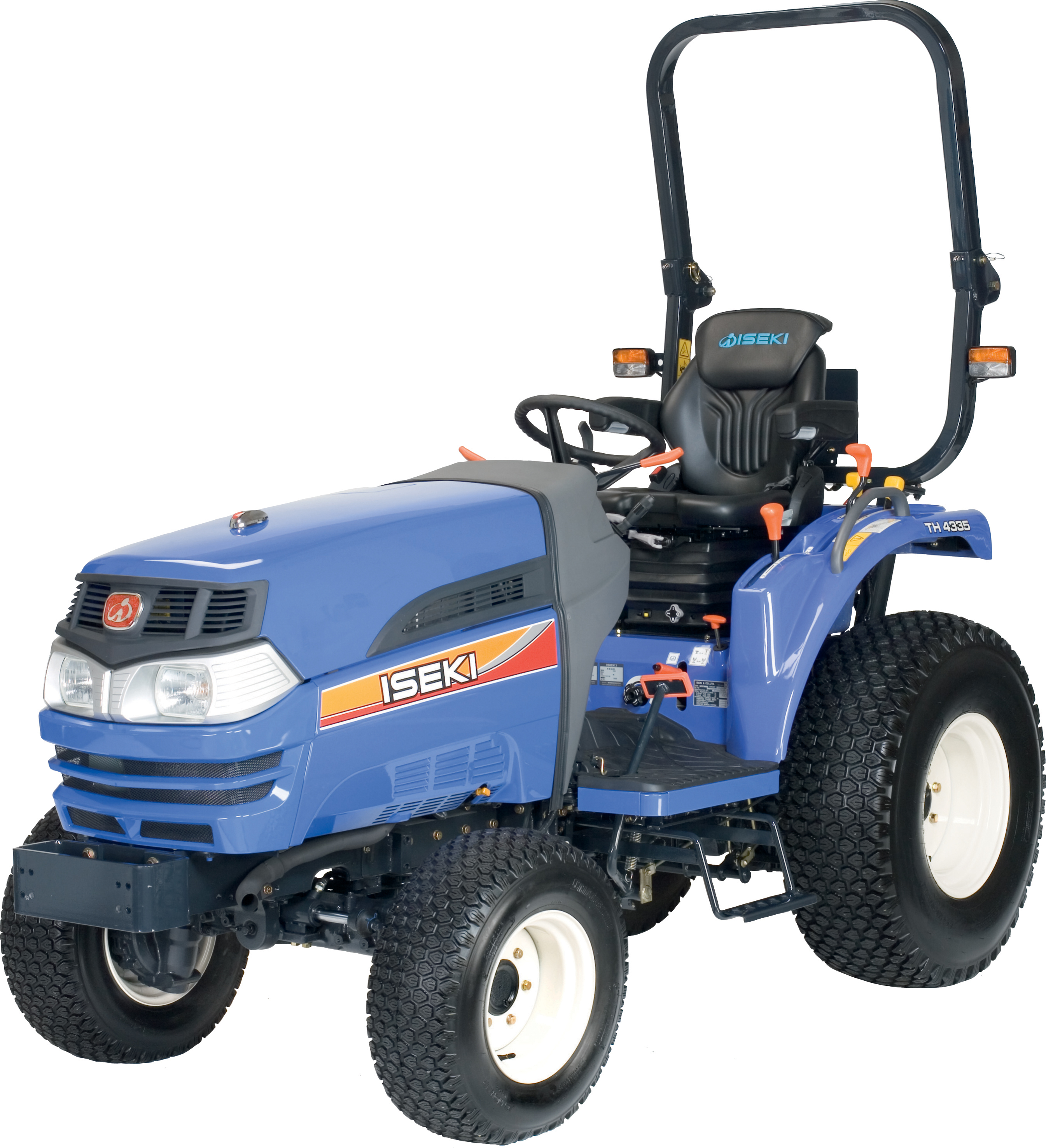

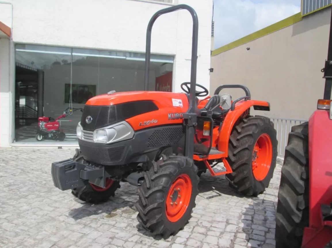

Goodmorning @ least in this part of the world . To me those you posted link to seem to be for a Iseki TH4335 HST compact tractor . That bend in them with the lesser gauge steel tubeing dont look heavy enough at least to me from pics .....
I posted a pic of the 4335 compared to your tractor .................

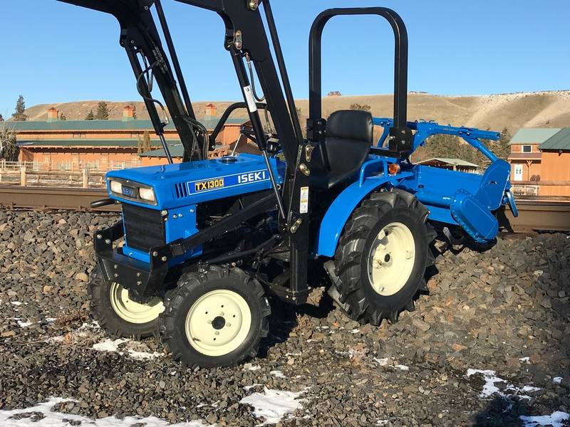

Yes those are ROPS.
You will have a hard time finding something specifically for your tractor since they never came with ROPS from factory, neither they had plans to add.
That being said, you have two options. Either built a ROPS completely from scratch, or get something like the one in the link and build the mount for it.
You can also go for a rear mounted ROPS or a mid mounted ROPS. The mid mounted might be easier to build since you can use the frame of the loader. Should make for a very solid attaching point.
Here an example:
That ROPS is just fine. You should see what Kubota uses on mid mounted ROPS on the bigger L40 series, here on this side of the pond.
That just a 40x40mm (1 5/8"x 1 5/8") or 50x50mm (2"x 2") square tubing with maybe 3 to 4 mm (3/16") thick.
