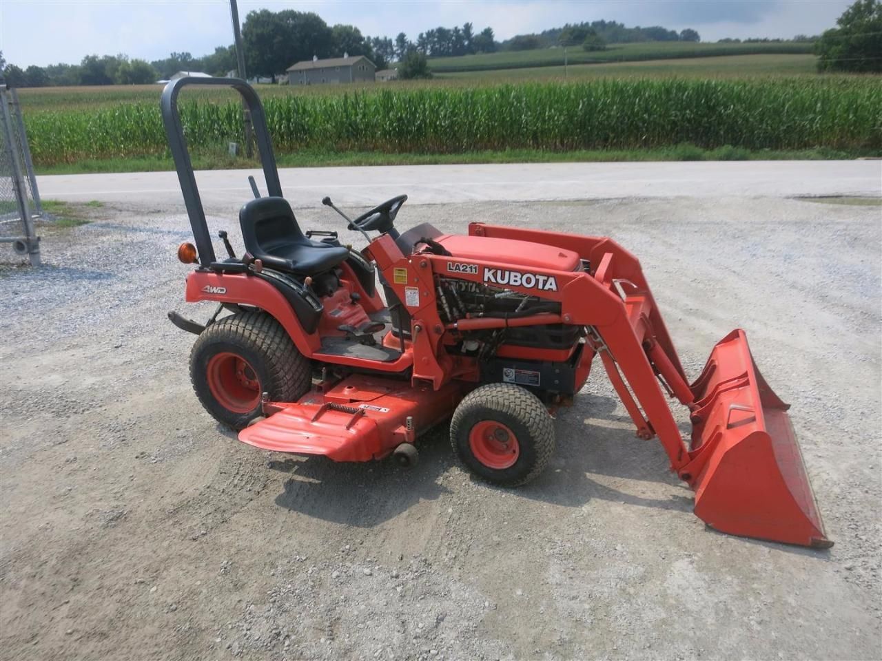

Is this the right tractor for these tasks? There is a 96' x 200' barn on 13 acres. The barn has horse stalls lining either side of the 200 foot length. There are pastures on both sides of the barn. The center, open area of the barn is sand & used as a horse riding arena and needs grading on a regular basis. About 12 horses are housed with regular stall cleaning required. All in all, there are 50 to 70 animals from dogs, cats, pigs, goats, sheep, llama's and horses. The barn sits at the low end of the property so water issues on the sandy barn floor are at times an issue.
The property is utilized as an animal rescue, rehab and sanctuary by a wonderful all volunteer group. They are currently fundraising and have been offered this Ford 345c for $8,500. In your opinions does this tractor have the features necessary to be a efficient barn tractor for the tasks at hand? I believe their will be multiple operators learning to operate a tractor once their is one on site. The Ford 345C's were built between 1988 - 1992. Three cylinder diesel, two wheel drive tractors. I don't know any particulars about this Ford 345c. The barn has no other large power equipment. All tasks are handled by an old riding mower for arena dragging and wheel barrels for transporting manure outside the barn. The tractor needs to be a swiss army knife to handle as many tasks as possible, to include snow plowing & manure spreading. At this stage I'd like to focus the discussion on the Ford 345c capabilities in the barn environment. Size, weight, maneuverability, reliability, part support, features, transmission, etc. Thank you....
Compared to something like this? 2001 Kubota BX2200 4x4 Tractor w Loader 22 HP Hydro 60" Mower 1346 Hrs | eBay
Much easier to maneuver and drive, and probably more capable in your environment.
