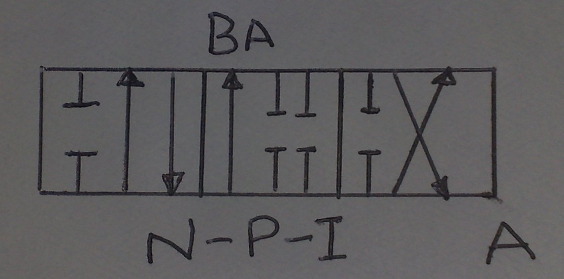

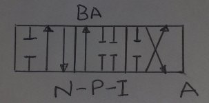

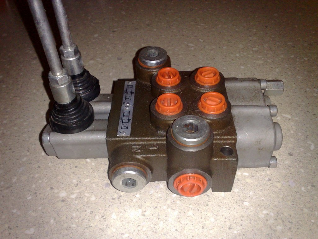

Hi guys,
I bought a pair of spool valves. Can anyone confirm that they are centre-open? The sketch is on a little plate rivetted on each valve.
Cheers!

Quick test is blow compressed air thru "in" and see if it comes "out."
   / Is this "Open Centre"? #3
Chris:
Those hydraulic symbols aren't the standard ones I am familiar with, but they appear to show an open center valve. As Barry said, if it is open center you can easily blow air through the valve from the IN port to the OUT port. Indeed, you can do it with your breath since the center passage should be wide open with the spool centered. Or you can hold the valve with the IN port up and the OUT port down and pour a little oil into the IN port. If it is open center it will quickly run out of the OUT port.

Chris
Watch out ther is now maximum pressure valve .
Be shore wen you mound the valve in a hydraulic system that there is a pressure valve between pump and your valve .

Here's a diagram for a two-function, open-center, manually operated directional control valve stack...
It doesn't seem your diagram is of a open center spool.

Your valve looks fine to me. From the diagram it has a 3rd port that you may want to plug on both sides if you are using regular double acting cylinders.
I find the description "open center" a bit hard to understand except that I guess they mean that the supply side is "open" or really "bypassed". The benefit of this design is that it draws the least amount of power from the pump when idle and generates the least heat in the hydraulic circut. It also means that the whole system should run quieter when idle. The system pressure is ultimately determined by the actual load applied, up to the limit set by the pressure regulator. Any time the load requires less force than set by the pressure regulator, system pressure will be less than the limit.
