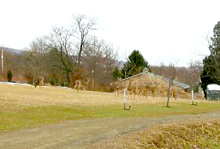

photo 1 - These deer have seen kiotis before.

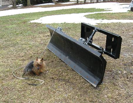

photo 2 - Pit Yorkie guarding the New front end plow/blade

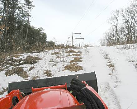

photo 3 - New loaded down CK 27 HST Tractor on incline - H range did not work here - No noises about 1800 to 2000 rpms

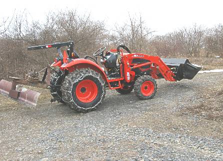

photo 4 - Not able to get up to the wood today :)
