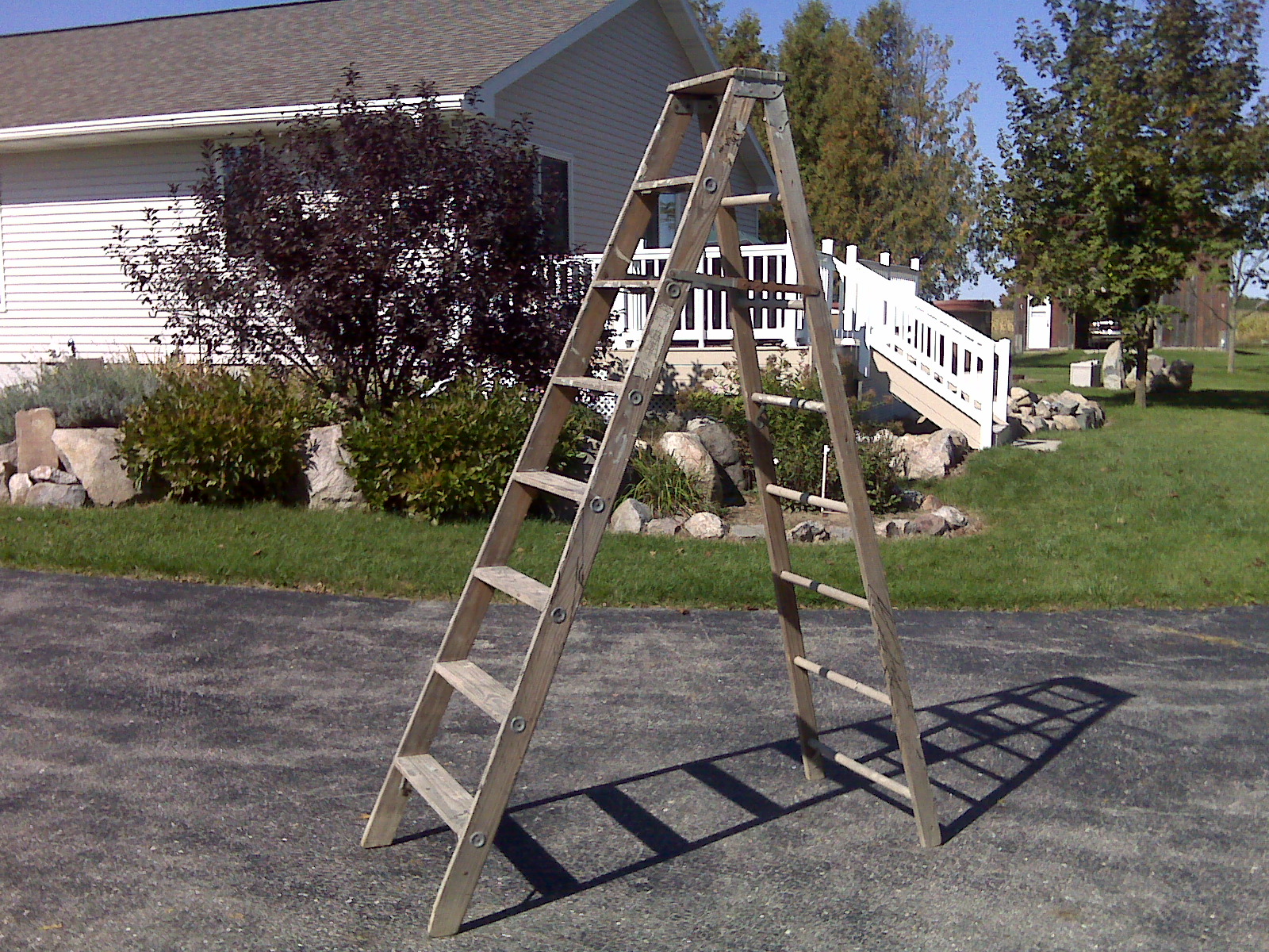

Climbed it higher than I usually do today, and jumped up and down on the rungs, no wiggle at all...and just to be safe, I had THIS ladder shown in the attachments leaning against the same wall, next to me, just in case my repaired one failed and I needed a safe way to get down....
10 foot wood Industrial rated Holland, never been wet, no damage at all except for general dirt, no cracks....I am SURE it has to be safe....yeah, right....:laughing:
I think I'd rather use the repaired fiberglass one than the wooden one. If you feel safe with it then it's your neck. :D
I have to say I have a fiberglass ladder that has a similar crack that I've never repaired but I still use the ladder for some light tasks. :ashamed:
I have NEVER used that wood ladder, just dug it out of the barn to take pics so I could be a smarta-- here. To be honest, I think my uncle left it here back in '89 and never came back for it.
I would trust the fiberglass ladder up to it's 12 foot length. even though I don't really like or should say don't have much experience with fiberglass ladders, except 6 foot step ladder I carry on the truck daily.
That wood step ladder must be loose as a goose if it's been inside and dry for so long. looks like a good ladder just tighten up all the strut nuts etc.
Nothing wrong with a wood step ladder, I've got an 8 footer in great shape after 28 years. My first 40 footer was a hand me down wood ladder :eek: it was heavy but felt solid, not sure I would use a 40 foot wood ladder now though.
