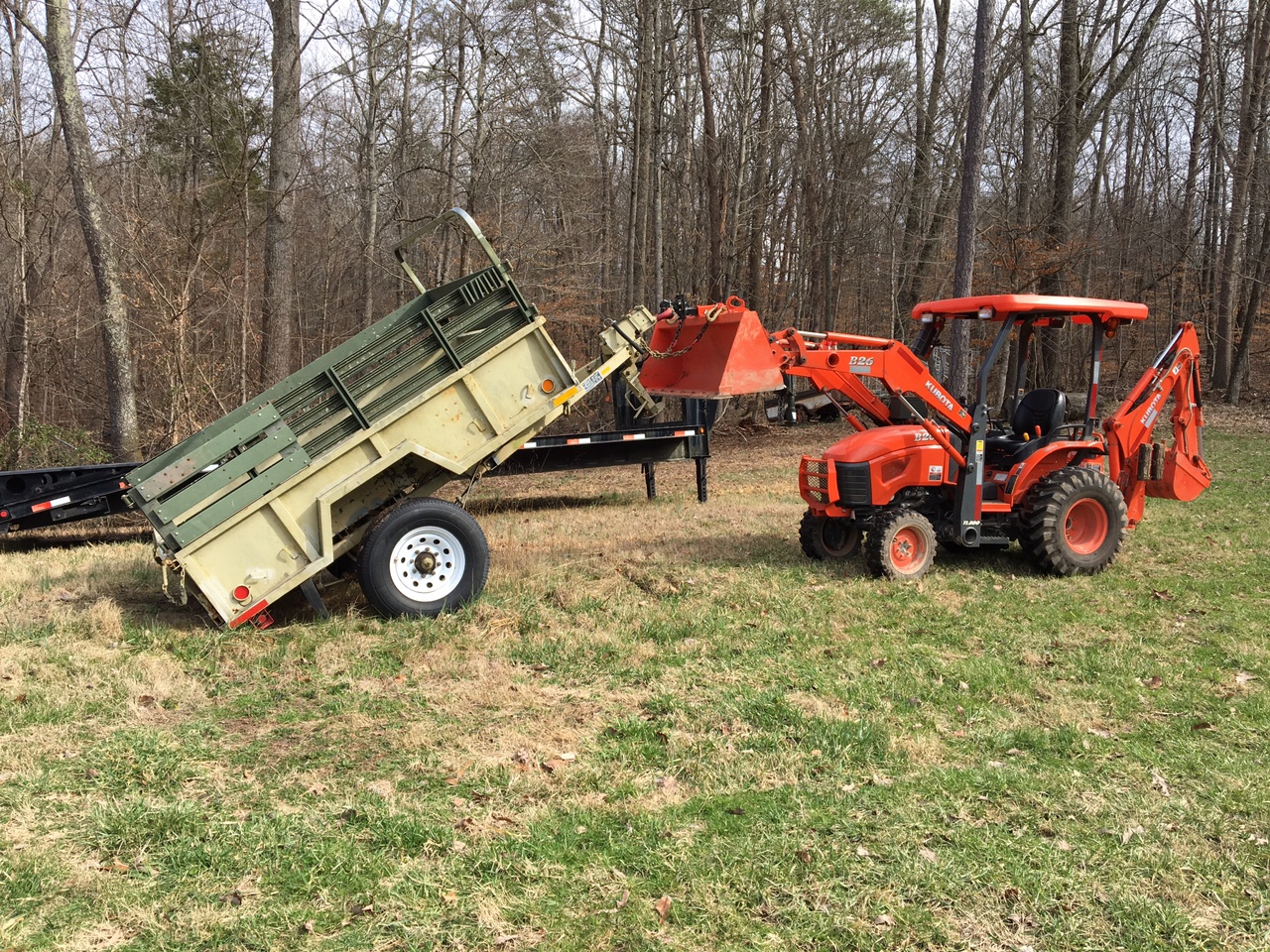

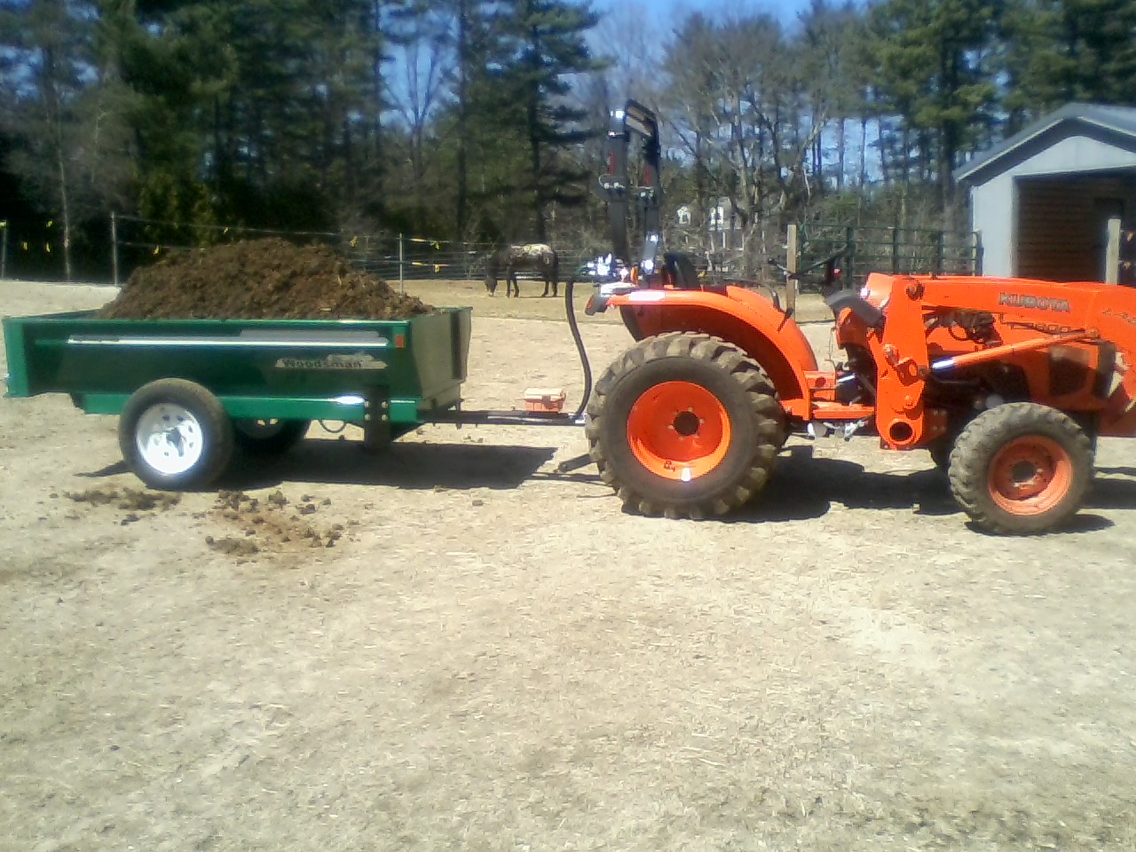

Can really get into tight places pushing a trailer. Military trailer works good for bucket receiver hitch on both B20 and B26. Also move log splitter.
If your B21 has a ssqa a FEL hitch mount plate might be a option for your car hauler. Titan makes a bucket bottom clamp on receiver I picked up in Memphis. Don’t know if I would trust a clamp on, but don’t know your application.

Most drawbars are too low for good trailer handling. I made a clamp on receiver hitch for my FEL. I find pushing trailers to be better for maneuvering in tight spots. Got the idea watching lot boys at an RV dealer moving trailers that way with a forklift. On the FEL you are looking straight ahead to where you are going, and tight turns are easier. I have never been good at backing trailers with a PU anyway. Never enough practice. Smokey's FEL system is the wrong approach, you need to lock onto a ball hitch.
