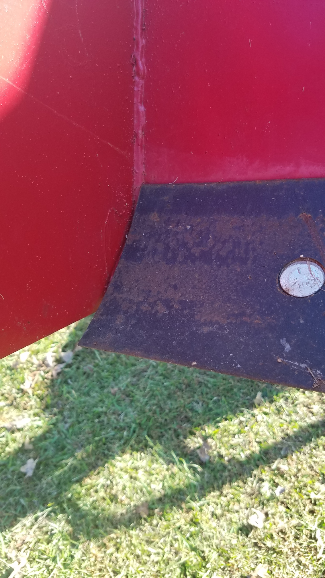

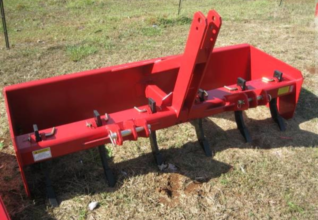

Is this a proper blade for a box blade?
   / Is this a proper blade for a box blade? #11
It looks proper to me, but I don't have the knowledge or experience to know. The price is good on this bb but I don't want a flat bar for a blade, like I'm told the less expensive ones come with.
It's a Lowery branded unit made in Boaz Alabama.
It looks great to me.
Is there anything to be concerned about?
I live in Athens and picked up one of the 4ft Lowery standard models with the reversible edges and 4 scarifiers from Frederick's in Priceville. That one looks like their MT model and it says two reversible cutting edges according to their website. Mine seems pretty well built and I'd imagine that one is even better. The cutting edges are both curved on mine FYI.
   / Is this a proper blade for a box blade? #12
You should be fine, I use an 1100 pound LP HR3584 on my L5740, very similar to your tractor. I also have a LP BB2584 I no longer use as it did not have the weight I needed, but for roads etc. it worked fine.
I have LMC I've bought in the past and they are of decent quality. Cheaper models to avoid do not have replaceable blades.
Thanks for the confirmation.

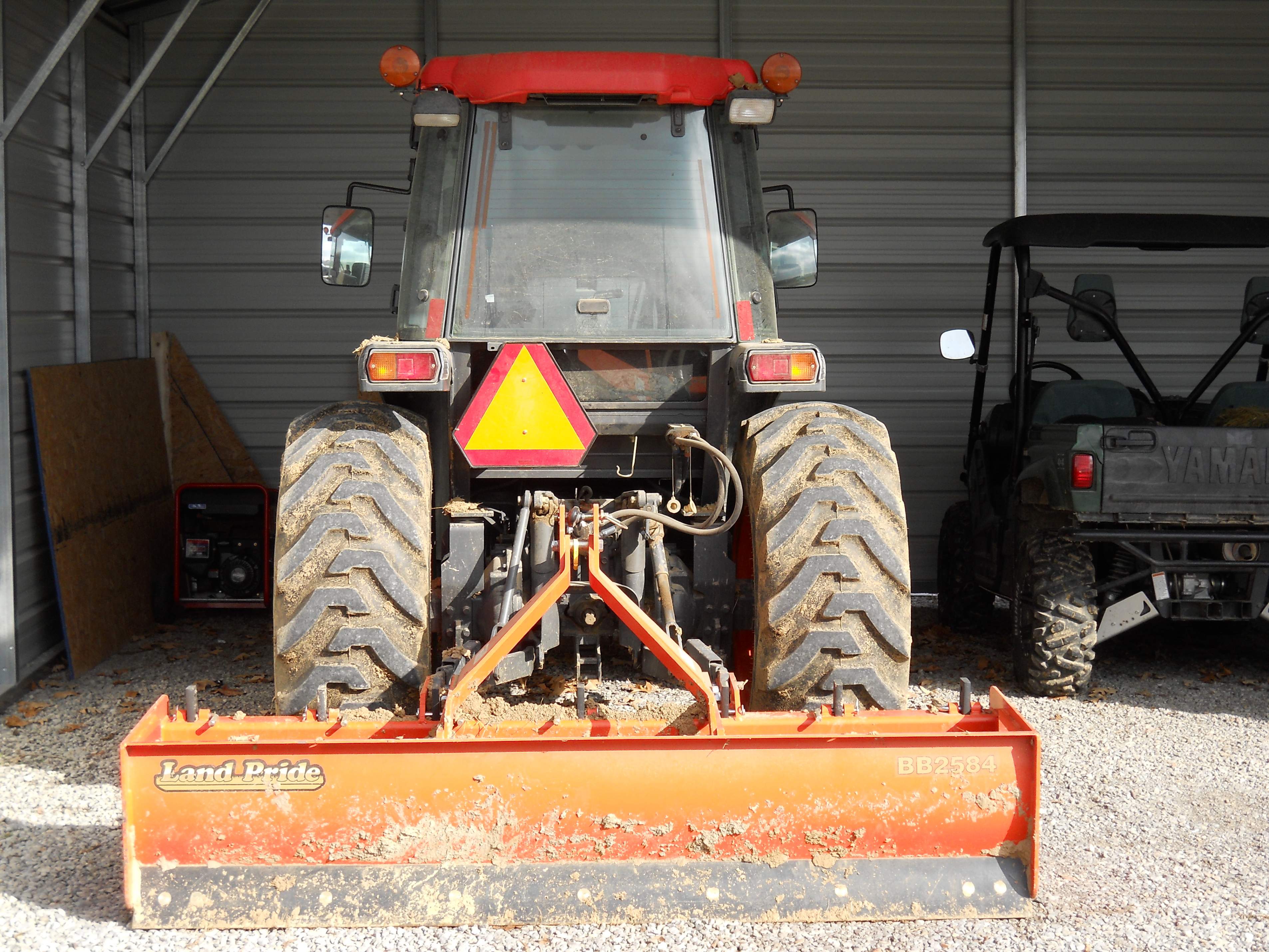

Not heavy enough huh? I want to do a lot of land smoothing in addition to some road maintenance. The land is pot holed up and too rough to walk on in spots. I want to smooth it out and plant grass. Do I need to have heavier?
My preference would be heavier, the one described will do it, it will just take longer, My BB2584 weighed 593 pounds and on our hard clay, when dry it just skipped along the top without scarifiers down. Conventional wisdom is weight is your friend with box scrapers, but there are always exceptions.

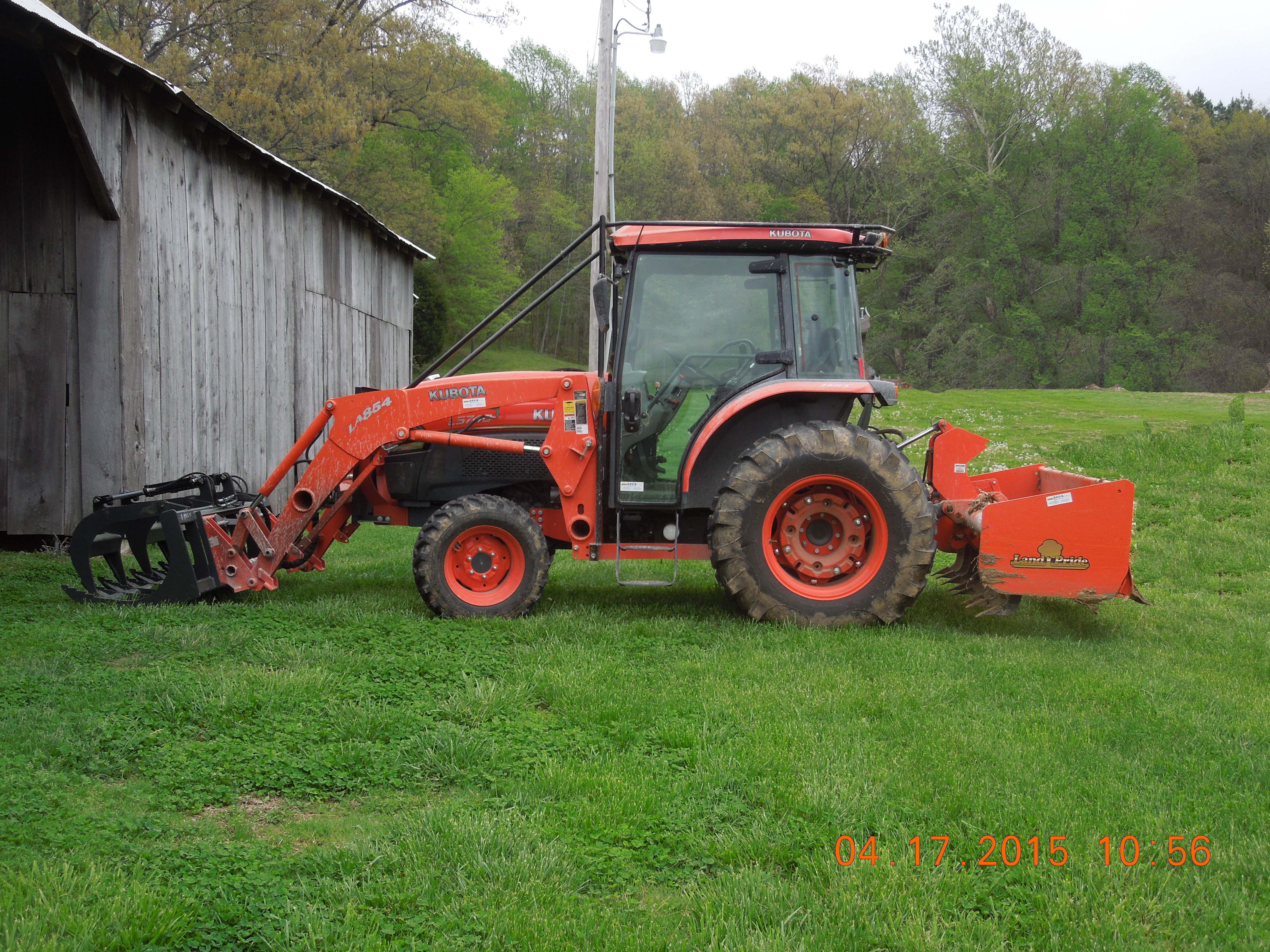

This is the Rhino 950 on my Kubota M6040. View attachment 627828View attachment 627829
When I move large amounts of dirt - I have two options. Use the roll over box blade OR pull the dirt up into large piles with the rear blade -scoop and transport with the bucket on the FEL. I most often use the rear blade and bucket.
It's just too easy to hit a large rock - if I'm digging with the bucket on the FEL and bend/break something. The box blade or rear blade will hit the rock and jump right over it. No damage.
