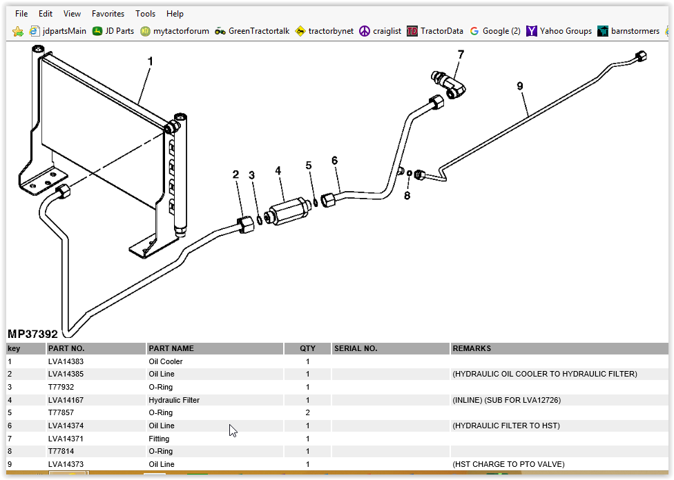

I am looking to add a DIY PB Dual Spool valve on my JD 3203. JD does not make a PB kit.
I am looking for a place to route and connect the "tank" (drain) off of the new spool valve.
I would like to know if this line that comes from the Oil Cooler to the HST is a low pressure line that would be a good place to connect to.

I have worked on a lot of hydraulic systems. But, never a John Deere. Having said that, I always returned into the reservoir itself. A plug on the rear housing, the filler plug. See if you can find where the factory kit returns. Check into whether your unit is open center/closed center. That will dictate what valve is used. Good luck!

I don't know much about JD tractors, last one I drove was a 2 cyl. "multifuel", and the driver was also the "starter" :D
But according to this
TractorData.com John Deere 323 tractor information
it's open center hydraulics, and like most they're split between steering and hydraulics, with separate relief settings - there is NOTHING that suggests that they use the same reservoir as the HST, so I personally would look REAL HARD at what's going on before dumping hydraulic fluid into the transaxle -
On both my older tractors the only option to get more remotes is to find the line that feeds the 3PH, cut it and insert a PB capable aftermarket valve(s), tee the new valve's OUT into the tank return (if it HAS one and you can find it) and hook the PB of the NEW valve into the half of the previously cut line that goes to the 3PH.
My first sentence still stands :confused: but if all else fails maybe this could help... Steve
