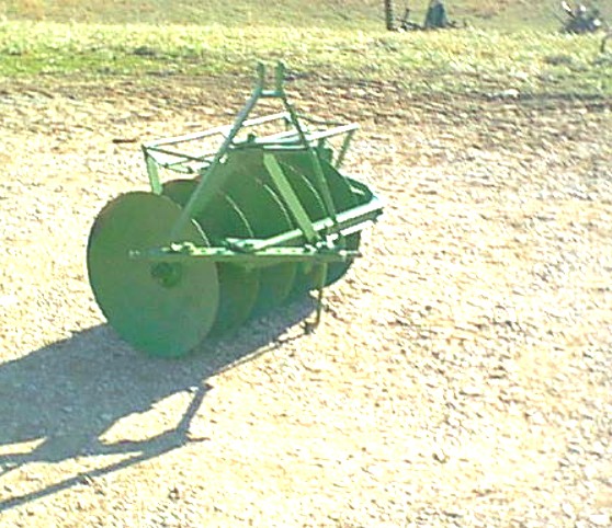

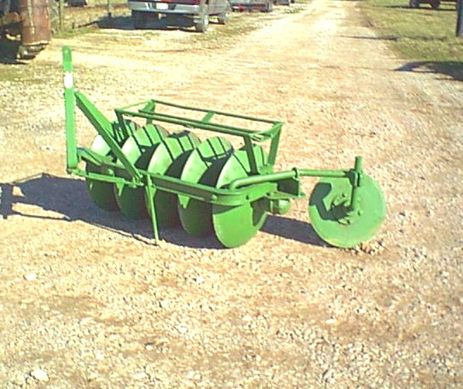

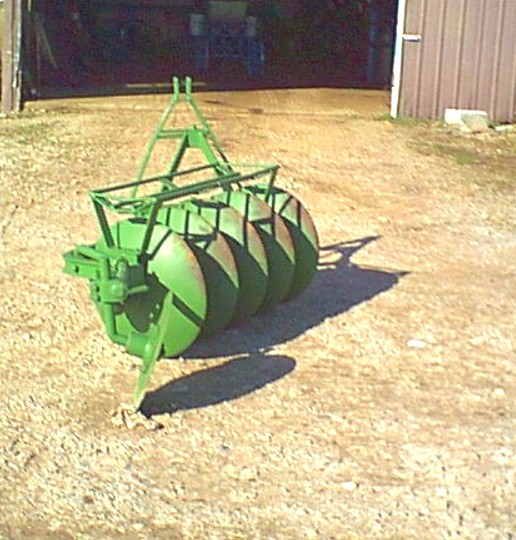

The blades are spaced 5 inches apart and are about 24 inch diameter. Ken Sweet

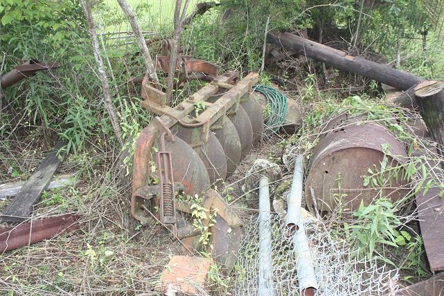

Ken, I have very limited knowledge of the disc tiller but from what I understand it is a rare attachment. If you can see through the clutter, here is a picture of one that belonged to my FIL that hasn't been used for 20-30 years. I have never seen one being used so as for it's intended use, your guess is as good as mine.

It is a Disc Plow searching for nice sandy soil or ridge tillage that needs to worked to flat land after the corn or sugar beets are harvested.
they were or are built extremely heavy to sink in and tear what ever is in front of them.
The high angle of intersection aids in tearing a narrow slit of dirt or sod at one pass.
leonz
/ Is this a disc or a plow? #9
It's called a disc plow, or disc tiller. Ford used to sell them. The 1951 Dearborn Plow brochure I have shows one which looks fairly similar to yours. They called it the Taylor Disc Tiller. They say it's used for terrace building, working in trash, stalks, and stubble, and for turning cover crops. The Taylor disc had four 26" discs spaced 10 inches apart, with a high beam to avoid wadding up of trash, and the furrow wheel at the rear to aid in steering. Also, the high carbon discs are on sealed, opposed, tapered roller bearings riding in an oil bath. 640 lbs. Like a lot of the old equipment of that era it is massively overbuilt - or at least built to last a very long time.

Ken, the implement in your pic is what I've always known as a "disc" turning plow......essentially the same tool as a moldboard with discs as opposed to bottoms for turning the soil.
The second pic, by Egon, is that of a "one-way" disc plow.....very popular in the Plains States from the 1940s-70s for tillage.
The first plow is more of a primary tilling tool while the one-way is/was used more like a tandem disc is today. I've used one-ways and we still own a couple. They were a vast leap in tech during the early days of the mechanization of the North American carm, indeed. But they had obvious drawbacks amongst them being that if, used repeatedly and in the same manner over and over on the same ground, they eventually created a hole out of your field. They turned only in one direction and plowed in one direction only........the cumulative effect over decades were fields with distinctively raised outer portions while the inner portions of the field were sinking as year after year dirt was tossed out from the middle of the field in a circular fashion. We have fields today.....30 years since a plow has touched them......where this is still clearly obvious and apparent.
They're not all bad though. One-way's generally don't require as much HP as the modern equivalent tandem disc to pull.
