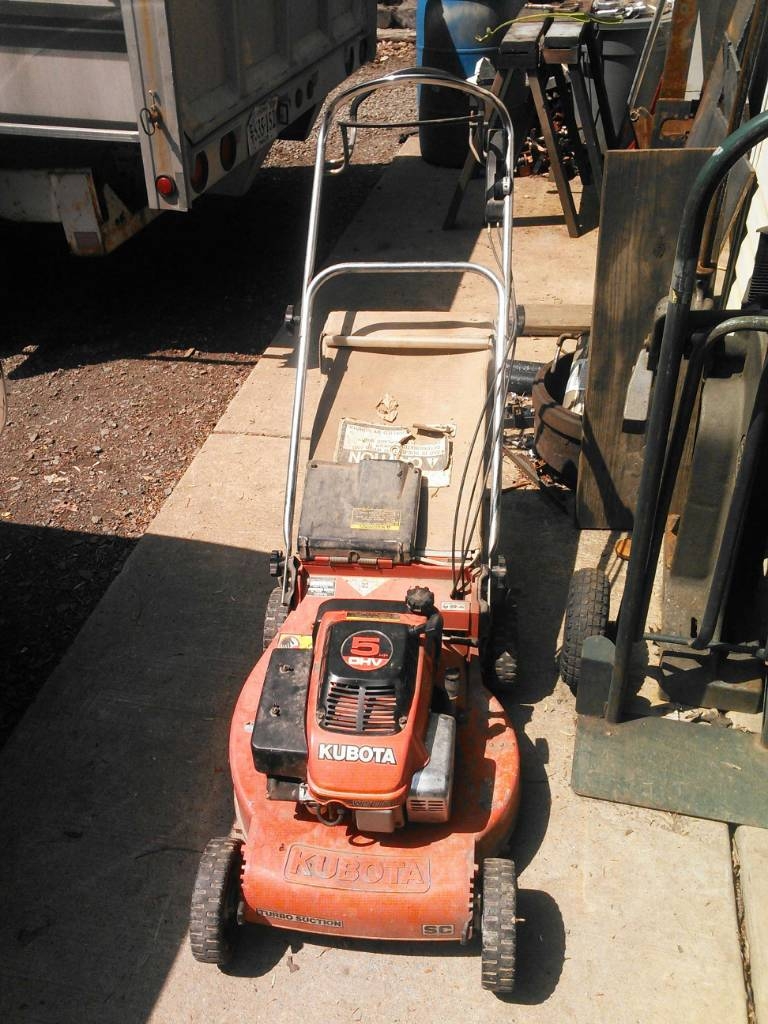

I bought this used in '94, still gets used for trim work, just missing a little paint here and there on the deck, but otherwise still works great!
