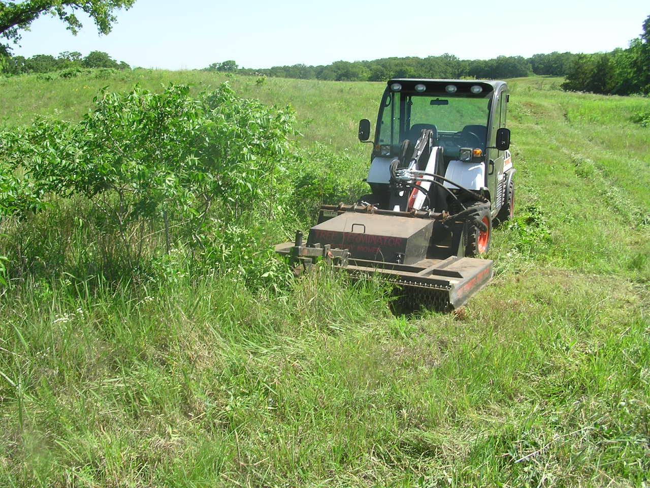

The 7' brush hog is hydraulic driven and does great on uneven ground:
The view from the seat in the air conditioned cab. So nice to have the brush hog out front:

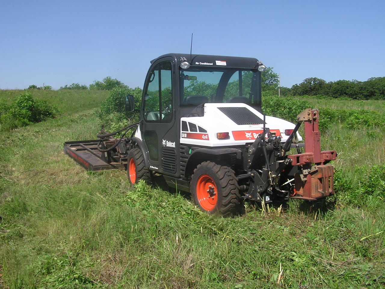

Another advantage of 4 wheel steering is you can set the rear wheels to the desired angle and Crab steer away from or up to something:
I aso offset the rear and go straight with the brush hog offset to keep the cab farther from the trees at the edge of the pasture:
