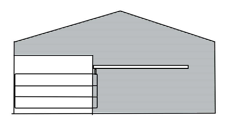

I don't need a full paneled standard barn door. Right now I'm sliding this gate back and forth along the ground. Wondering if any hardware exists to do something like this and make it smoother? I've tried googling it but now that everyone is putting barn doors in their house, that's all the results I get.

Use a barn door rail and one hanger on the inside just above the gate. Lift one end and roll it open or closed.

One of the gates at work is on rollers that are mounted to the posts. The gate doesn't have any wheels on the bottom, just sets of rollers for guides and support. It looks like the sketch under #1 in the link below and the opening is probably 15 feet or more in width.
   / Is there any hardware to slide a tube gate? #10
Bruce
i like this idea. Except I would consider running the rail over the full length up high. Then dropping 2 chains down to the tube gate (one each end). Of course some channel to keep the gate in position when the wind blows, etc. A solid receiver bracket for the left end as well.
