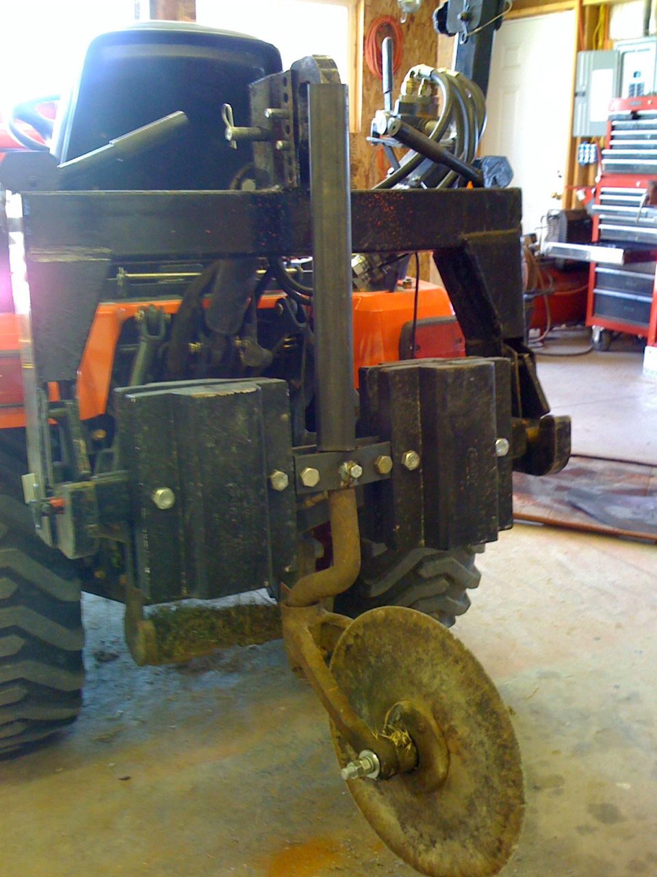

You stated you had a one bottom plow, does it have a coulter?
I built this coulter attachment for creating a straight line when edging my lawn. First cut the lines then use your bucket or even a shovel to remove the sod. I also found that by cutting a line with the coulter first then pulling my ripper through with an irrigation line there is no place that it rips the sod and within one week you cannot ever see where it was buried.
