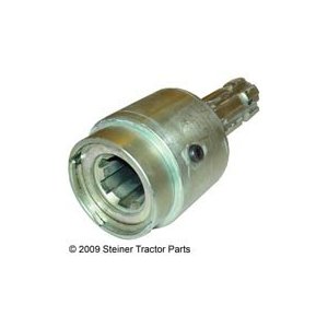

It has an pull up knob on the fender along with the cruise control both factory installed along with the 305 loader, I've tried both ways, no luck. I have a 4 ft Taylor tiller & a 5 ft Big Bee mower. Thanks for all the suggestions. I really like my popping johnnie other than this one issue. Mary

I think that will work just fine. Now I know what it looks like when I stop at Tractor Supply. Some one earlier said that they also have them. Some of the young guys there never been on a tractor. Thanks a lot.
   / Is there an easier way to attach equipment? #15
NO Problem. If you get one, get the type hatc click into place by pulling back the sleeve. Some of them require a pin to be drilled into it...skip that kind. Mine hooks on and off in seconds.

OK will do, easier the better, thanks all. Mary
   / Is there an easier way to attach equipment? #18
If she was to install this would the shaft need to be shortened?
It adds 6" overall to the length. Most shafts can shrink down without cutting. I personally HATE to have to cut a shaft.
#19
The quick hitch adds about that much extra length, so I don't think I'll have to do any cutting. I found I have to raise the mower a little because of the extra length so I can get it on the PTO. My neighbor and worked for over an hour on trying to hitch it up the first time. I stepped back and looked at the angle & when we raised it, it was easier getting on.
