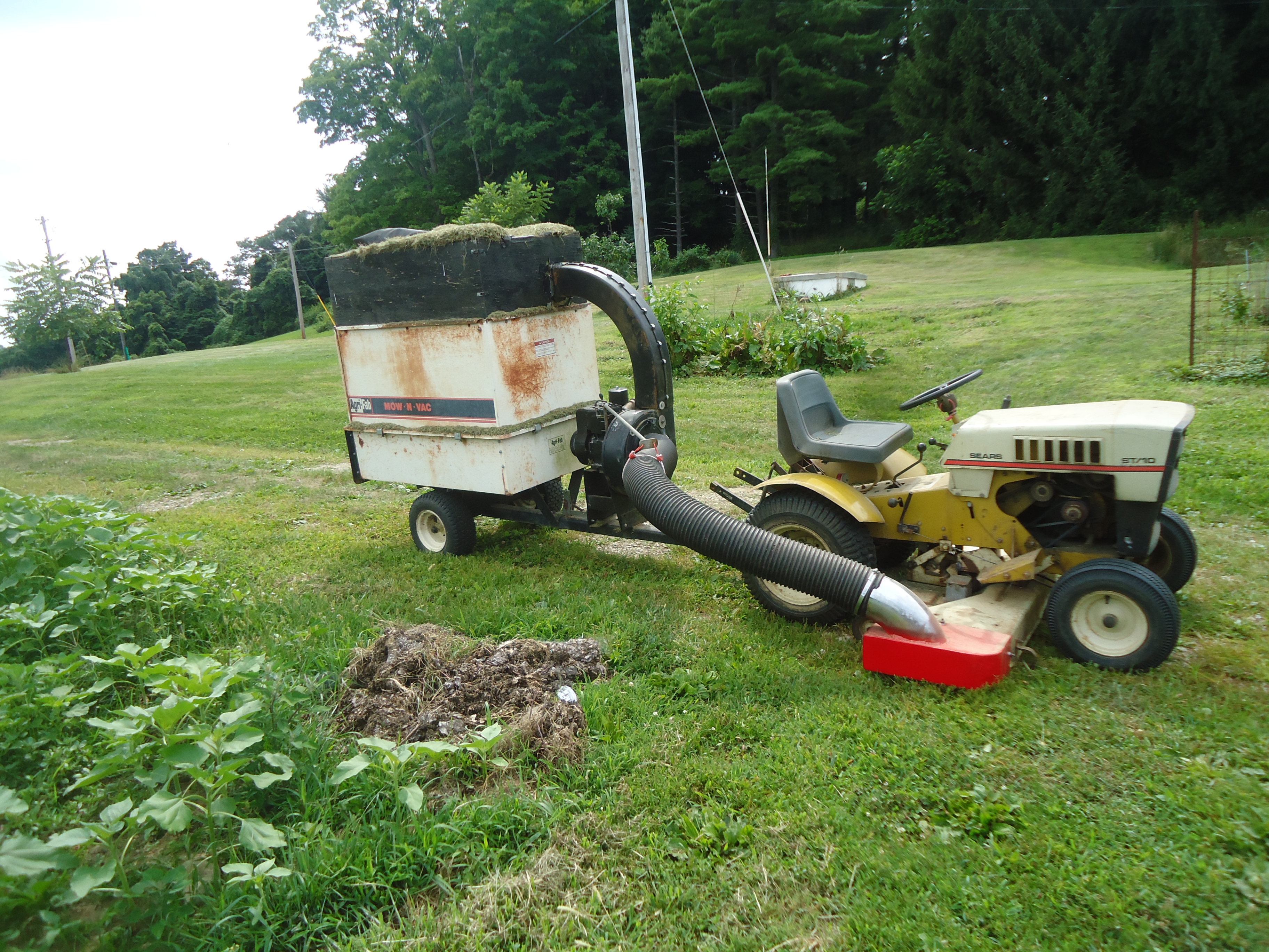

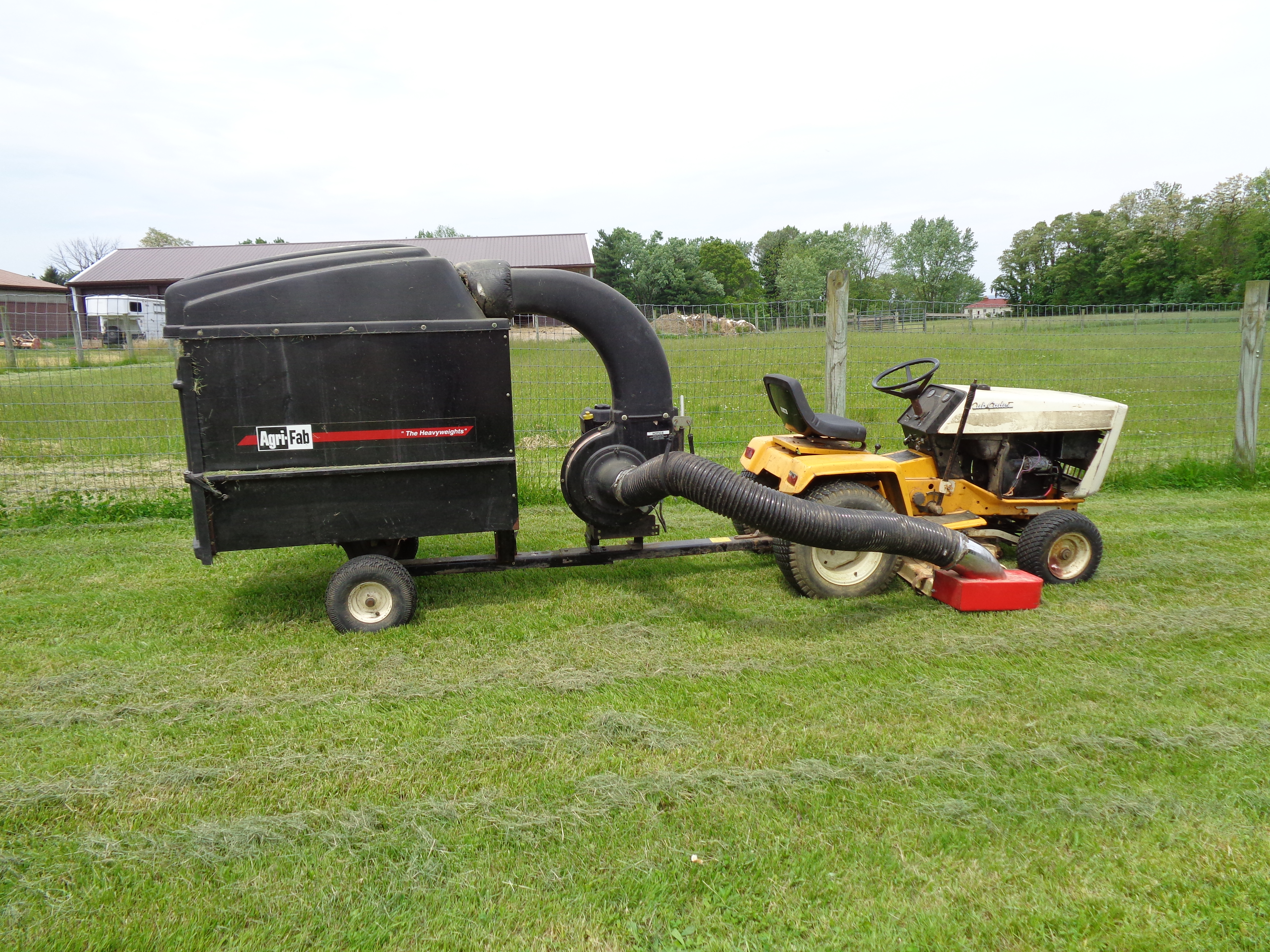

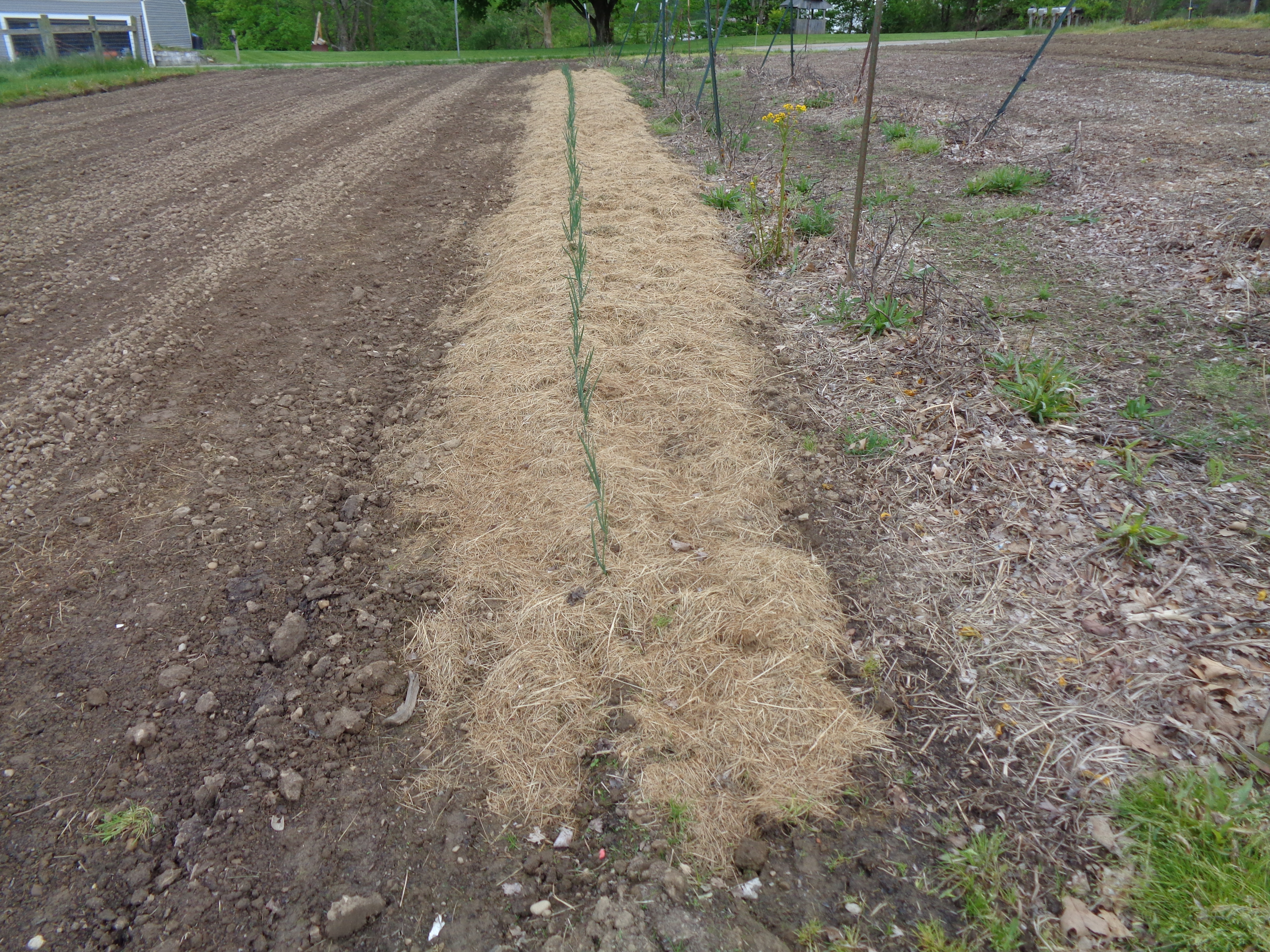

I have 2, Mow & Vacs I use to pick up leaves & grass to use as mulch around plants in my garden. I bought both for $150 ea. The white one the PO couldn't get the gas cap off, got frustrated, and sold it, just to get rid of it. The other one I bought at a consignment sale. It was raining pretty hard, and most of the crowd headed for inside. I was prepared with my long rain proof duster, and umbrella. Just got to be in the right place, at the right time, and deals can be had.
Both ran, and work great. I bought the Cub Cadet also for cheap, did a few repairs, and dedicated it to that Vac. The other one I bought the pickup hosewith handle, to pick up piles of leaves. I have 3,neighbors who live in wooded secluded properties, and loved it 2 years ago when I offered to Vac up their leaves for free, just for the leaves. I also Vac up my lawn grass every week. There is enough to fill that little trailer every week. That is enough mulch to do 1 row across my 90' long garden.
This Spring I mowed, and Vaccuumed up about 3/4 of an acre of newly seeded pasture. It was a little course, and did plug the boot a couple times. I realized I was running too high of RPM's on the tractor, and too fast of ground speed, and was sticking in the boot, faster than the Vac could vaccuum it out. Cut the RPM's, and ground speed, and it worked like a charm.
