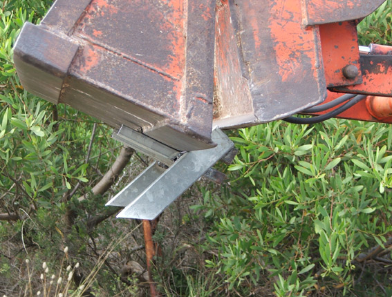

The high spots have to be loosened up first. Attached is simple ripper I knocked together using lightweight fence tube. (You dont always have to fork out heaps for expensive attachments.). As for rocks, you just have to pick them up by hand.
