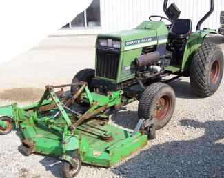

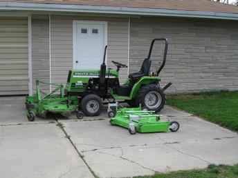

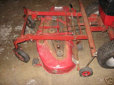

Well, with your front PTO you could maybe attach a mower like one of these, especially if you have some welding/fabrication skills. I've seen photos of european market CUT's (Iseki) with factory finish mowers on the front too. For some reason, they haven't caught on over here.
Bill

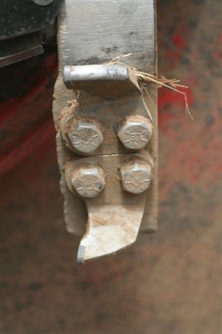

I attached carbide faced stump grinder teeth to the undersides of the blades on a Bush Hog Squealer 48" rotary cutter (3/8" thick blades) three years ago. They cut the stumps off flat and less than 1" high. Have not had a puncture since.
The teeth are available on line from several sources. The attached picture is of the "Tomahawk" brand teeth I started with having a welded carbide tip. They are about $14 each. I have since changed to the new "Greenteeth" brand with a replaceable carbide insert. In either case, the teeth last for many (20 or more) hours of cutting. Rocks can break them, but not always. And the new Greenteeth 1/2'' dia inserts are $4 each and can be turned to give three new cutting edges.
The holes are standard to most brands of teeth: 1 1/2" on center, 5/8" bolts Gr 8 at 250 ft #. Drill the holes in the heat treated (35-45 HRC) blades with a carbide straight bit, $25 or so from McMaster Carr. I use a drill press. It would be very difficult (though perhaps possible) to drill them with a portable drill. I added a 1/2" thick A36 steel backing plate on the upper side of the blade to spread the compressive force of the bolts over a larger area of the blade.
I hit one rock big enough to break the blade back at the blade bolt end, but I have never had a problem with the cutting end where the stump grinder teeth are.
The arrangement in the picture works fine up to about 2" diameter trees. I have changed it recently to work better on trees up to about 4" and if anyone is interested I will try to get some pictures this weekend.
