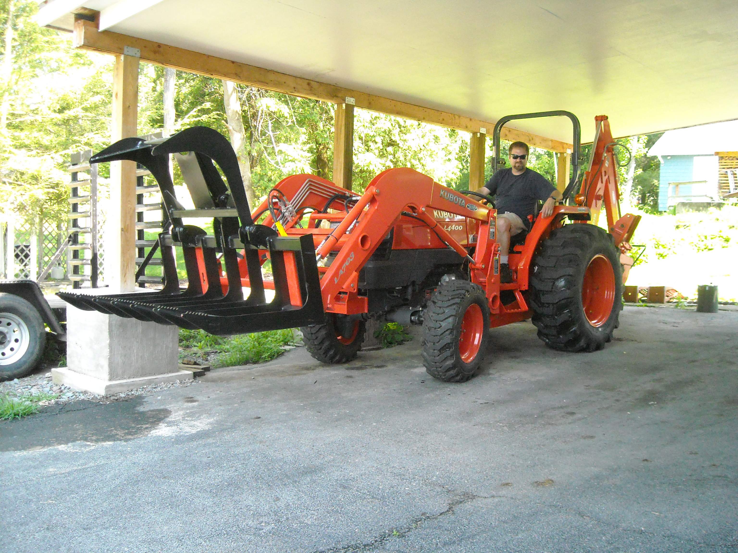

I am starting to build a pond. Trees are cut, bought a grapple for the Tractor, and have been reading Eddie Walkers epic, lake Maribou. I now realize that a small (10,000lbs) or less dozer would be a big help. I need recommendations. I have a Ford 1 ton, with the V10 to haul it with. All comments welcome

that is quite the grapple you have there

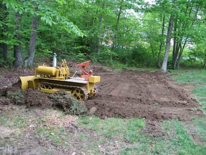

That dozer posted is quite a bit LARGER than the one J.J. has here in Jax. In fact if you remove the seat, it would sit real pretty on that platform. Cute little thing, no doubt.

naw, not a struck, it is a trackmaster, mine at one point even had a backhoe attachement...after finding original owner...some of the newer magnatracs are closer in size..weight on this is prob around a ton or more with all the counterweights. engine is a 12.5 hp single cylinder wisconsin...it is a monster single cylinder
here is engine comin out at time of rebuild
