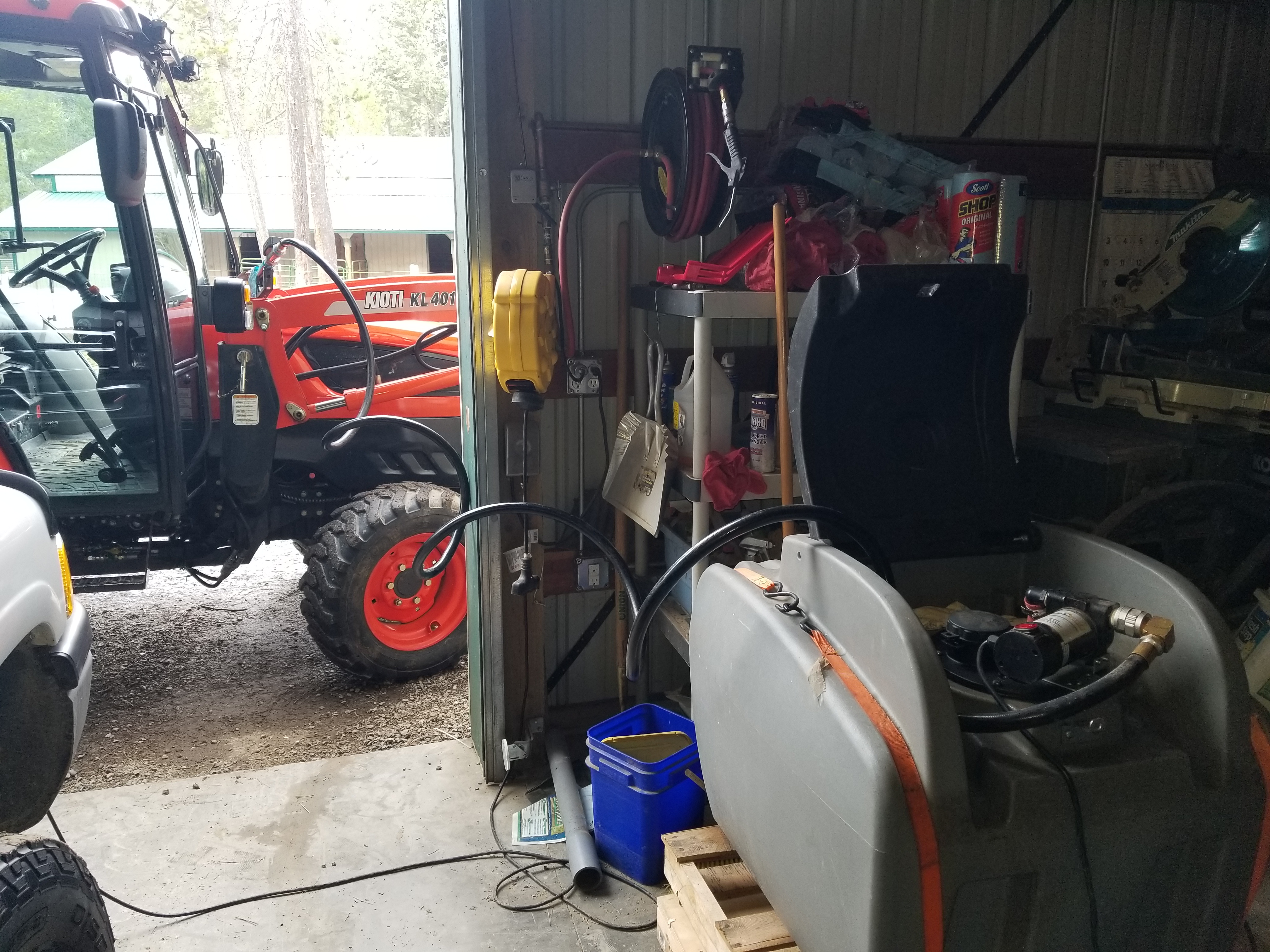

Beats shaker hose or 5 gallon cans. But then again I’m lazy

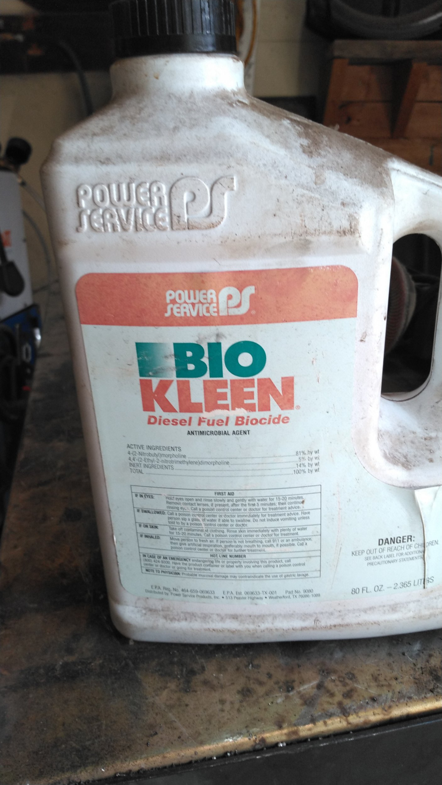

Can I ask why you would add biocide to your diesel fuel? Under what circumstances and frequency?

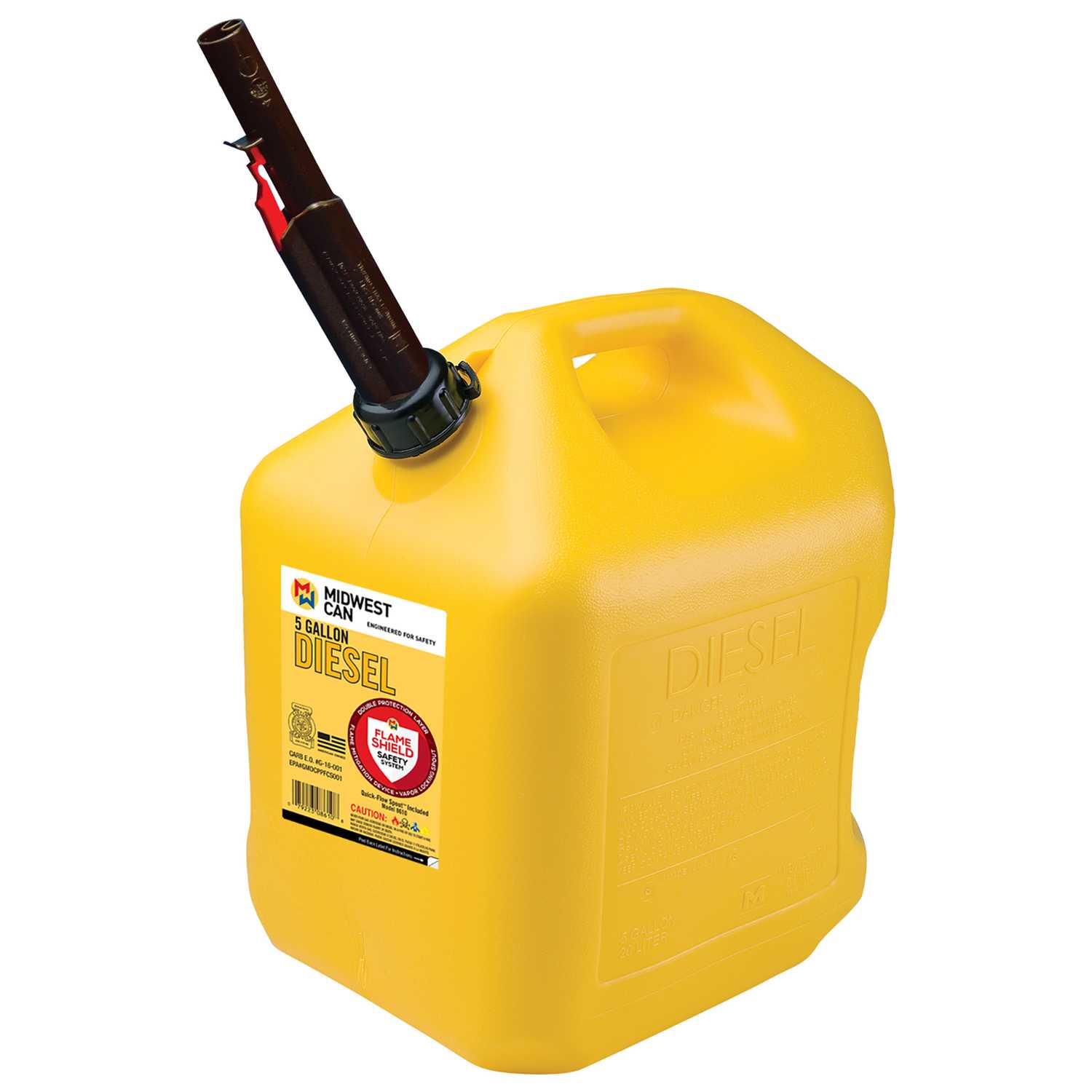

I like those cans!
No offense, but I HATE those cans ! Too slow, takes forever to drain 5 gal. I finally inserted a vent hole cap in my 5 gal cans to let them vent properly, and now I can drain a can in a minute or less.
To prevent algae growth, it's a heck of a lot cheaper and less time consuming than replacing fuel filters and flushing tanks especially if somehow it gets contaminated. I run three diesel powered pieces of equipment and it's convenient to add biocide to one tank verses each piece of equipment separately. Sometimes I'll burn through 35 gallons in a week sometimes it sits for months especially in winter. Bottom line it's inexpensive, somewhat more protected, and I don't have to think about it.

Contaminated fuel caused by condensation, water, etc.

80 ozs one oz per 55 gals to me it's worth it, lol

I fuel my LS and NH TC29 with these 5 gallon gas cans. You put the spout straight down into the tank and rest it on the hood (TC29) or on the exterior fuel tank (LS). The weight of the can rests on the tractor and all I have to do is press a button with my thumb. I added a vent cap so it empties in 60 seconds or so.
