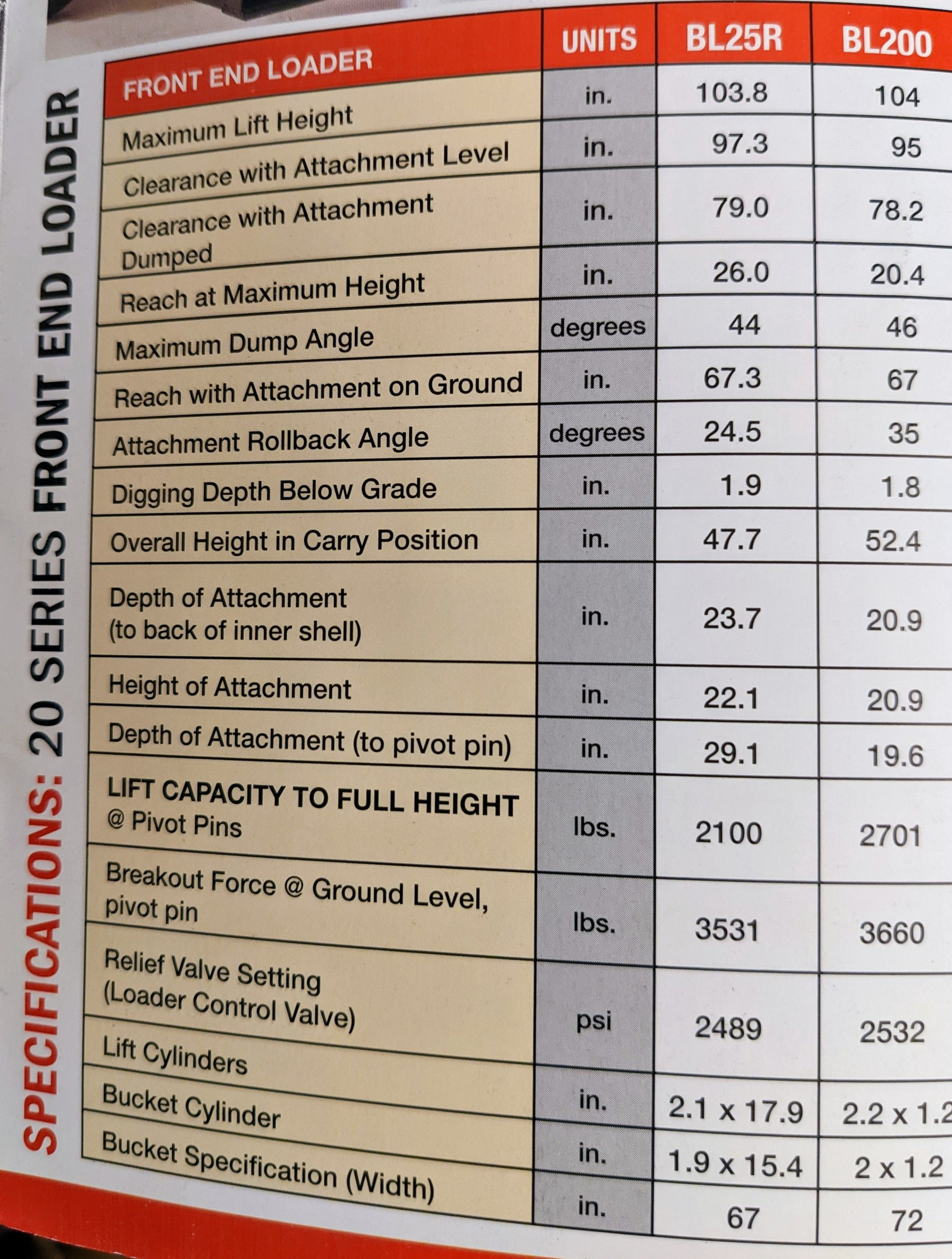

Unless they claimed what hydraulic psi the rating was obtained there’s not much anyone could do. Just crank it up to 4,000 psi for the test and I’m sure most any loader would obtain rated specs. They’re also rating the loaders capacity. They never actually said the tractor it’s mounted on can handle the load without flipping. Lots of ratings are less than truthful. Air compressors and shop vacuums using peak hp vs continuous hp, wood splitters using max rated psi vs actual supplied psi to rate tonnage and trucks using the best possible configuration to rate towing capacity would be a few examples I can think of.
In Branson's case I think they do give the pressure
here is a page from the 20 series and has both the BL 200 and the earlier BL 25 FEL specs. The BL 200 does have a pressure change and different cylinders and other changes

I find it interesting that when some folks see how much difference in load capacity "Brand X" has vs. "Brand Y", the only conclusion they can come to is that the stats are wrong and the test has been faked.
The numbers are real guys.
I'm not one that believes the numbers are faked.
But they are not tested either.
It's a simple mathematical calculation the engineers do.
Cylinder diameter is knows. Cylinder mounting angle is known. Hydraulic relief pressure is known. And loader weight is known.
It's just a calculation.
The dispute is whether a tractor can actually take advantage of such a powerful loader in a small package.
I could put 4" lift cylinders on my MX and give a calculated lift capacity of over 8000lbs most likely. The question is would I ever be able to use it? Would I ever be able to put enough weight on the @$$ to lift anywhere close to the calculated/rated capacity.
So when one manufacture goes so far above and beyond the rest of the field in lift capacities.....it shows they are catering to those that only look at paper specs and not those who understand the machines limitations in the real world.
The tractor in question.....a short wheelbase, 2900lb, 25 hp machine with a loader spec'd that most manufactures put on a machine that weighs 30% more, is 15-20% longer, and 50%+ more HP.

Either I didn't explain myself clearly, or you're avoiding the question.
1) The kinematic linkages for lift (not roll back - we aren't discussing that) are the same. They are a simple 3-bar linkage. Yes, you can move locations around, but the mechanism operates via the same principle.
2) That principle is, generally speaking within the range of parameters seen on tractors, the highest lift force will be at the ground, with the lowest at the maximum height (exactly as shown in the diagram you included).
3) My original contention was that if loader A has higher lift force than loader B at the same lift height, then it was going to be able to lift more at all heights. You disputed this. I agreed that this could happen in theory, but within the current models of loaders being discussed, did not occur.
4) I then asked you to show me any two loaders (let's call them A and B), where loader A has a higher lift capacity than B at maximum height, but loader B has higher maximum lift than A at the ground (i.e., breakout). You instead included an attachment of you Kubota loader with handwritten notes that answered nothing.
