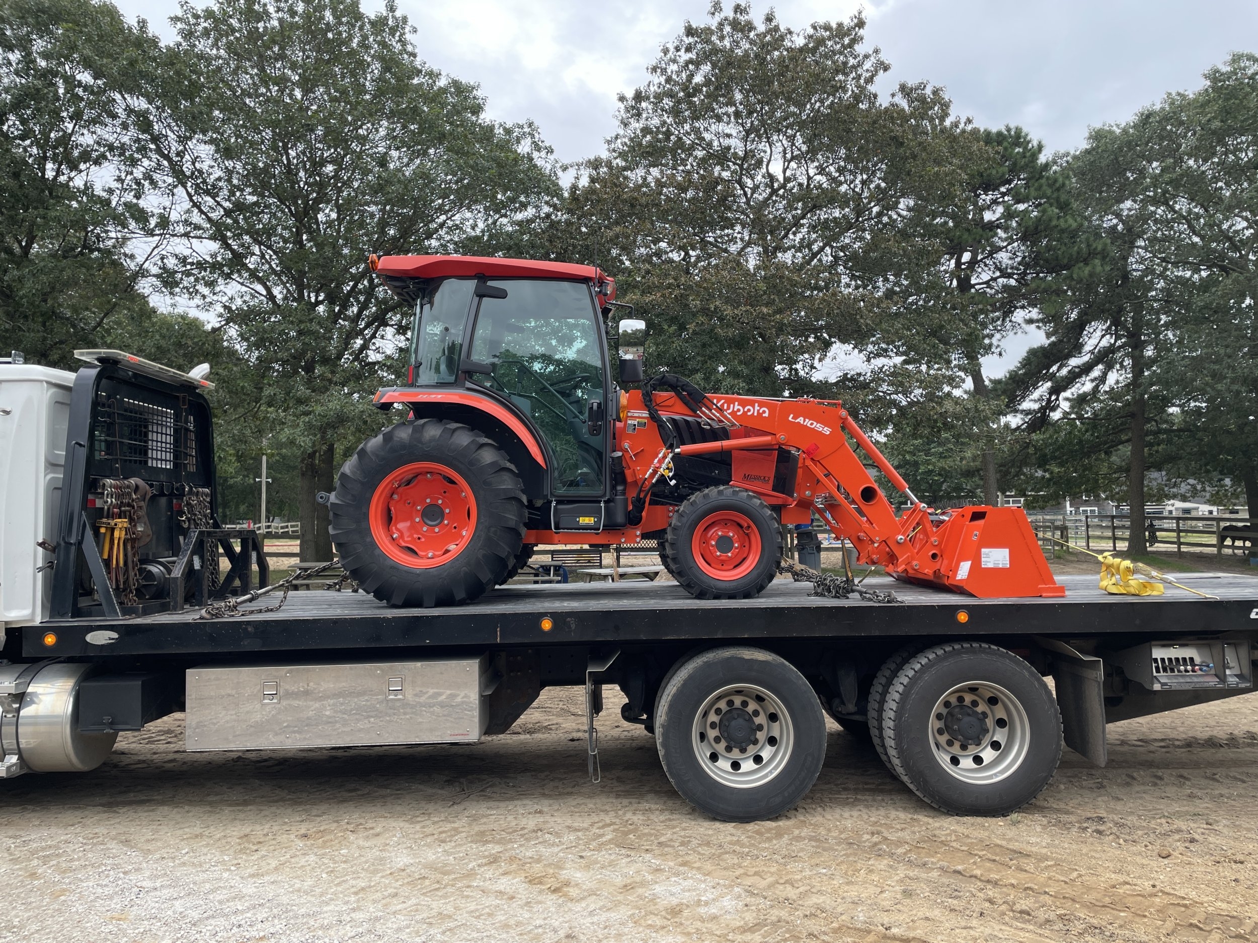

I just wanted to thank everyone for their input. My brand new 2023 Grand L6060 arrived yesterday. The 2 rear hydraulics and 3rd function up front are all on backorder, so I will have to install them myself when they come in(I didnt want to wait possibly many months to receive my tractor). I am super impressed with the Auto Throttle Advance feature. Power and travel speed have also exceeded my expectations. Im happy I spent the extra money and went with this over the MX6000. I think it will also make operating it more dummy-proof for my worker....if I ever let them use it.

That's awesome! You ought to post up some pictures before it gets too dirty. 🤣

Pictures please. Would like to see it.

It takes a big flatbed to make a Grand L look small.
