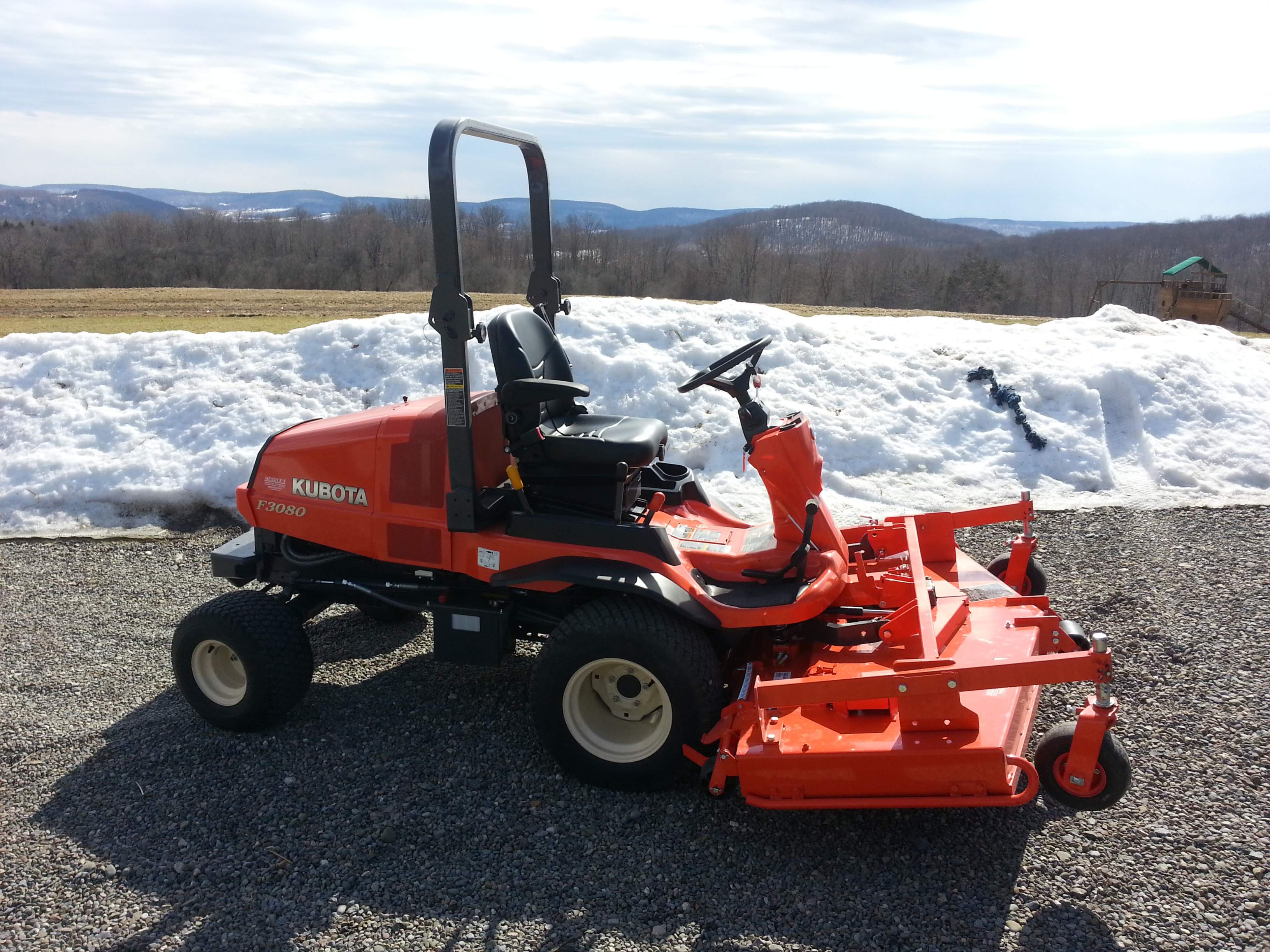

I picked my F3080 with 72" RD deck up today from Messick's. My yard is currently very wet, so I backed it off the trailer, did a few figure 8's in the driveway, and parked it in the garage. One thing I noticed is the HST seems to have a loud "whine," which I hope will quiet down with use. The HST trans on my L5740 is very quiet, so maybe I'm just not used to it. Is this normal, and will it ever quiet down as it breaks in? I'm not sure what HST fluid is used as factory fill, but I plan to use the super udt at the 50 hr break in service. I still have lots of snow that needs to melt away, but I can't wait for the grass to start growing!
   / Is the F3680 still a current model? #20
Congratulations on your new acquisition! I also have an F3080 with 60" side discharge mower and 57" snow blower. I think you are going to be very happy with your choice.
The transmission does have some whine but to be quite honest, I never notice it , especially when running mower or blower. Up here, I always use SUDT and that may also explain why I don't notice it much, that and I usually wear hearing protection when running machine :)
