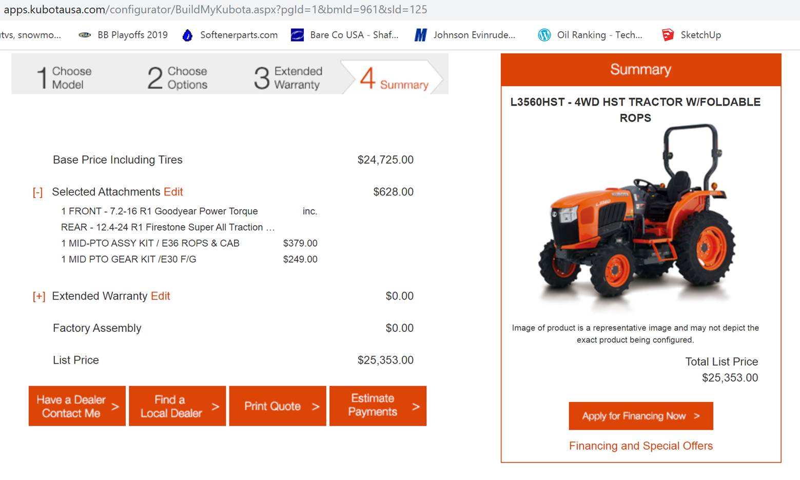

Just priced out a L3560 and L6060 ROPS using "Build My Kubota" option on Kubota.com. Both times the internal gear was added automatically to the price along with the mid PTO. It shows as two separate line items and the tractor overall cost only goes up based on their prices (no adder for dealer installation). No special note or price adder indicating tractor splitting would be necessary to install at selling dealer.
It would be interesting to learn what others encounter who ordered their GL60's with mid PTO. Did they get charged an extra $1,000+ to split their tractor?
The lack of internal gear on the lesser HP GL60's might come as a shocker for those who purchase used in the future. This is a change in configuration philosophy. Earlier lesser HP ROPS Grand 10, 30 and 40 series tractors came with the internal gear. Only the higher HP ROPS didn't come with the gear.

Absolutely certain.
Yes, the Kubota site does indeed add the internal shaft to a ROPS model if a mid PTO is ordered at the same time or if a MMM or front snow blower is ordered at the same time.
That said, a ROPS model ordered without mid PTO is shipped without the internal shaft and gear needed to bolt a mid PTO on subsequently.

Not true.
ROPS model L6060s can be ordered from Kubota with both mid PTO and/or the internal gear and shaft factory installed.
It is only when one has been built without the shaft and gear that the Mid PTO cannot be installed for about $600 without a split.

Ordered tractor with Mid PTO: Internal Gear and mid PTO mounted from factory. (Dealer has no work to perform with respect to mid PTO) Daveinwestmi claims a tractor cannot be ordered this way and the dealer must split and install the internal gear increasing the purchase price due to the long labor hours involved in splitting the tractor and drivetrain.
Tractor on lot and purchaser wants Mid PTO: Two scenarios:
1) Tractor will need to be split to add the internal gear. Purchaser likely to incur the cost of splitting tractor plus parts.
2) Dealer was proactive in ordering tractor with the internal gear (less mid PTO) from the beginning. Mid PTO could be added easily and purchaser doesn't have to pay labor for splitting the tractor, but does incur cost of mid PTO.
Considering the internal gear is $249, it seems reasonable to option the tractor with it in the event mid PTO is desired in the future or to open the potential buyer pull when selling.
