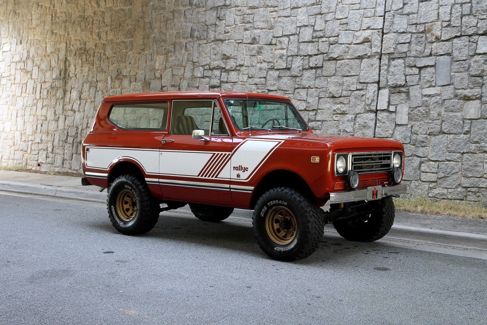

Good luck with that. They never made it with that engine.
I collect Rambler and just looked up the 1960-80 Scout engine choices. They did offer the 232 and 258 AMC six...then I saw the 304 V8!...but not an AMC engine.
   / Is the Cyber Truck a Flop? #494
Learned to drive in one that looked like this: it was dad's comp
any car. He and mom's brother owned an IH dealership. Uncle had the same one but with the white top.
   / Is the Cyber Truck a Flop? #495
My 5th grade teacher was an old Welsh grandmother, who drove a Scout just like the one in that photo. I was only 10 years old, so had no idea just how cool she was, at the time. :D
   / Is the Cyber Truck a Flop? #496
My first truck was an International pickup (1970 IIRC) with the 304 engine in it. Solid engine, though for some reason thermostats didn't last more than a year or so. Theoretically a half ton, but I carried a LOT more in it than that many times!
   / Is the Cyber Truck a Flop? #497
International did some goofy things. I had a Bronco that had been refitted with Dana 60 axles from a 1973 International SUV, and the prior owner had managed to overheat one rear semi floater axle shaft so bad that it softened and distorted at the wheel bearing.
The reason I found was that, in order to avoid the dreaded seepage of diff oil into the rear brake drums, International had designed the axle assembly with a second set of seals inboard of the bearings, such that the bearings never got fed with gear oil from the diff.
Some prior owner had probably done a bearing swap, and not realized that you needed to grease the rear bearings as if they were front wheel bearings.
