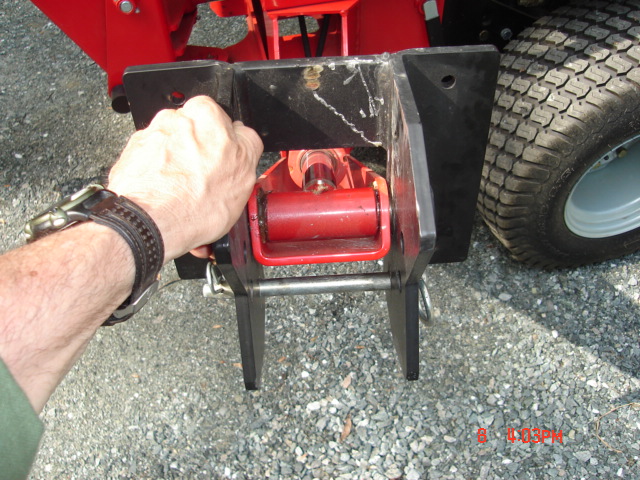

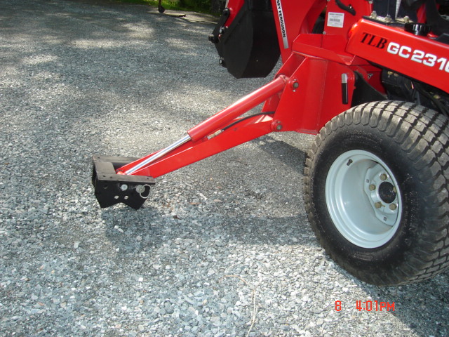

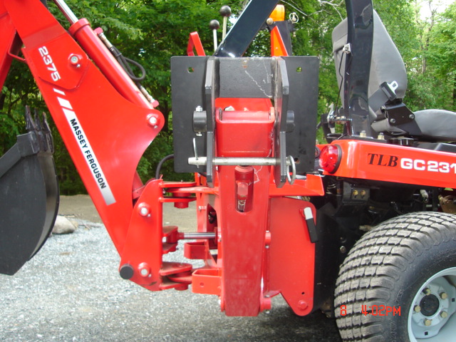

Hey, guys-- Think there's a possibility that maybe jaybrad's 2310 was delivered with the pin not in the "correct" hole to begin with?
Have a look at my pic #3 back a page, and compare to jaybrad's on page one-- in order to work properly, the pin needs to be in the far hole on the side opposite the metal cross-brace piece.
If jaybrad's pin was on the same side as the cross-brace when he got the tractor (as it shows in the photo) and he "put it back in the same hole" after flipping the foot....

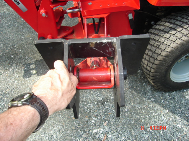

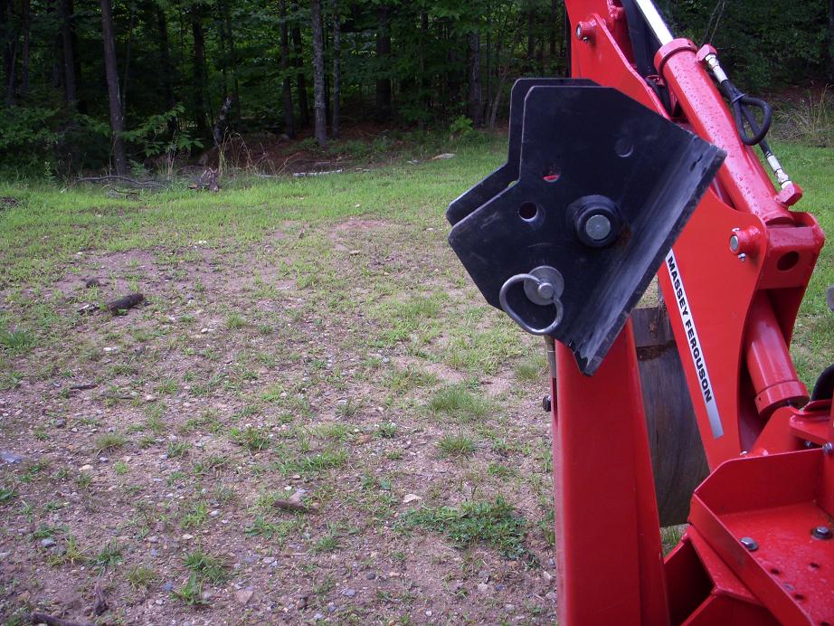

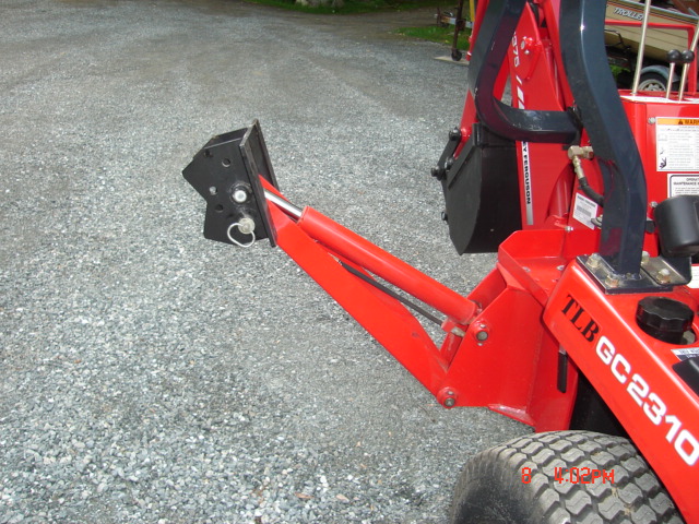

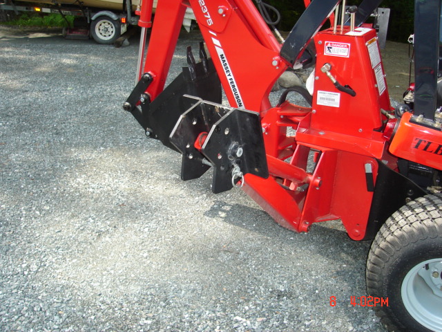

jaybrad, does your foot look like this as you try to flip it? I can't for the life of me figure why it doesn't work-- mine will hold fast until the arm drops, claws dig in to the ground, and the arm lifts the back of the tractor up in the air. :confused:

Sorry, those pictures are almost precisely in the reverse order!:eek:

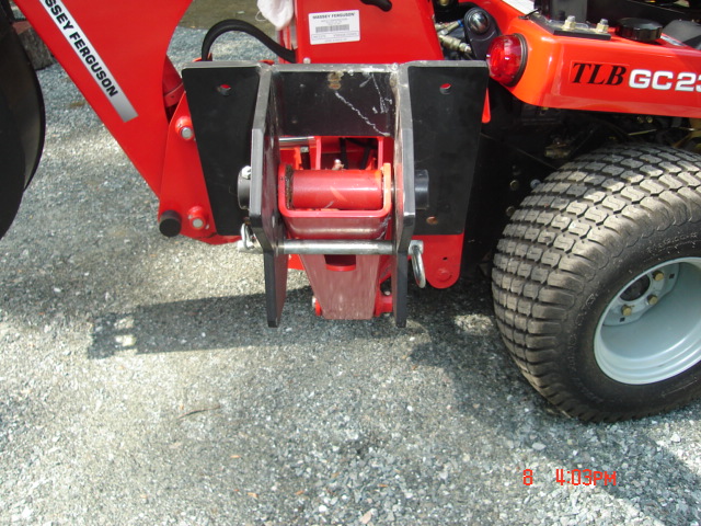

Jaybrad,
Did you ever figure this out? I just read that they are reversible and had one of those "duh" moments.
but, for the life of me I can't figure out how to lock it in the "claw" postion.
Took a couple photo's of the "correct" pin placement (according to some). You can see that the pad still can pivot a good deal with the pin in this spot.
When lowering the stablizer I need to be off the machine and use my foot to level the pad with this configuration.
I have to dismount the machine anyway, to switch the seat around. But doesn't seem like the correct way.

nh_husky_driver said:
Jaybrad,
That's the position where I have the pin, too. Like you, I also have to get off the machine and use my foot to get the claw to bite, or it winds up like your 4th picture, on its side.
It doesn't seem quite right, but since I'm doing this as much for recreation as for work, the minor inconvenience isn't all that bothersome.
All in all, I really like my 2310 - and I just chalk this up as part of the character of the machine. (I say the same thing about the quirks of my motorcycle and car, too.) :D
