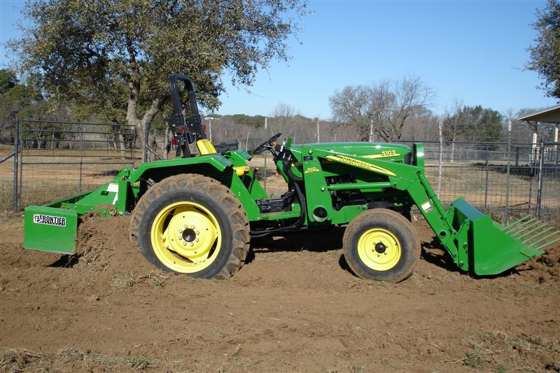

I recently sold a 2007 5103 and will hopefully soon be getting a 4WD 2008 5203. My opinions:
A dream for shredding. Comfortable ride and plenty of power. We had some serious rain and growth this year and I never bogged down. My neighbor had to cross cut his pasture with a Kubota while I just made one pass. In Kubota's defense, he has an older shredder (don't know what brand/model). I have a JD MX-6.
My problem with the tractor: the stock back tire was too narrow and bogged me down...quickly. If you get a 2WD (a great tractor for the price), upgrade to the larger rear ag tires.
I never pulled a disk, but see the attached picture with a 6' box blade. I'd think hard about 4WD for dirt work.
