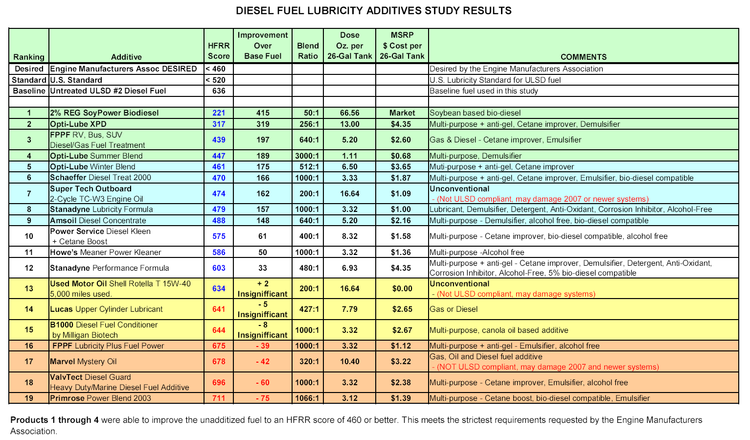

  • Diesel_fuel_additive_test.pdf

Is B2 (2% biodiesel mix) not pretty common now-a-days? Seems it would take care of all the lubricity concerns.

Looks like I'll keep on adding an oz or two of 2-cycle oil per tank and PS at near double concentration (which they say is optional).
Wow. I can see why Marvel Mystery Oil used to be recommended for breakin oil, long ago. It's mildly abrasive!
On the chart, the overall treatment would be the FPPF formula used in bus garages all across the country.
The scoring of 439 is in the good realm, that's about 140 better than PS.
It's made in Buffalo-NY too. (y)
   / Is Power Service Diesel Kleen that good? #17
I'm confused......by the chart in as much as the numbers apply to just certain formulations by any one manufacturer...
e.g. Power Service make the silver bottle (Diesel Clean + cetane boost).....but it has no anti-gel properties.....It is for above 32 deg F Their white bottle has cetane boost and has anti-gel.....It is for below 32 deg F
e.g. Howes Diesel Treat has no cetane boost but has anti-gel.
Those of us who live where summer can be over 100 deg F or below 0 deg F need cetane boost and anti-gel properties....along with lubricity etc.
Some TBN members even say they never add anything to their diesel fuel.
Part of the discussion may depend on the volumes of fuel involved....like in 5 gallon containers for small usage interval....or .....those with high volume usage.
Cheers,
Mike
I'm in the wild extremes of summer 106F at the max and a -27F at the max. So, the best realistic option is the Opti-Lube XPD, but the cost is 3X over PS, yet it works so much better. hmmm.
The saying of, You get what you pay for, applies here.
The Opti-Lube Winter Blend could be the solution for Fall/Winter/Spring. I run bio-diesel in the summer, thus this could be my solution overall.
