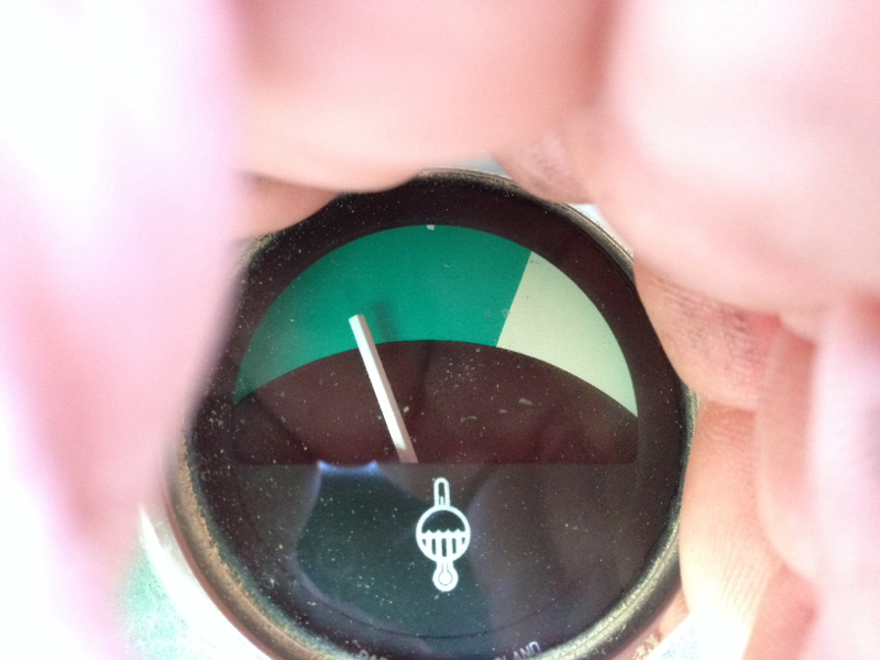

Where does the needle on the temperature gauge supposed to stay at (as long as the tractor is at operating temp. and the radiator is cleaned) when you're bush hogging with the 231 ?
My temp gauge is original. Half of the gauge where the needle reads is "green" (normal operating temperature) and the other part is "white" (meaning it's running on the hot side) and the radiator needs to be cleaned.
For some reason, I'm thinking mine is running more on the "warm" side than it should. I NEVER let the needle get in the "white" because I'm scared that's too hot for it and may blow a head gasket.
CAN I let the needle get in the "white" and still be safe to run the tractor?? If so, HOW FAR can it go over in the white before I need to stop and clean the radiator??
With the radiator cleaned out, while bush hogging (meaning tractor's under load), I'm guessing the needle STAYS about a quarter inch or so from the "white" area of the gauge.

From your post the needle never gets in the white zone.

   / Is my MF 231 running too hot?? #50
Ok I let it run for a very long time and then tilled with cardboard in front of the radiator. I here is a pic of where the needle on the gage was. Plus the ifrared red light readings.. The radiator was like 120 at the top and 80 at the bottom. Could keep my hand on the radiator. Was barely warm at the top and the middle and cold at the bottom. The metal part where water goes into the top of the water pump was like 170-180. The part where the muffler attaches to the exhaust elbow was 203 or 205.
Opened the radiator cap and still no swirling!
Is it running too hot? Should I change the thermostat??
The ONLY reason I thought it was running too hot was when I bush hog for a while in tall thick grass, the needle would gradually get to the white part of the gauge. Then I'd get off and clean the radiator out.
Maybe the needle has to be completely pegged out in the white part of the gauge before it starts to run hot?? I don't know.
Just sitting and idling or letting it run about 1300-1500 RPMs with cardboard in front of radiator, the gauge is in the middle of the green.
Any thoughts or recommendations?
