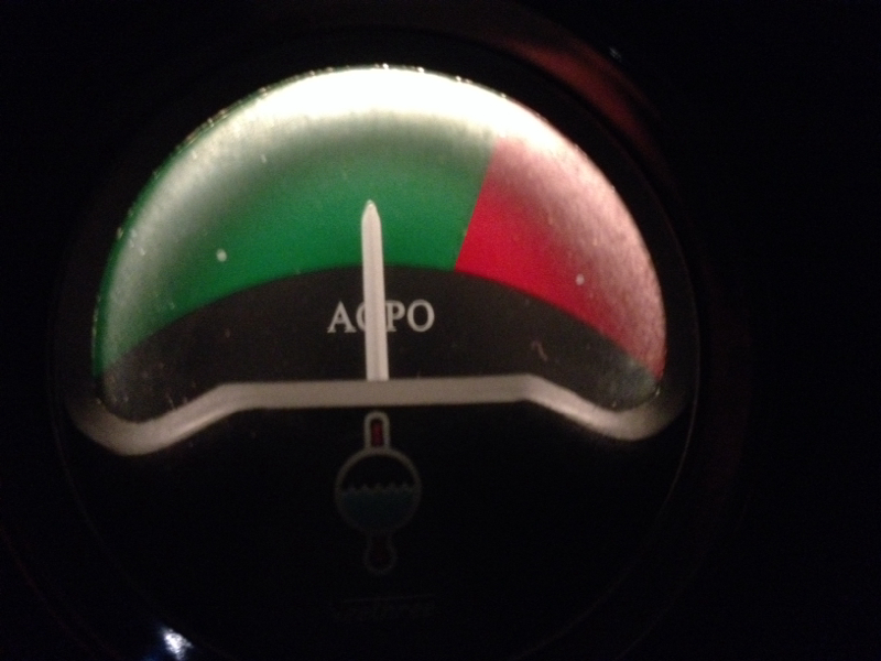

Here is the pic of the new gauge with the original temp sending unit.
Engine high idling @ 1800 RPMs... Thermostat housing temp got as high as about 182-183 using infrared thermometer. Wouldn't get any higher.
Look at how the needle isn't too far from the red. BUT... Look at the small dot in the green and the small dot in the red THEN look at the needle between the 2 dots.
The mechanic told me I needed to get a temp sending unit that's calibrated with the new gauge.. But he hasn't seen a picture of the new gauge with the engine up to temperature.
We can see the needle is between the "G" and "P" on the gauge, indicating that's where the 180 temp will be.
I do have an OEM Massey (AGCO part) sending unit on the way.
Would/could this make a change in the position of the needle if I install the new sending unit??
Looking for opinions on what to do next. ((If anything)).

I would leave well enough alone. If your engine will not go above 183 deg F your stat is working as it should. Your needle position in the gauge looks good to me. Maybe plug your radiator one more time and see if it goes higher, up towards the red. If so leave it as you have it and keep your extra new parts as spares. Toss the known bad ones.

I do agree Tom.
The only thing I'm gonna do now is try the new temp sending unit (if it's the correct one). There's only 2 reasons I'm trying it.
1) Because I'm curious to see if it'll make any difference in the position of the needle.
2) Because the original sending unit has to be removed anyway to change the little copper sealing washer that seals the sending unit to the engine.
The junk aftermarket one messed up the sealing washer (didn't know I wasn't supposed to put it on) and now there's a tiny leak at the sending unit.
There's always that chance the threads could be messed up inside the housing, but I'm about 99% sure it's the washer.
Looks like I'll be putting the hood back on my 1st Love tomorrow.
Luckily I'm not behind with the garden yet, but it's just about time to plant sweet corn with that sweet Massey!

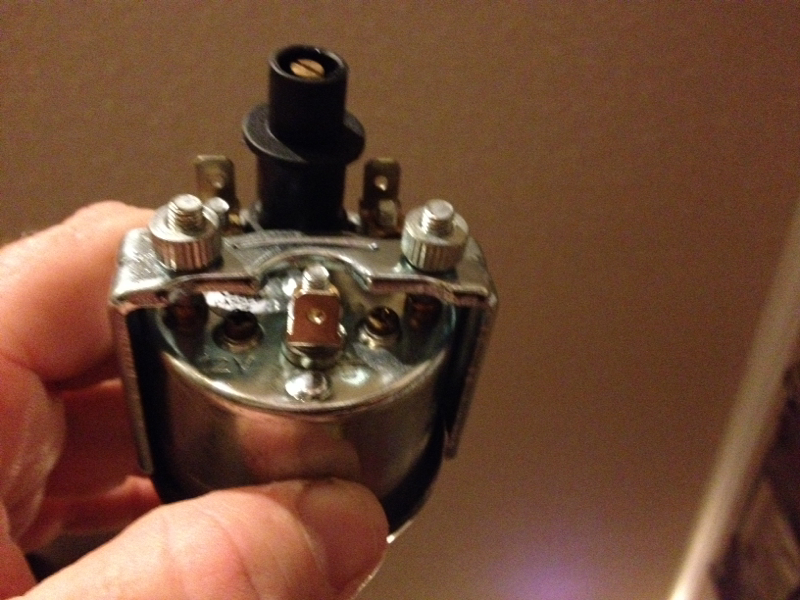

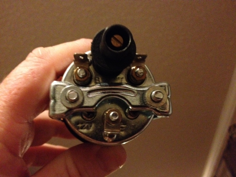

****EDIT****MASSEY 231 OWNERS****
The "flat head/slotted looking screw" on the back of the new temp gauge is NOT an "adjusting" screw. That whole brass piece pulls right out. It's for the backlight bulb socket to plug into.
The bulb socket that came out the old gauge will fit into the new gauge perfect but you have to open up the metal bulb holder on the back of the gauge. It's already split, u just have to open it up very little using a flat screwdriver.
I also used one of the black pieces off the black plastic pieces off the new gauge to help seal the old bulb socket to the new gauge.
The brass screw on the new gauge is there in case you wanted to cut wires to use the bulb socket on the gauge. The screw acts as a clamp to hold the wires in place.
But DO NOT CUT THE WIRES! Like I said, the bulb socket on the old gauge fits just fine.
I think the reason the screw is on the new gauge is because this gauge fits different models other than the 231 and there must be different wiring configurations to the gauge (assuming).
***This may sound difficult and confusing but it is not. If you're ever in this situation and have the parts in front of you, you'll see exactly what I'm referring to.
I believe it was Winmac who posted about the terminals on the new gauge. He was correct...
"B" is for Battery wire, "T" is for Temp Sending Unit wire, and the terminal with the "lines" engraved beside it is for the Ground wire.
Straight forward, very simple, and I do recommend this aftermarket gauge as far as fitment. But I hope it lasts as long as the original gauge.
****The original gauge DOES NOT have terminal markings on the back of it.
