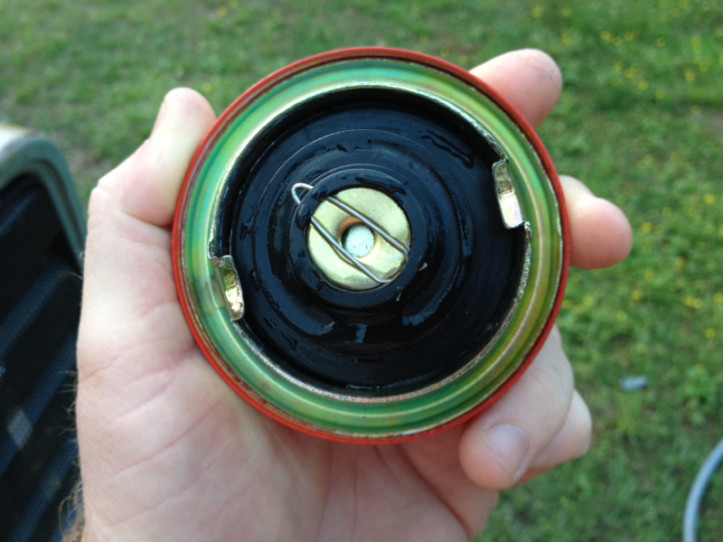

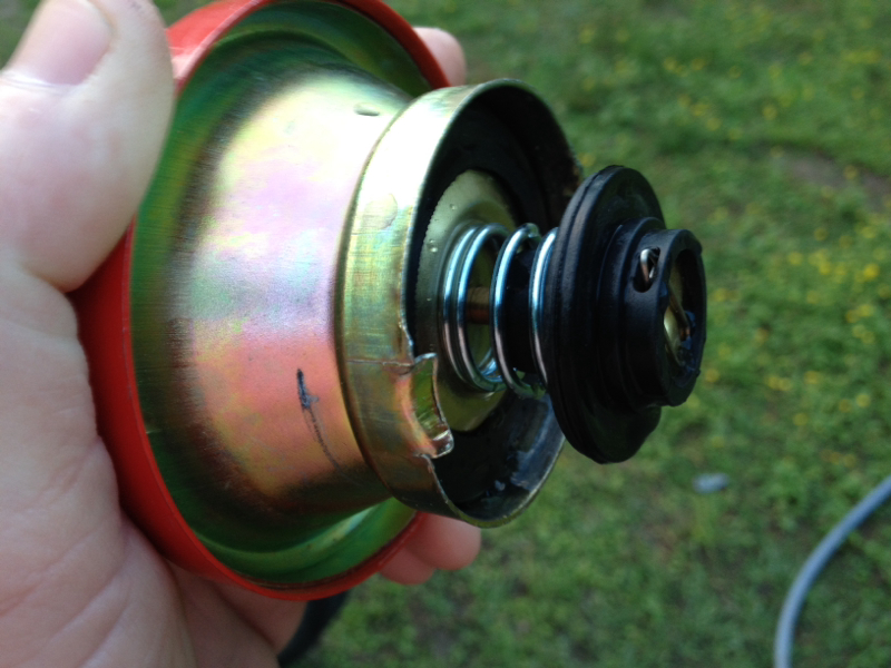

I may be able to explain a couple of the new issues you created, let's see a picture of the underside of the new cap.
   / Is my MF 231 running too hot??
#202
I did create new issues, but whatever it takes to get the cooling system how it's supposed to be. There's no doubt it wasn't right before. I'll get to the bottom of it however long it takes. Done come too far to give up!
Here are the pics...

It's a very odd looking cap... But I suspect that it is designed to hold a vacuum, some are not.
What dose this mean if you had the cap off with hot coolant then reinstalled it and allowed the system to cool. You now have a negative pressure in the system, this will collapse the rad hoses.
Same deal trying to drain the rad with the cap on, you need to allow air in the top before water flows out.
