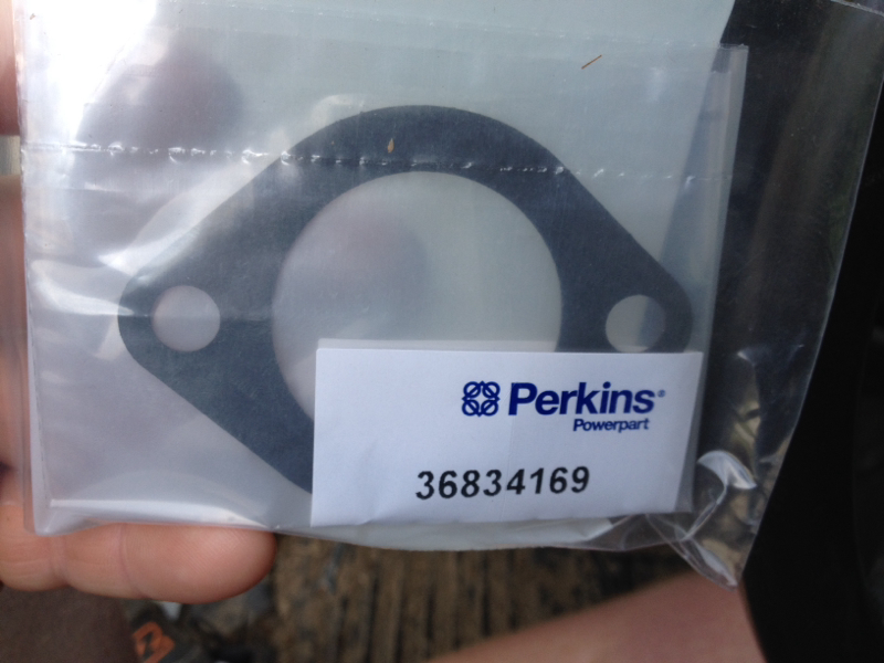

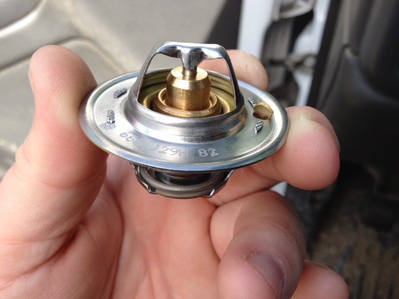

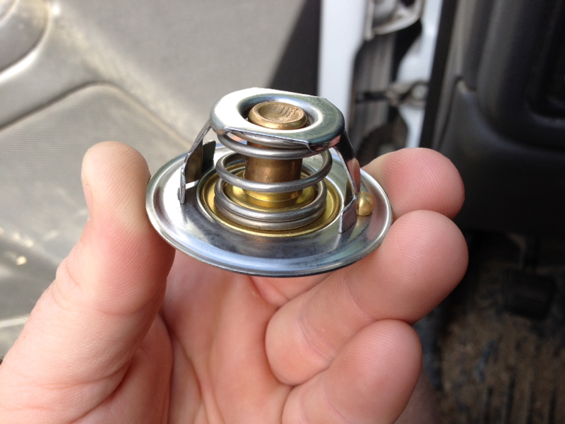

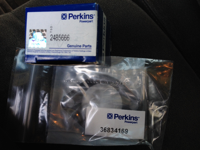

Fixing to install the new 180F thermostat and gasket. They are both Perkins OEM parts.
Man at the Perkins place said the temp sending unit and gauge would have to come from Massey unless I wanted aftermarket. Said the sending unit wasn't available from Perkins.
Right. Perkins just builds the engines, Massey selected the sending unit, gauge instrument cluster, etc.
