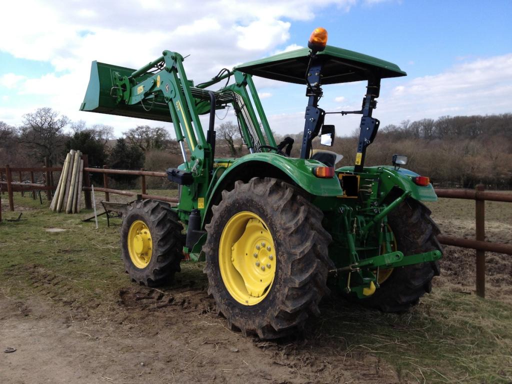

Thanks :) A lot of hard work has gone into it in the last couple of years and it's starting to come together.
The tractor is "Euro spec" so it's a bit different to what you're used to. The front load is a 533 with self levelling and they replaced the standard joystick with the fancier and more ergonomic version. The front tyres were standard. I am pretty sure that they are 320/85 R20 (12.4 R20), but I'll double check tomorrow.
Here are some more pictures
One thing that I forgot to change when I ordered was the standard lift arms with the ball type attachments. They are a pain so I have ordered the telescopic versions. They should be here next week. You can see the pick up hitch which was also an option. It's the best thing ever if you're hooking up trailers or trailed implements.

Did notice that funny "yellow" thing down there where the drawbar is supposed to be.. with the long, vertical stabilizer rods. Interesting. And, from the looks of your tires they appear to be radials and considerably larger than the OEM tire offered in North America.
I think the UK has a better configured 5065e than the US market! :thumbsup:
(That's a good lookin' fence you've got there as well! You do good work.)

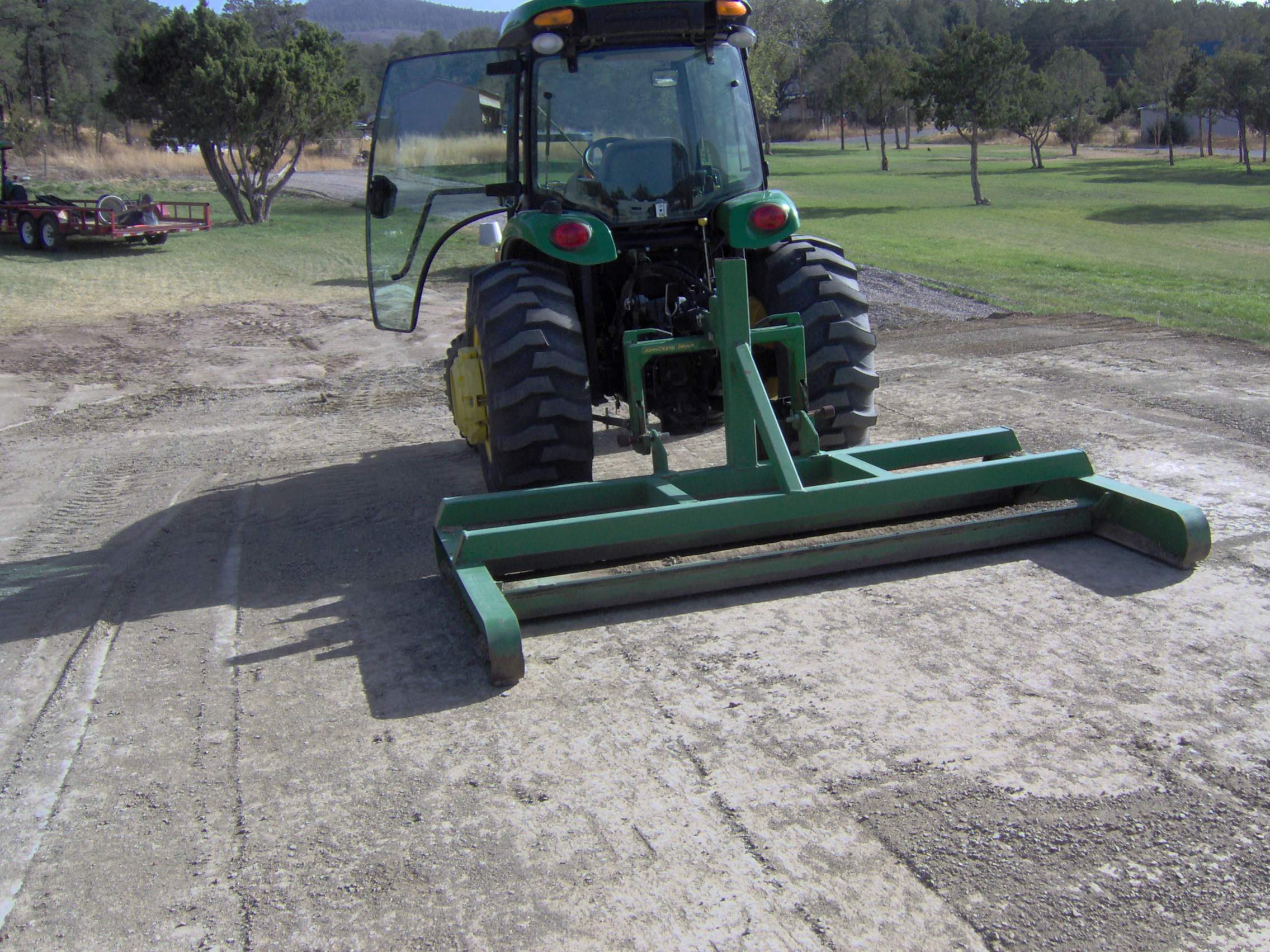

If you are hitting mounds with the blades set at six inch height then you really need to smooth everything up before mowing. Here is a few pics of my landplane scraper with the blades set flush, I think it would do wonders for your pasture mounds. I use mine to smooth up small fields and lawn areas and have had good success with it. I built it to smooth out my own lawn when putting it in back in 2009.

Got a question, though. If you tilt the front edge up (less aggressive cut) doesn't that make the rear blade cut deeper?
I tried with my grading scraper but all it did was skim over the top and not cut down any mounds. Your pasture looks beautiful.

Larry,
If you look at the third picture above you will see that the rear of the skids estends aways behind the rear blade. In tilled ground you can cut more with the rear blade you tilt the plane back, in harder ground it will tend to ride more on the rear skids which will lessen the cutting action. In my experience in both soft and hard ground including pastures and lawn areas the amount of cut is easy to control. For what I use it for the straight blade setup is superior to the angled blades because when you tilt the angled blades it causes them to be out of level as the leading edge is raised higher than the trailing edge. With the straight blade setup you can tilt the blade and still keep the blades paralell with the surface. These planes work well in forward and reverse too I should mention. I think a 10' landplane grader with 6' skids and about 1200 to 1500 lbs would be perfect for you 5075M.
Corey,
If you ride over the mounds without cutting them I suspect you need more weight. My landlplane weighs about 950 lbs and will cut down most mounds in one pass but sometimes a large mound may take more passes.
