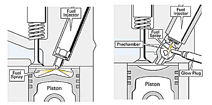

What is this 'cycling the plugs'? On all diesel engines in cars, tractor and boats I have dealt with you glow the engine for 20 - 30 seconds (max), and then start up. If it doesn't start you leave it a couple of minute, and have another go. In the cars there's generally a light that goes out when the glow plug is heated, and it's ready for cranking. Here's shown the difference between direct and indirect injection, also showing the glow plug:
Diesel - Direct and Indirect - V2.jpg Sorry for double-posting (though not very).

Dose anyone have a picture of a head from a diesel engine that has glow plugs looking at it from the pistons point of view. IE looking up from the block? We should see; intake and exhaust valves plus a fuel injector port or nozzle and the glow plug end with whatever pre combustion chamber is around it. I cant imagine this pre combustion chamber being very large as that would take away from the compression ratio.
Instead of a bowl in the piston and a flat head. There is a flat piston and a port in the head leading to a small bowl with the fuel injector and the glow plug. Direct vs indirect.
On modern cars (like to the left) the glow plug is more or less parallel to the injector.
