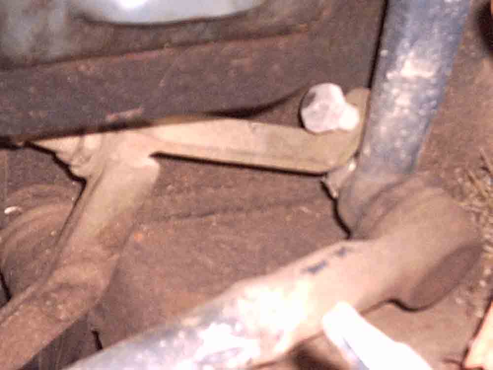

Ok, you can laugh all you want, but my little Kubota will only make right turns. Seriously. Here's my problem: when operating the tractor, any turn to the left will apparently disengage the clutch, thereby terminating any forward motion until the front wheels are brought back towards a straight position. It was a problem that was sporadic at best there for a while, but has gradually gotten worse over the past 3 months or so. I have checked visually under the tractor to see if the steering mechanism is in someway pushing on the clutch assembly, but cannot see anything obvious.
The tractor is about 15 years old and has never had a clutch replacement. It is stored under cover except when in use, which is about 4-6 hours each week. It is 4wd in case you were wondering. My thought is that the clutch is about worn out, but I am stumped as to why turning left would disengage the clutch like this. Or maybe it's not the clutch at all?
Oh, and one final tidbit, if I wedge my foot under the clutch pedal and pull up, I can make a deeper turn. Am I looking at a clutch replacement here for certain?

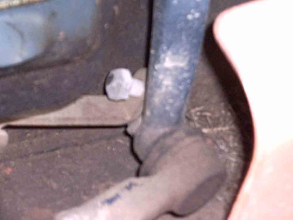

Well, I found the problem. It is so obvious, I feel somewhat embarassed that I missed it the first time I was checking.
I don't know rightly how best to describe it, but I will give it a shot and try to get some pictures of it tomorrow. When the steering wheel is turned to the left, the steering rod that goes toward the front left tire moves back under the tractor. When it gets to a certain point, it goes under the clutch mechanism and is riding under it. When it does, the clutch linkage moves up and over it about 1/4 of an inch, which disengages the clutch.
I can see where the steering rod has some wear to it where it rides under the clutch linkage, so it has been doing it for quite sometime. Should such a small movement in the linkage cause the clutch to disengage? Am I correct in my assumtion that a new clutch is in my future?
There are a few adjustment screws on the linkage, but making adjustments to them didn't solve the problem at all. Like I said, I'll try to take some pictures and post them tomorrow sometime for better clarification.

It sounds like your steering linkage is bent. Maybe you can bend it down a bit.
/ Is it the clutch? #12
Ditto what Jim said. Something is bent or the wrong parts have been installed at some time in the past. Either the steering linkage or the clutch linkage. Nothing should ever touch the steering linkage through it's normal range of movement and it certainly wasn't designed that way.

Here are a couple of picture of the problem. In this one, the steering wheel is turned to the left, and you can see that the nut on the back of the steering rod is beginning to ride under the clutch linkage. The edge of the clutch pedal is just visible in the lower right corner of the picture.
Needless to say, I've got some work to do to correct this problem. However, since this is not a primary tractor and I can get by with turning right, the repair job may have to wait until fall or winter.

another

Well, I finally got the time to tear down the tractor and find the problem. It was ultimately the clutch. The clutch plate was worn down so far that it had even begun to wear into the rivets. I'm in the process of putting everything back together now, so we'll see how the new clutch works.
As for why the steering mechanism was rubbing over the cluch linkage, the best I can figure is that it must have been bent some time back. We have plenty of ditches and holes that could cause a problem like that. I know that it couldn't have been incorrect parts or work because the only folks that have ever worked on it have been my uncle and myself, and I can't recall ever doing any steering work.
