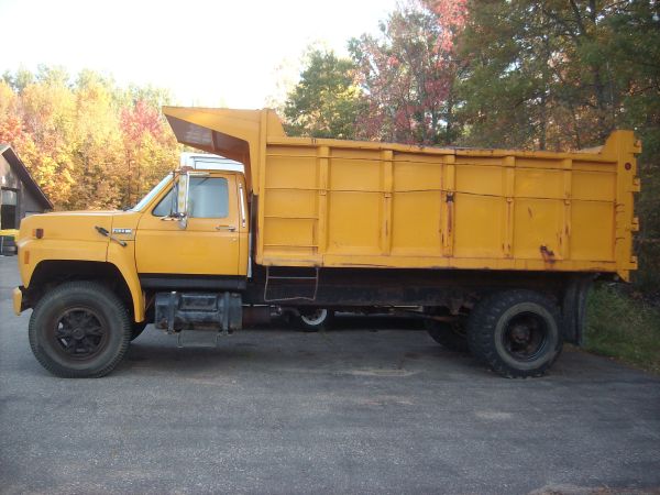

I have a Ford 550 backhoe and I am trying to dig my pond down as deep as I can get it...hopefully 30 or 35 foot. I want to keep the walls as steep as I can with one pathway out (perhaps 200 feet or more long). So far I have been using the front end loader to dig. Would it be better to use the back hoe to pull down dirt from the walls before scooping it up? I can usually get a full load with one or two strikes but the ground is heavy clay with large gravel and it is getting harder. I want the pond deep to give me stable temperature water to use for geothermal system in my future house. Any advise would be appreciated.
1) You will be LUCKY to keep a 45 degree slope in the water. Probably closer to 30 degrees over time.
2) Yes, dig with the hoe and make piles in convenient locations for the FEL to scoop out.
3) learn to strike the pile and while still going forward, raise and full curl the bucket. As the bucket fills, start going backwards. As you back, turn and simultaneously place the bucket at low transport height.
4) dump with the curl and back up as it's finishing dumping
5) Avoid spinning tires at the FEL load pile, those holes make you go slow
6) Keep the transport distance short. I'd buy a cheap used dump truck or flat bed with a dump function and load that.
here's the type of truck I'm thinking about. $3500
1986 F-700 Grain Truck
7) keep the transport path smooth so you can go as fast as possible
You may be money ahead to hire a medium size dozer to come out and starting from the center, push out the dirt 400 ft in all directions. You can probably get a guy on "a cash basis" to work 10 hours on a Saturday for 1000. Then you can make the center deeper if you desire.
