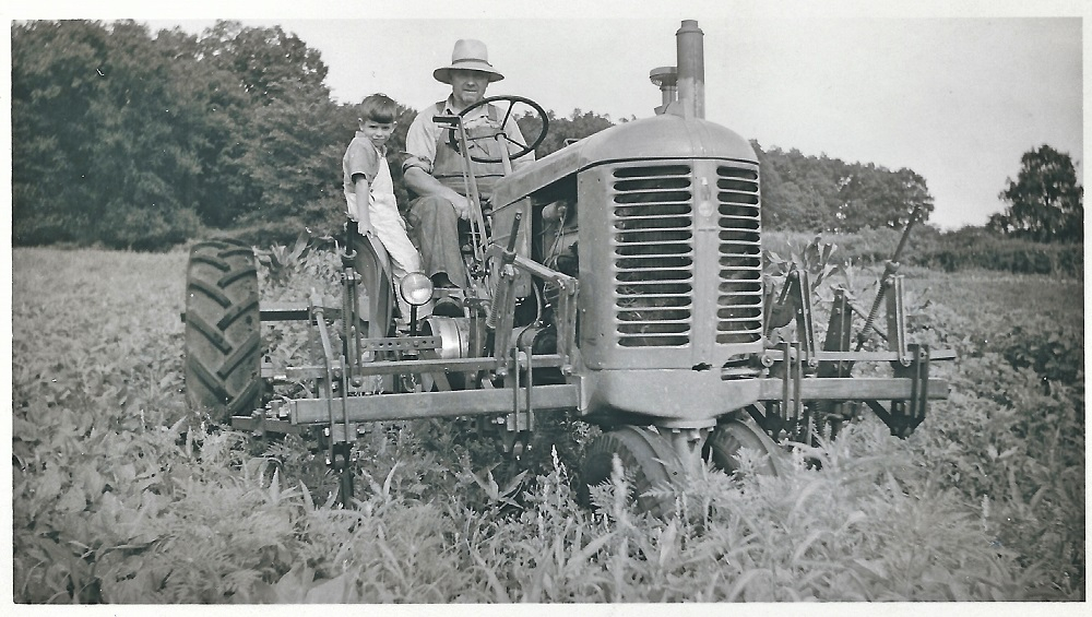

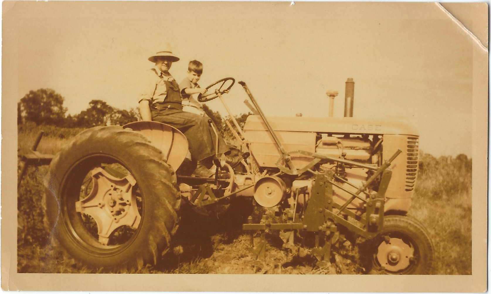

I speak from experience, this is me 76 years ago on grandpa's Case VAC:

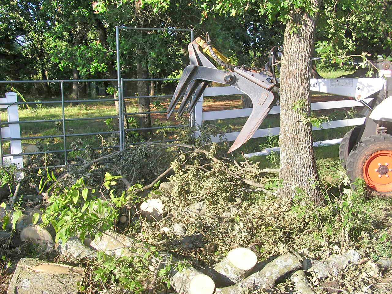

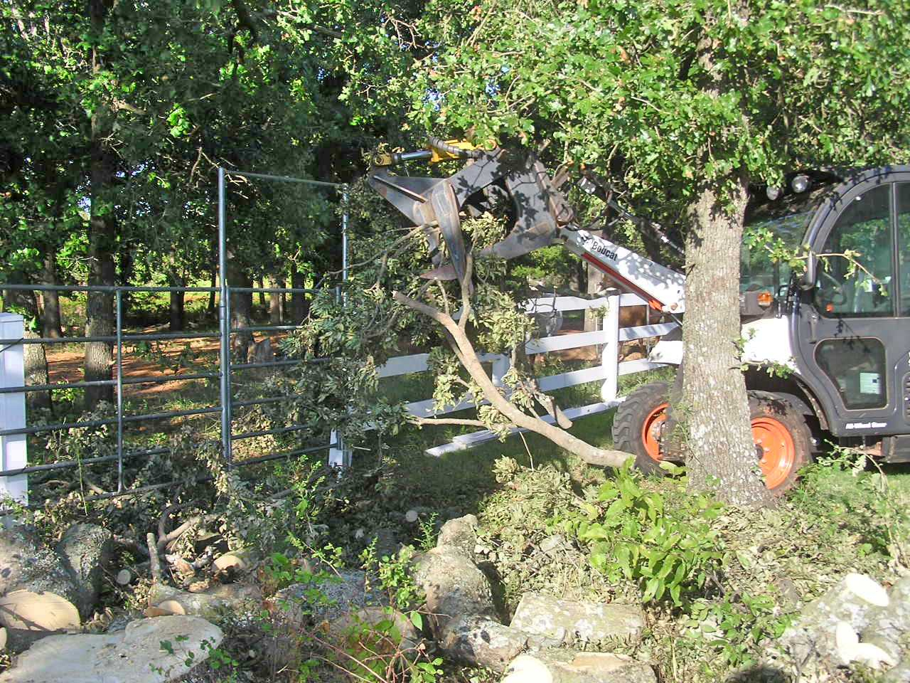

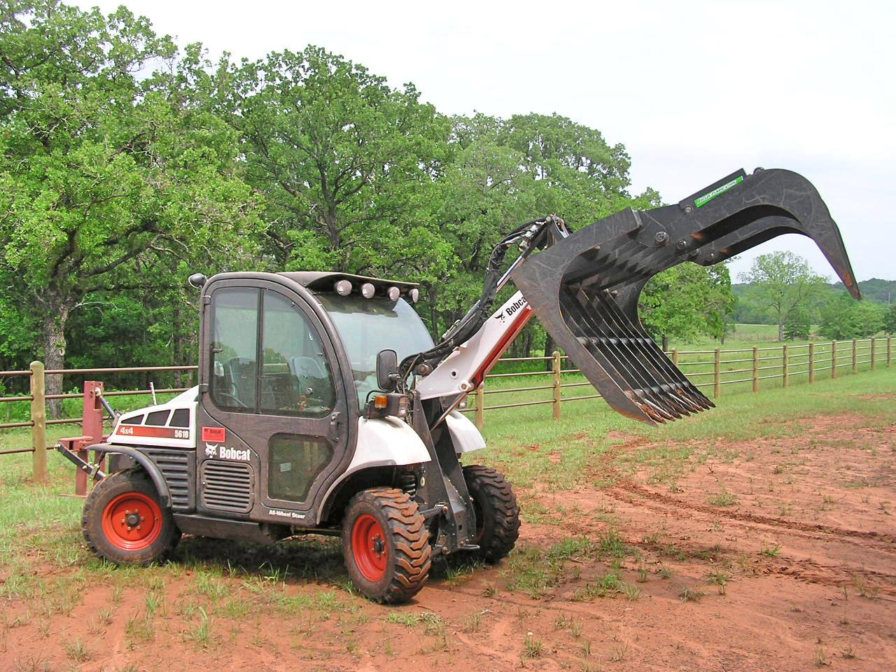

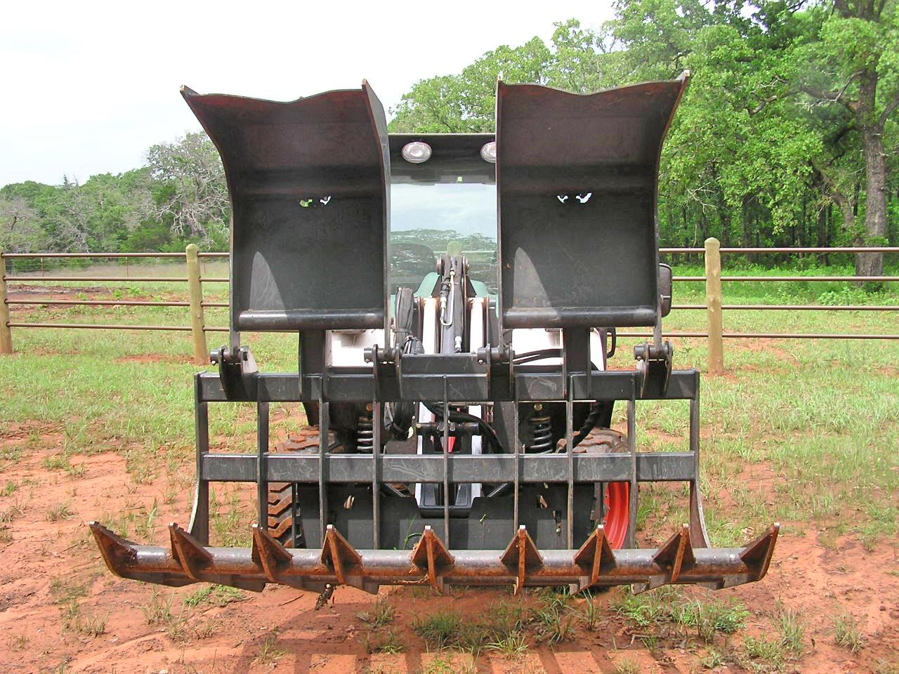

The very stable, not tippy, Toolcat with the Monster Grapple:

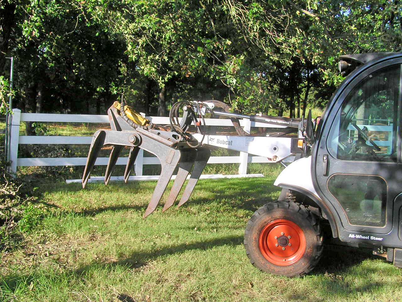

The Toolcat with a small grapple:

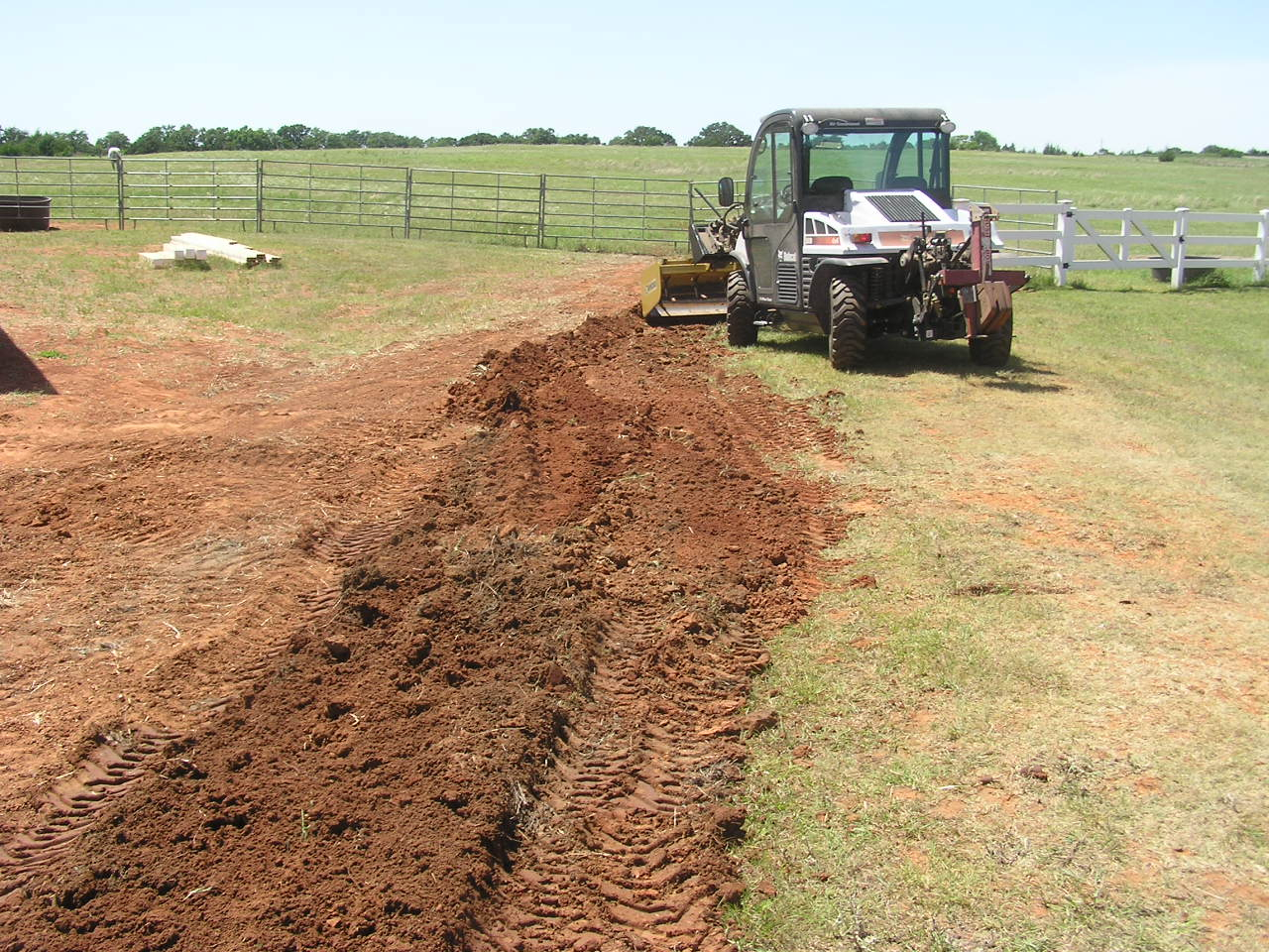

6' box blade on the front:

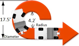

Some info on the Toolcat:
4 wheel steering:

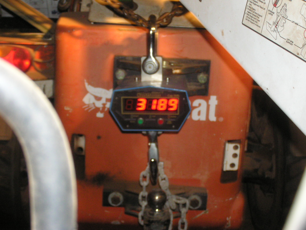

Lift maxed out at 3,189 pounds with the engine idling.

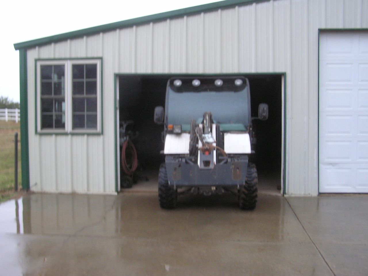

There are many comments about not using a cab tractor in the woods, but those tractors won't fit through a 7' high overhead door like the Toolcat does:
